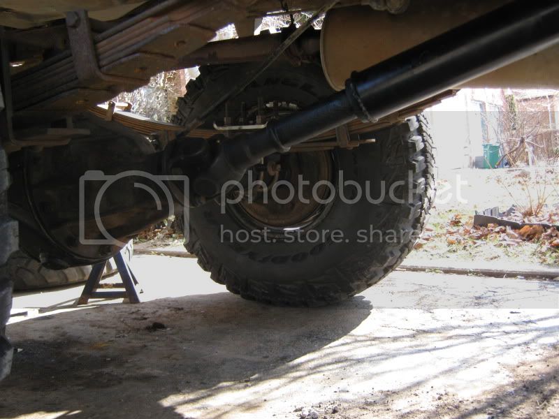

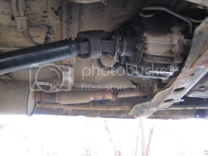

heres some pics of the rear drive shaft i had made.
the slip yoke is from a from land cruiser drive shaft.
the cv joint is from a 85 solid axle 4runner.
the shaft was extended to 38in (end to end)
and the tcase flange was drilled to match the 4runner flange pattern.

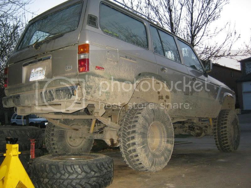

so i had to go to the closet trail to make sure nothing would break, and get a feel for the `new`suspension to work out the bugs.
so the details:
truck is slow as hell. i was getting to 90kmph downhill.
lspv is seized :s
truck handled great offroad. just need to re-align the steering rack.

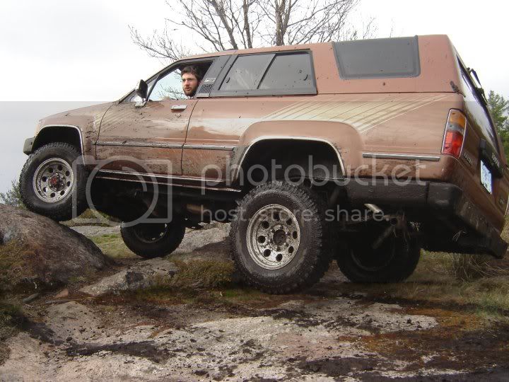

gotta share these from last weekend
my buddys new stock 4runner
Don't you love the offroad performance of a SOA 60? Incredible.
yea, im really happy i can go over bigger obstacles, just got to get more fimilar with the tipping angle. more practice this weekend :D :D :D
truck's looking mean ! loved watching the articulation on the trail ! thought my truck was a street car after watching your clearance on the trail this weekend !!! so jealous .
