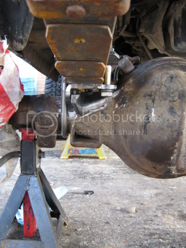

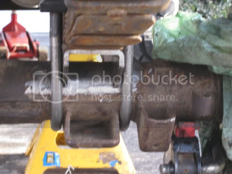

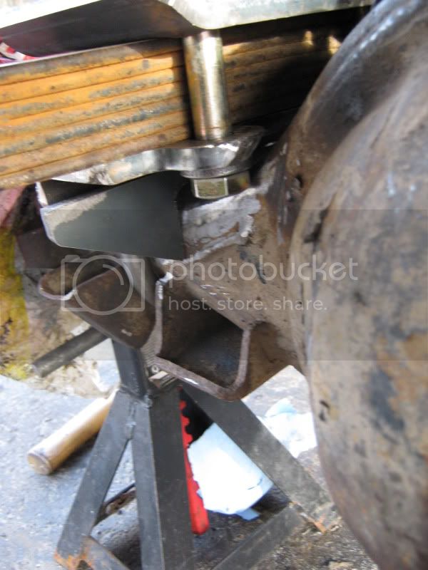

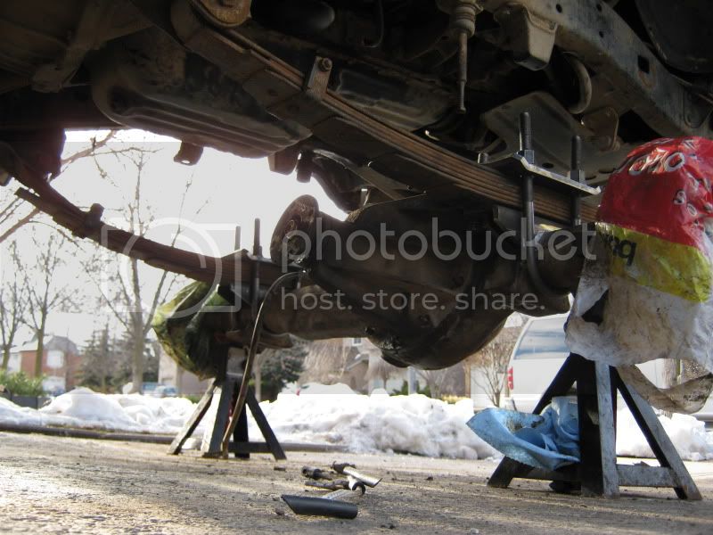

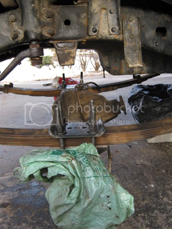

here are more pics of after i grinded down the diff perch and stretched the ubolts.
now im having problem with the front side bolt on the perch hitting the diff plate...
pic:
NO|T|HING IS SET YET:
the easy side looking good

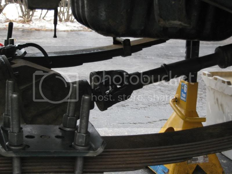

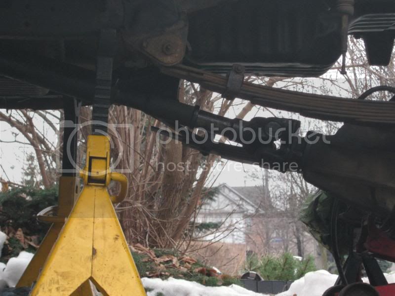

i will have to get a custom front driveshaft made for extreme andgles since the ds binds on full droop

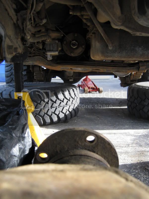

full weight of the truck on the axle(yellow stands arent touching.)

If you don't want to have one made I'm pretty sure you can clearance a good amount on a stock land cruiser driveshaft and it would be fine. With the 62 axle though it looks like your pinion is pretty darn close to being dead on as it is.
well with full truck supported and axles and springs hanging i feel a bind on the stock ds.
i can run the stock drive shaft as long as i dont go crazy offroading. it is winter atm and i dont see myself doing any crazy flex which will give me some time to get something rigged up for the spring.

my pinion angle might look good but its the transfer flange angle that not so great. it is fine for not maximum articulation/ level driving. i will take a pic next itme im under there.
my drive shaft is a stock fj62 one it dont know what you call it. it is a 2 ujoint drive shaft

Sweet. If its tight I would just take a dremel or dye grinder to it and clearance it for now a little just to be safe. Just take a little out of the flang side of the ddriveshaft where it binds.
thats exactly what i was thinking, i also have spare driveshafts with flanges if need be.
i do understand that it might weaken the drive shaft assembly by grinding the flange down, *use at your own risk*

Those are some dirty hubs in the picture at the end of post number seventeen. How did you get so much grit or mud in there?
the wheel bearing were shot, and it let crap in through between the rotor and spindle and just filled up. i did a lot of off roading this summer and fall so i not too suprised.
it took hours to clean the hubs up, but a good learning experience
The first time I took my hubs apart completely it took me a good two hours to figure out how they worked and how to reasemble them. Now that I have done it I feel confident that I could do it in the dark on a trail somewhere should I ever need to.
FWIW...I used the stock 62 DS when I did my SOA and IIRC, I did feel a little bind. I clearanced around the u joint and I NEVER had any issues with it. Consider this (cuz i was a bit sketched too...) youll "ALMOST" never run into a situation where the front axle will be un supported. One tire or the other will be on the ground unless your jumping the rig. I suspect THAT is the scenario youre running into while DOING the SOA, BOTH tires off the ground, fully drooped?
Try it out. Either that, cruiser parts sell DC shafts for like 200 bucks....Just another option. May have to get the shaft re sized though...

Seems that IF the cut away on that perch plate FITS the housing, you could have rotated the housing to the desired position, scribed a line on the perch plate at the angle you wanted from the TOP?

im not 100% im following you, but the cut-away part you are refering to required major grinding, i set the pinion angle by eye, witht the full weight of the truck on the axle, pointing straight at the tcase, then i tacked the perches. and removed axle to prep for the cnt.
ill try to post some pics in the next couple days of how the perch sits.

The spring perch problem is not a new problem for Ruff Stuff. I had the same problem and worked with them to make some changes to the design. The front hole on both the perch and plate need to be moved forward to account for the turning of the housing since there are a lot of variations in suspension setups and drive train. Weak-link had the same problems. He eventually made a new design for me but it appears you got some of the older design stuff.
if youve gone this far, you should know how to make things work, thats what we did.

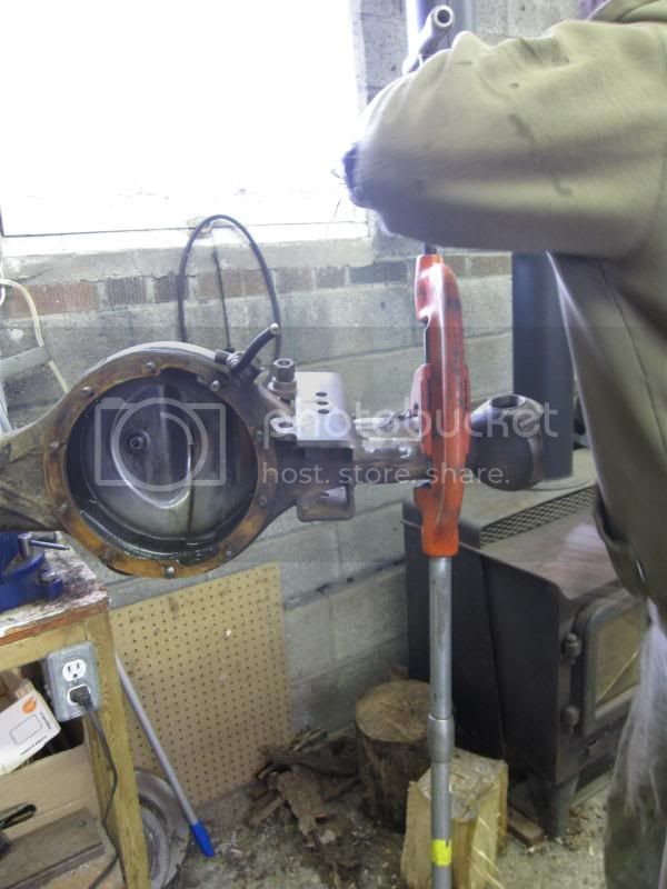

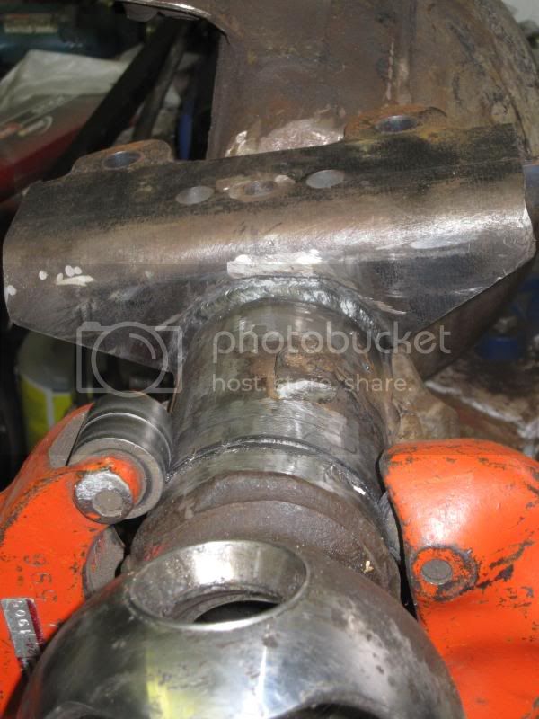

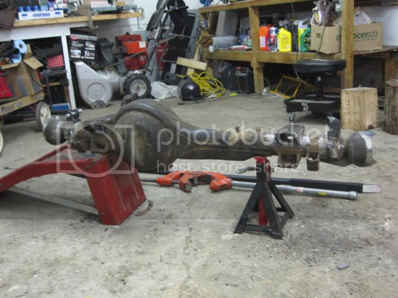

here the progress report:

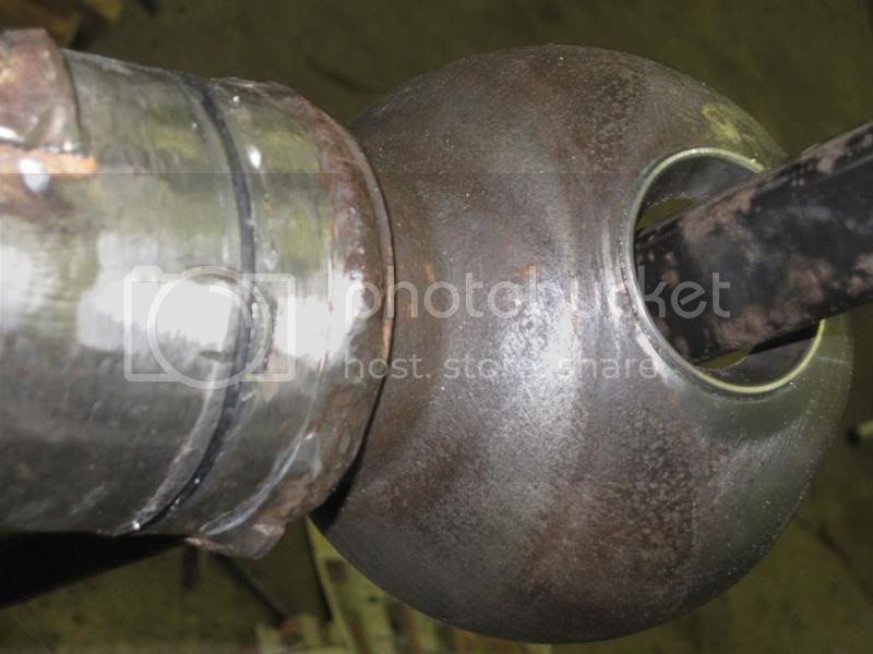

cut and turn:

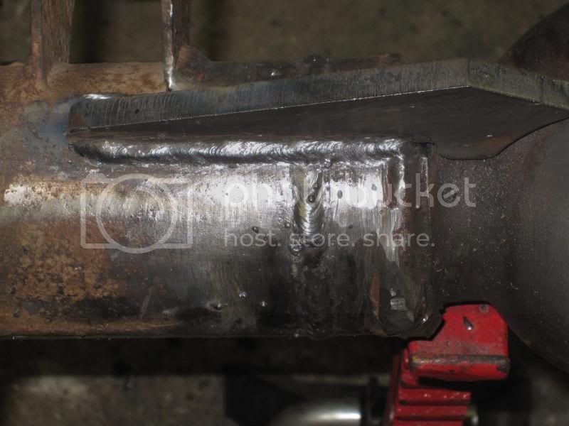

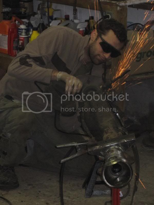

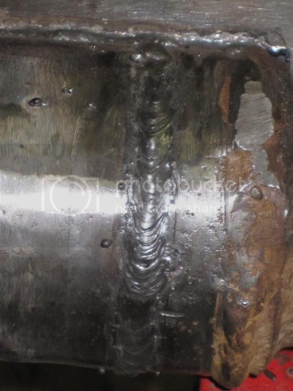

i ended not grinding the factory weld at the end of the housing and used a 2-4inch pipe cutting wrench tool. the cut was 30mm from the edge of the housing. leaving only 5-7mm at the inner knuck tube. both knuckles popped off the housing which kinda worried me, but they were back in smooth and straight. we tacked 4 spots and welded the cut shut. 3 extra bead were then burned on for re-enforment. the knuckles were dialed back 1/4inch.

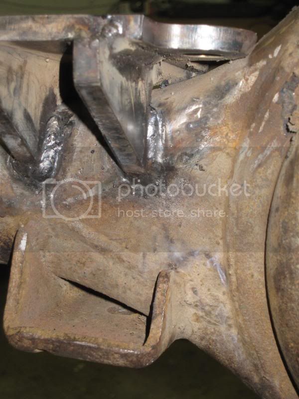

next the perches were welded, then re-enforced with 2 beads each. then a marlin gusset for each under side. then the ruff stuff shock mounts and finaly the steer stops. took us this weekend. thank you Scotty for welding!!
simon:
scotty:
