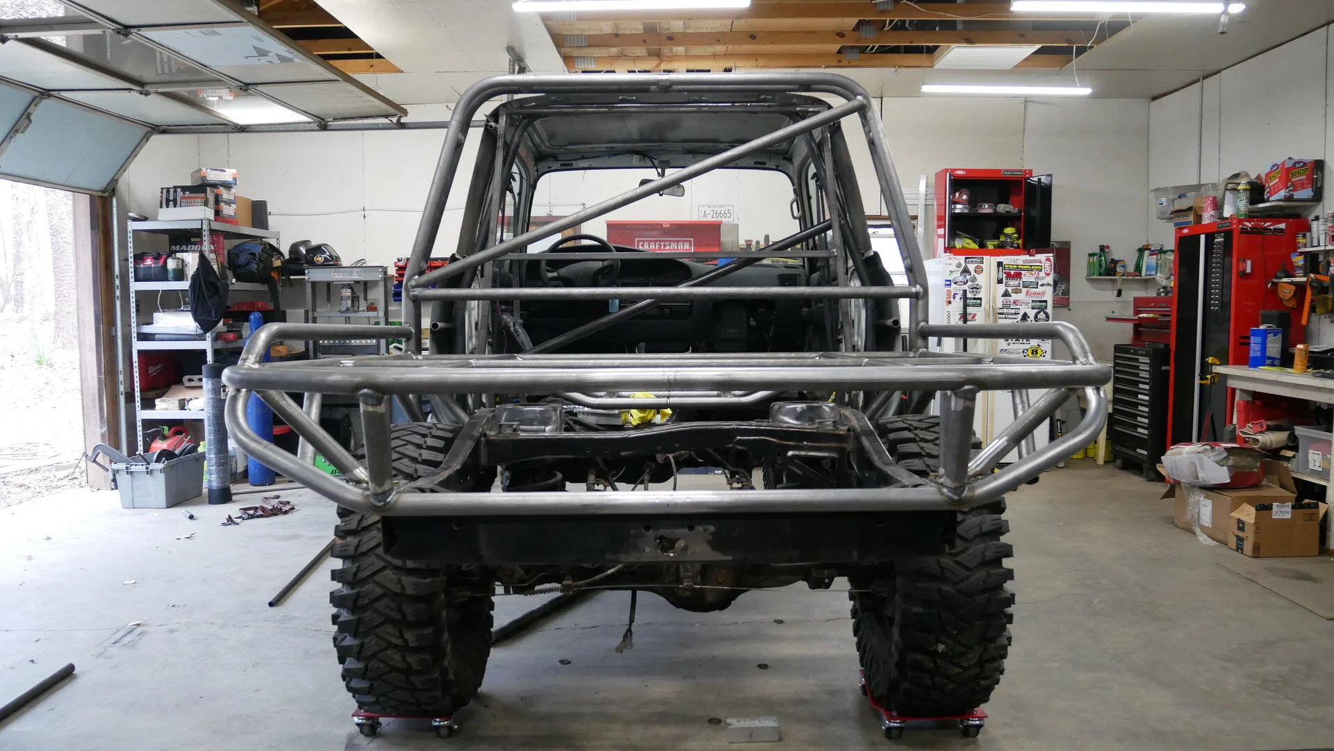

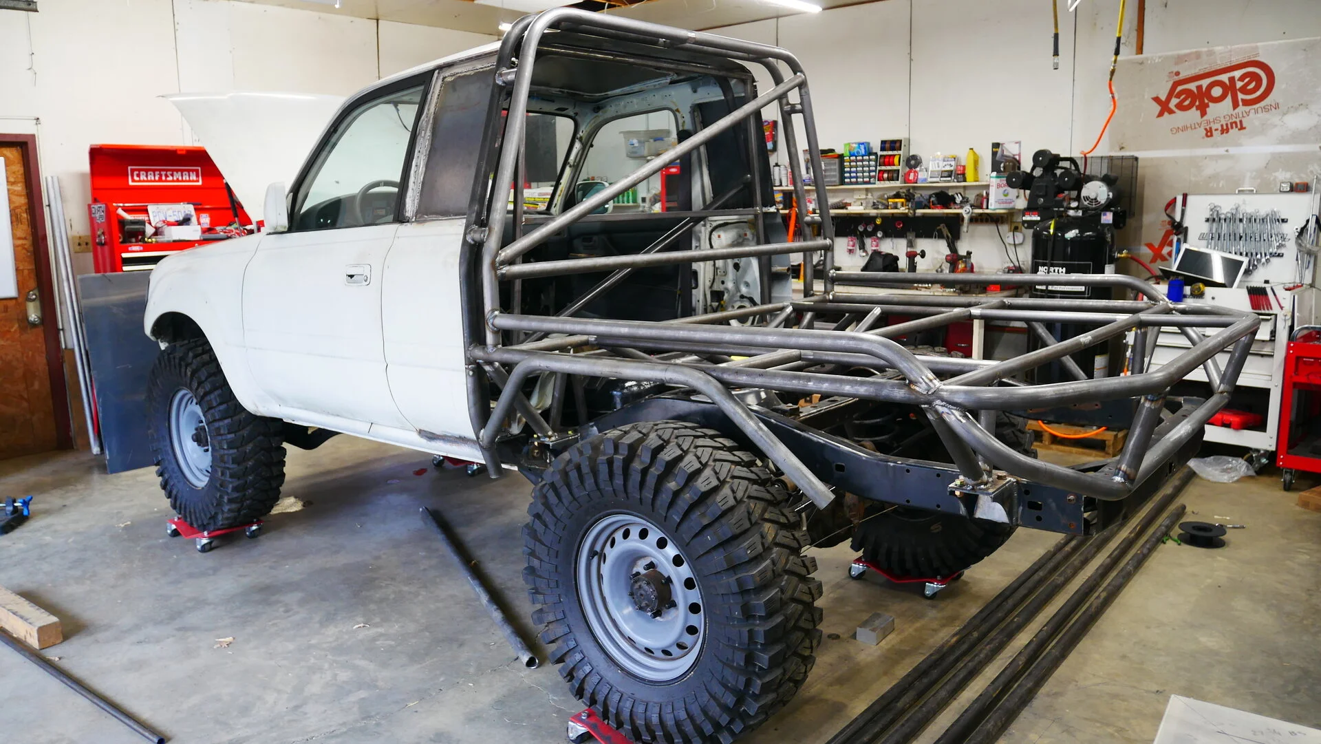

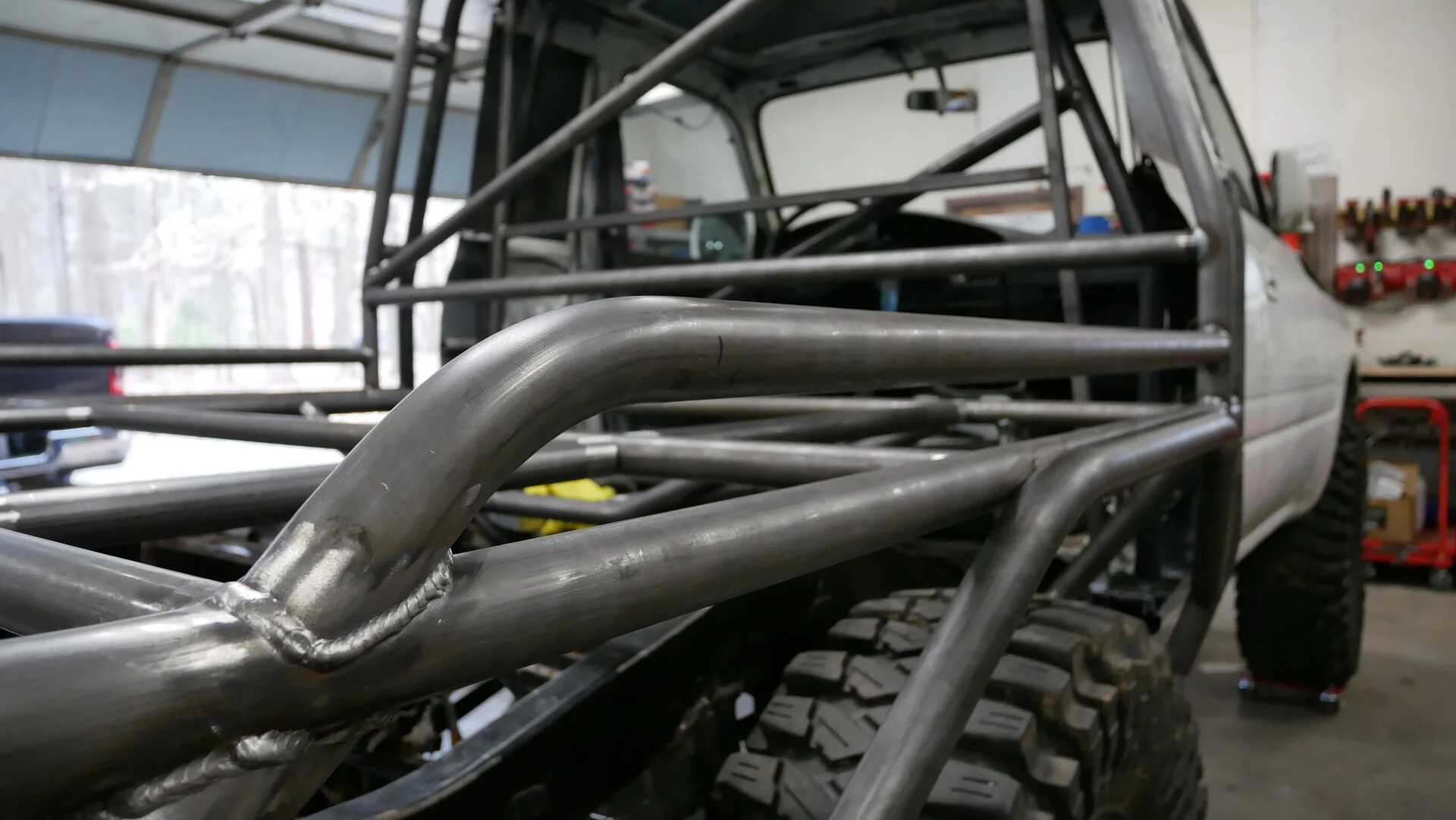

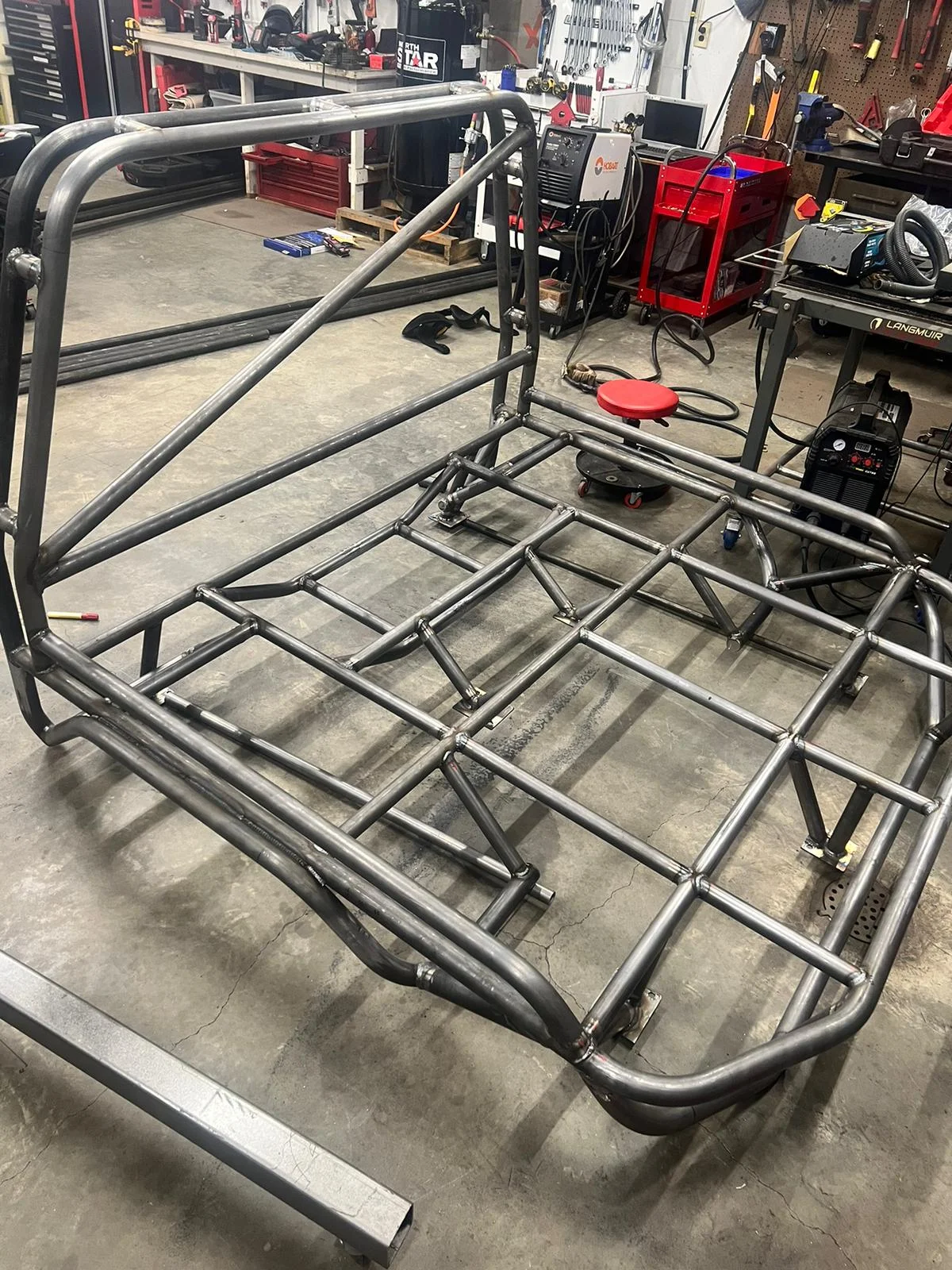

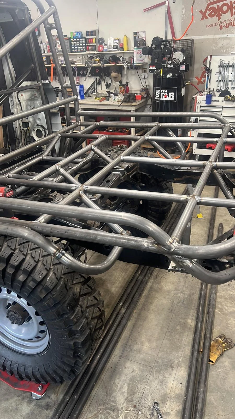

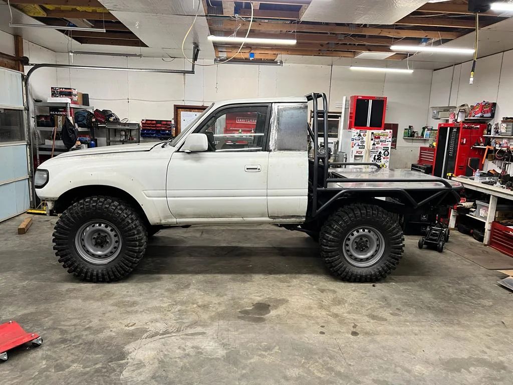

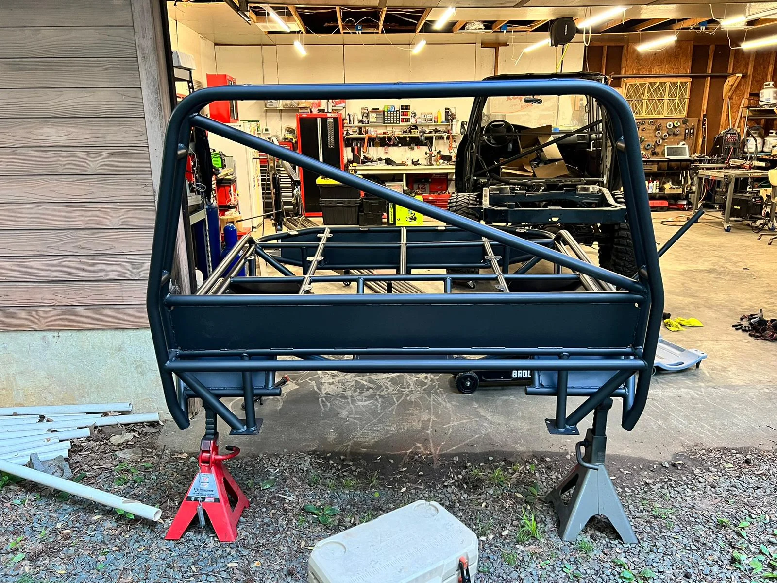

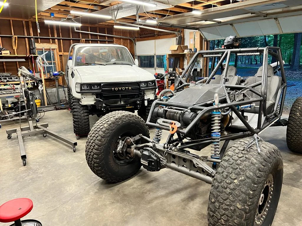

Went over to @NCTrey133 for the last time before heading out. He was in the middle of doing his real life adult job but found a moment to chat with me about the rest of the design. We are both excited about the tray and how it's turned out (I told him I not really the type that gets excited about things, but this has tickles my fancy). These are the last pics that'll actually be taken by me for a while.

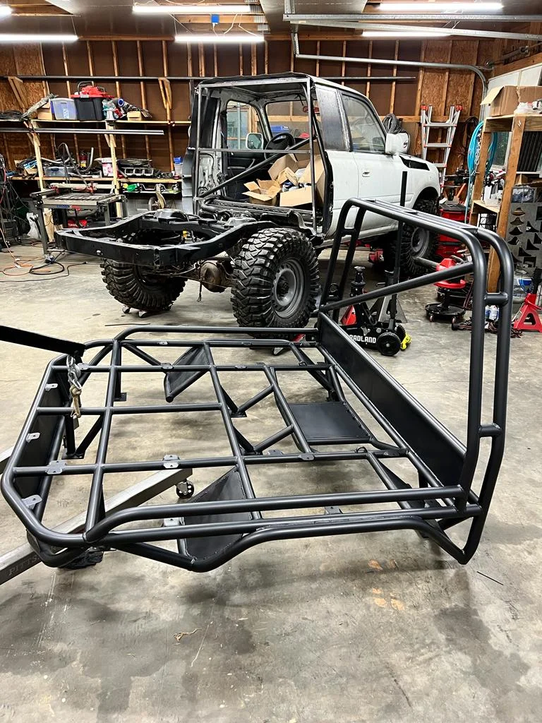

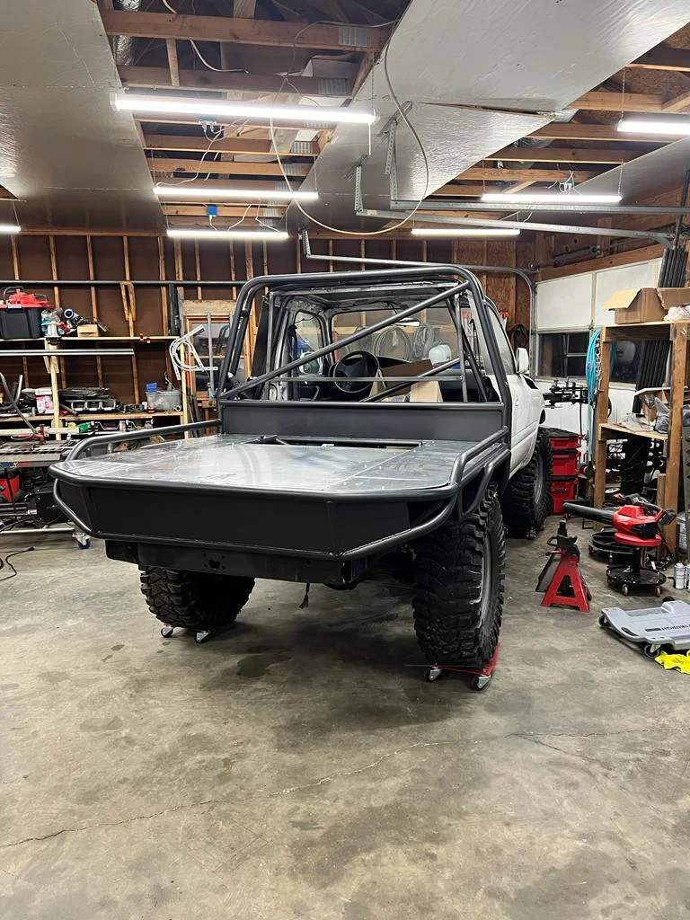

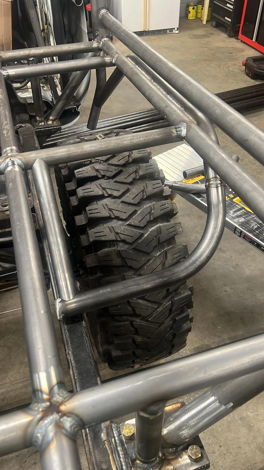

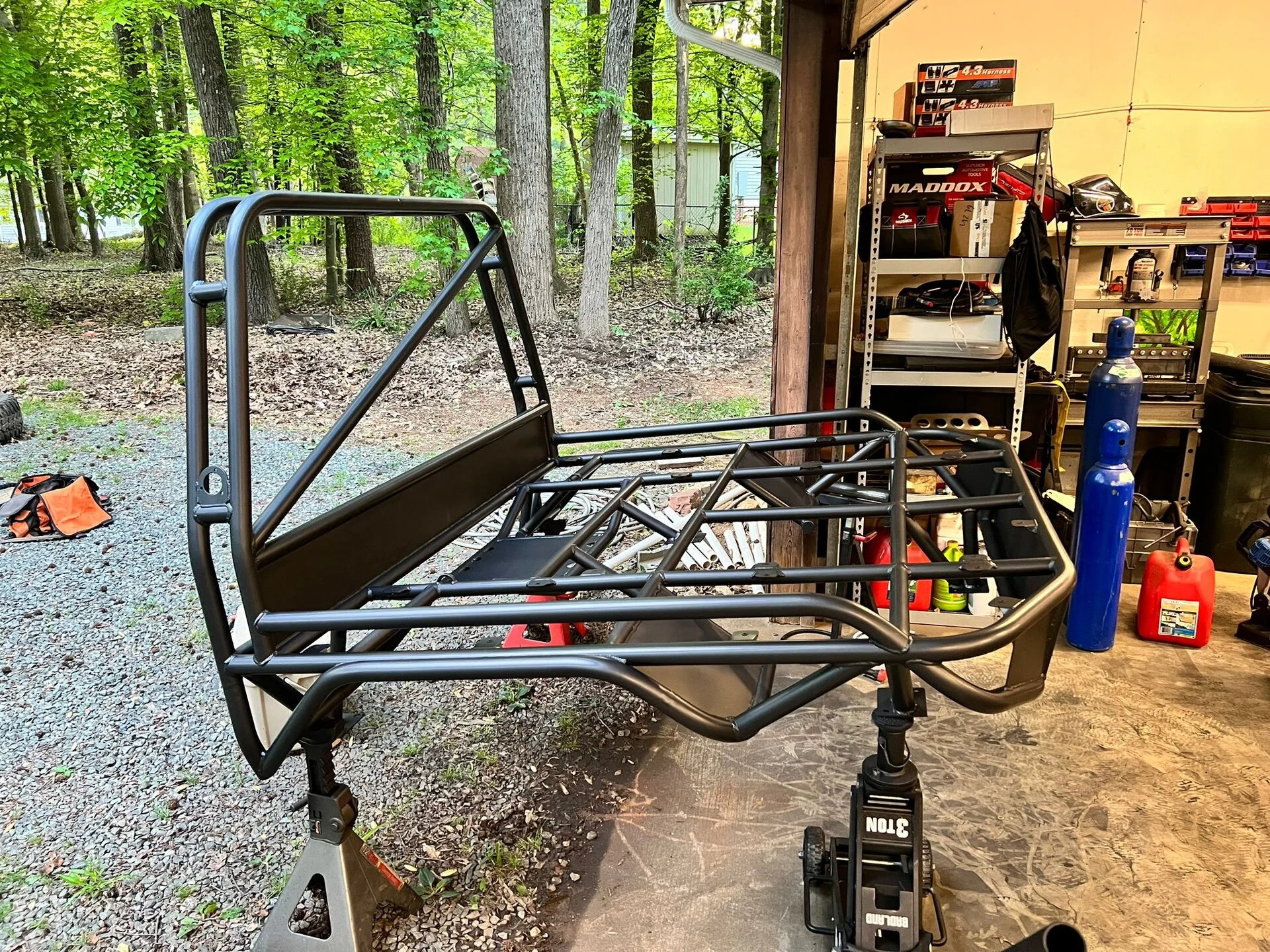

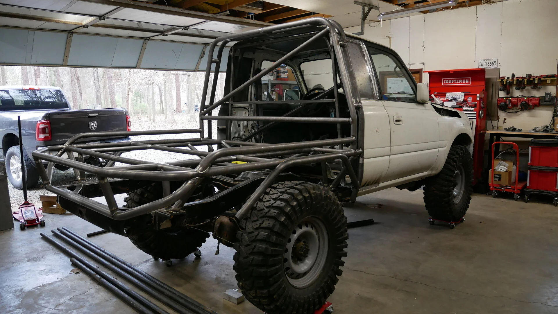

What's the purpose of the lowered section in the tray/bed just forward of the rear axle?
For the spare? Mounted upright against the front of the bed?
Ah that's what your referring to. . Yes for the spare.
@NCTrey133 has been keeping me updated on the tray and it's at the final stages.

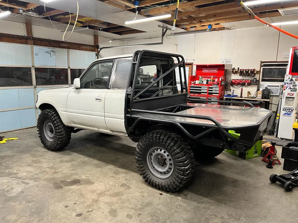

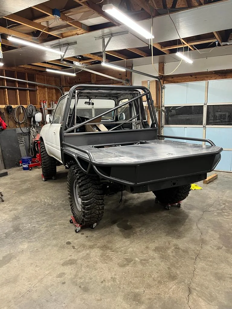

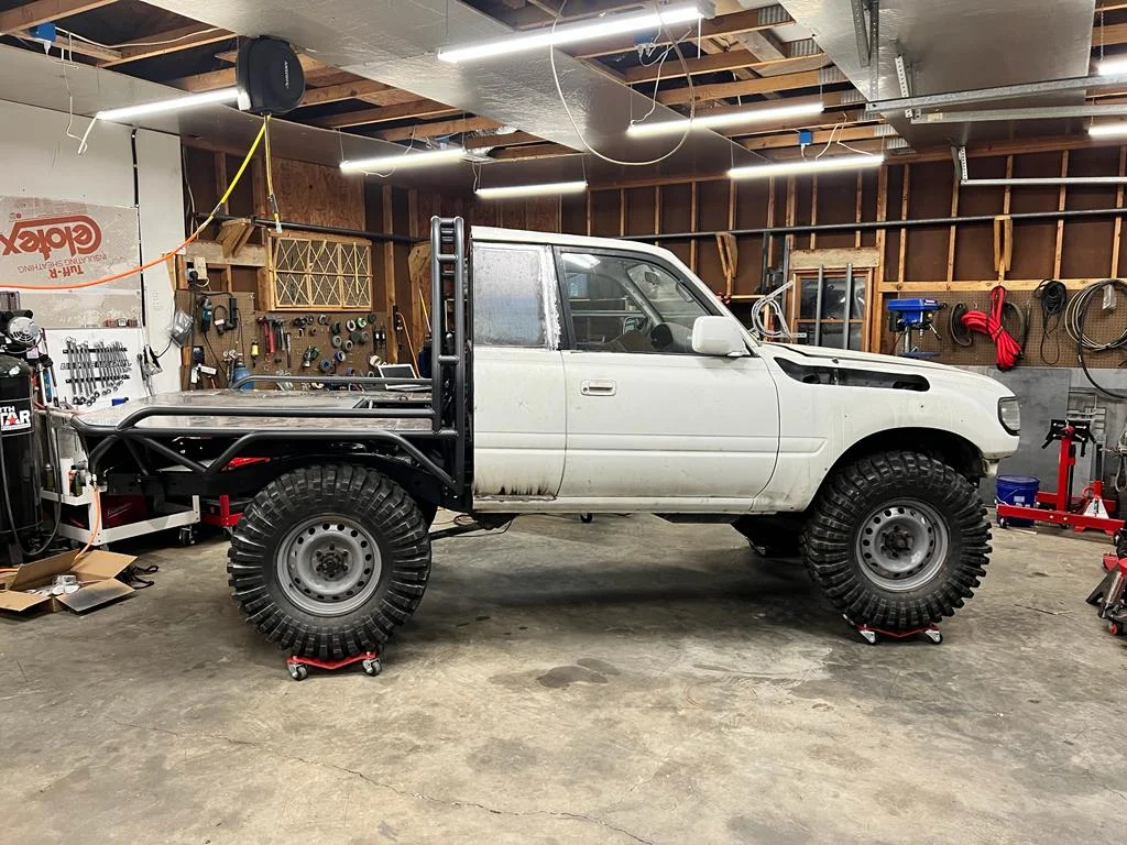

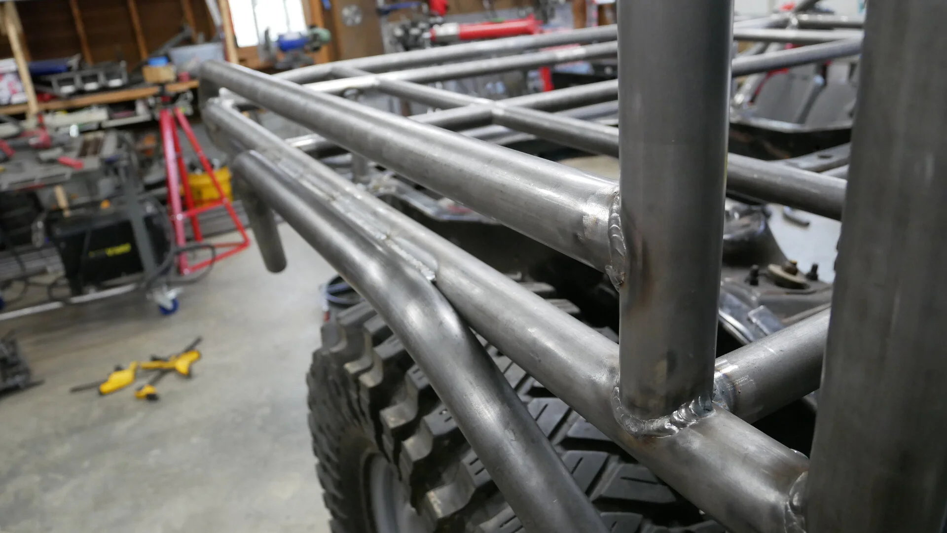

Last weekend @NCTrey133 finished up the tray and delivered it back to @fourtrax to wait for the next part of the build.
When I return from Africa I'll add black rubber gym flooring to the bed of the tray.
Though @NCTrey133 says he was glad and it was an honor to build this tray, I'm sure he's glad for the tuck to be out his garage so he can finish his buggy build.

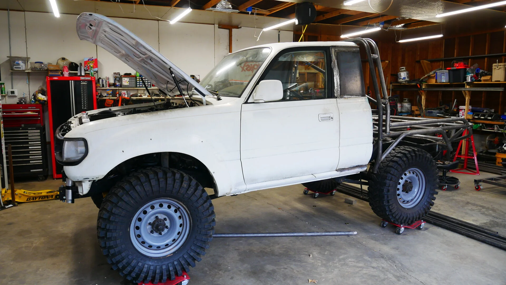

FINALLY!! We put some hands on this weekend.

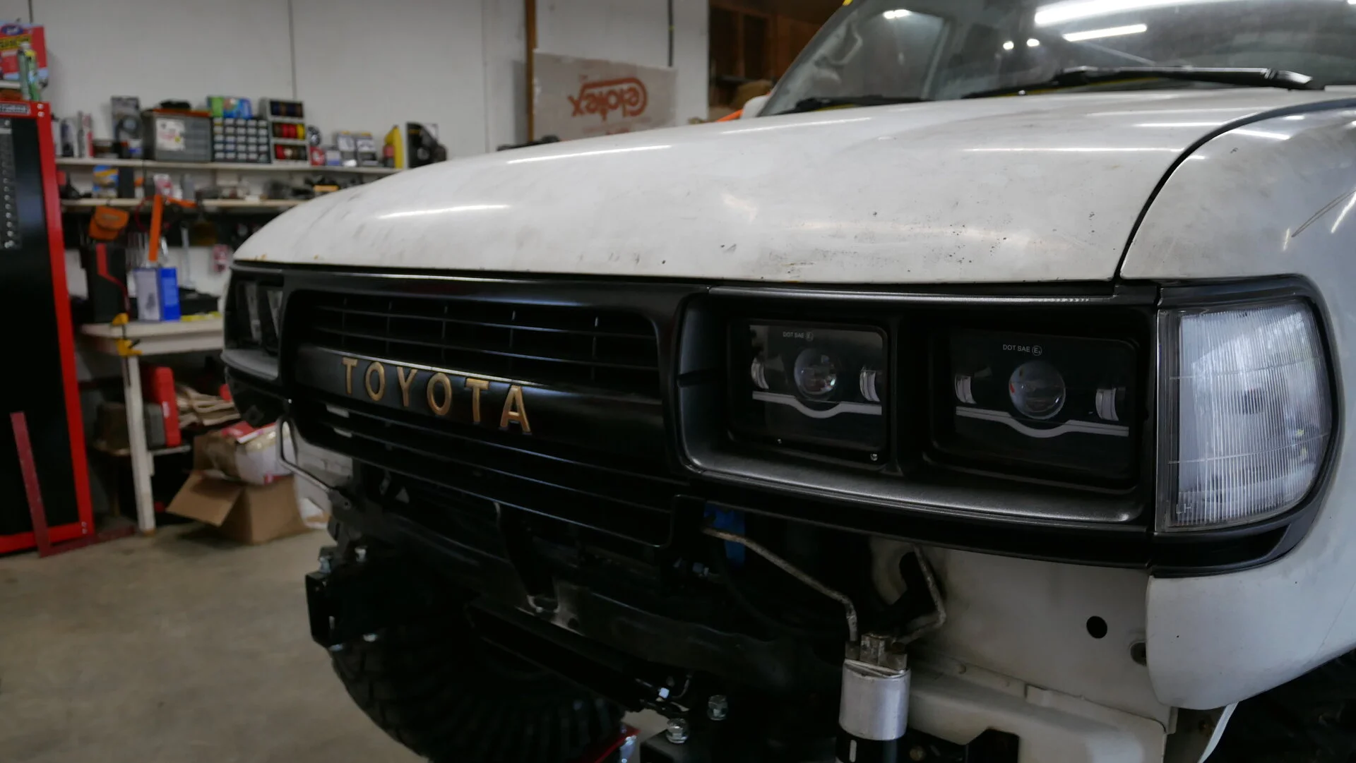

A/C (in theory) is complete. Recently found a front valance that wasn't bent to s***, so I threw that on since the front should be finish.
Starting to mockup the rear of the LC. Needed to purchase a 4 3/8" hole saw to install the taillights and blinkers.

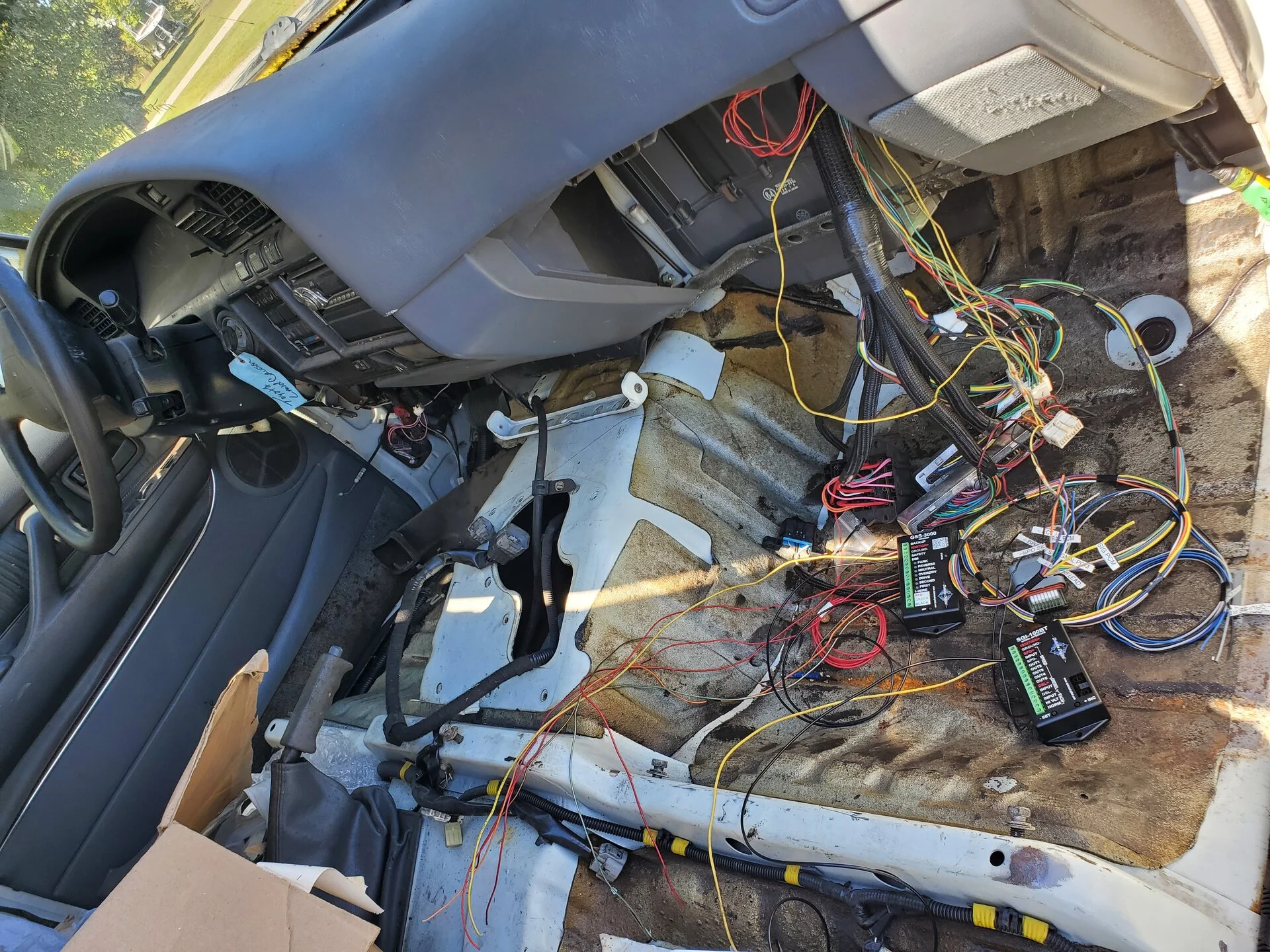

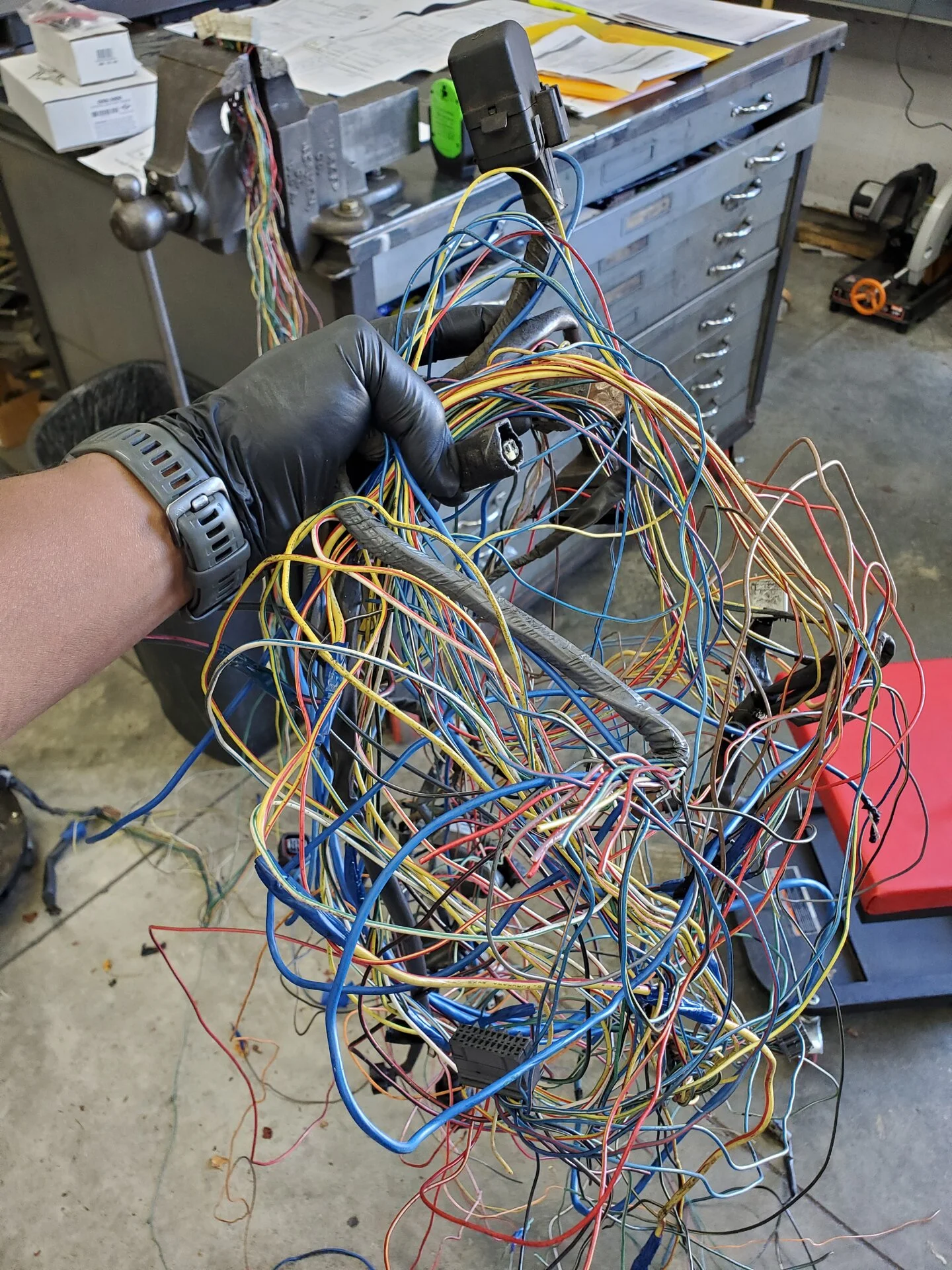

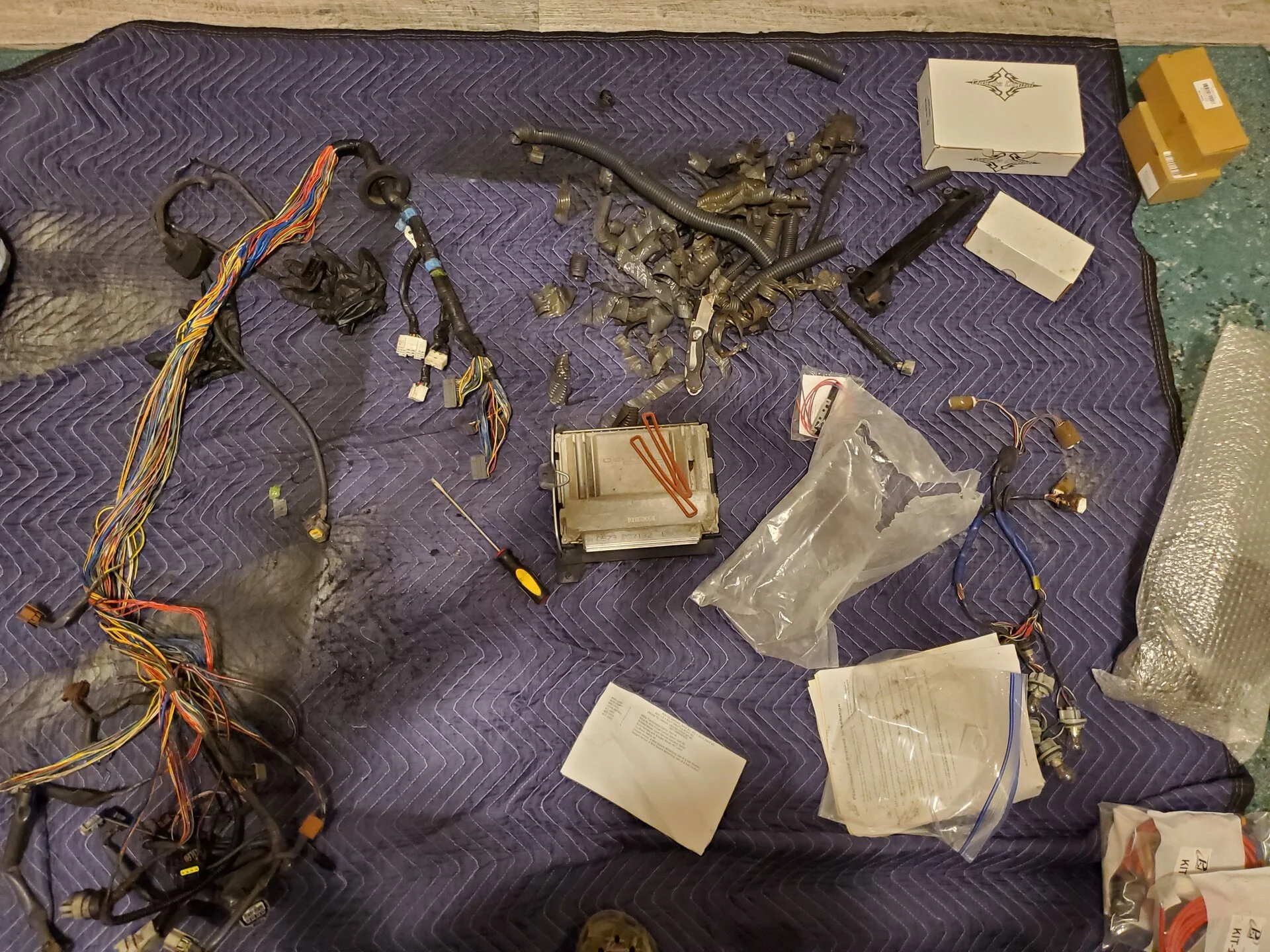

And now what we've all been waiting for. . .I took the LC wiring harness home and started stripping. . .filthy mess.
Went back to @fourtrax house the following day needed adult supervision prior to cutting wires.
Due to my inability to read and comprehend, @fourtrax did the heavy lifting of connecting wires to other wires. @TLC94LS has a great video that helps with what wires connect to where.
Put some hands on the Ol' Crusier this weekend. It rained Saturday, so didnt get everything I planned finished. Nothing really picture worthy, but put the taillights and blinkers are on the tray, and both Dakota Digital boxes are wired in to the body harnesses. Fuel wires spliced, but still need to run it to the PSI wiring relay. I've been mostly following the way @TLC94LS did his, with minor differences because I'm using a stand-alone harness from PSI. I'm thinking I'll take pictures of everything, label, and post to assist folks like me that hate/can't read but understand once they see the picture.
