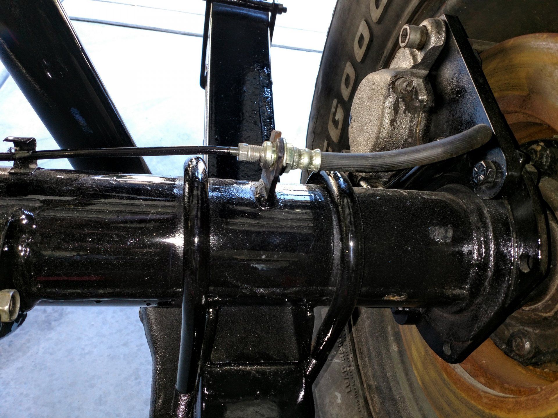

I stopped by the body shop last week and they are currently replacing the floors in the LV. At home I removed the rear brake lines, cut the brackets off that were between the U bolts and made some new ones to go behind the axle. New U bolts and the original bump stops are installed. Now I just need to get new hard lines made as the list on my end gets smaller and smaller.
Thank you for the compliment. I agree it's all in the details (I even did reverse twists on the brackets). I didn't realize what an opportunity I was given having my chassis at home while the body work was being done. I'm sure the body is still months out so I should have plenty of time to finish up.
Oh, snap with all that gloss couldn't tell. Bolted into the axle perch. Great.

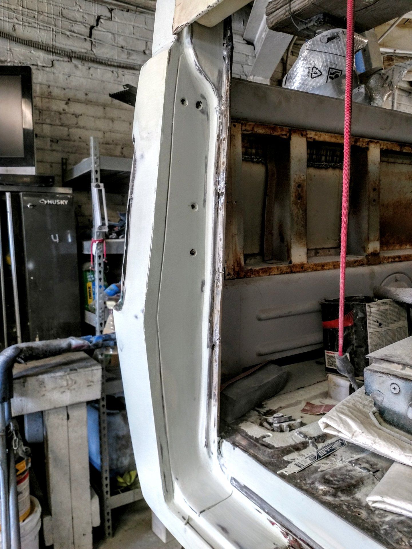

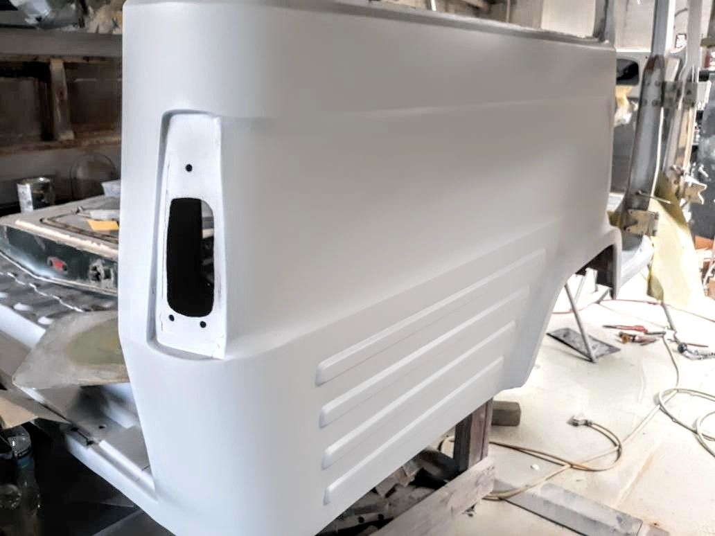

I haven't been in for a few weeks but the body shop sent some recent pics. Floors are in, doors are done and 95 % of the body work is complete. So far I love all of the work I've seen. These guys do amazing work.
It will be good. :)
