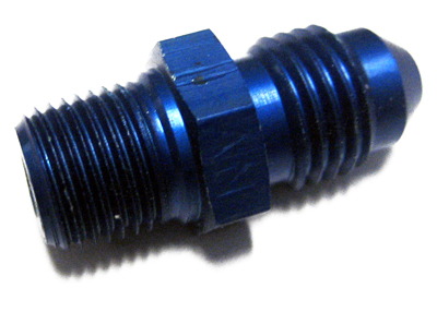

yeah I got them for the York. Thats the pic up top. The fittings on bottom are the same without the ferules. I wont claim to know the differences/similarities between AN and JIC. I just brought the stuff in and they grabbed at stuff in a drawer :P

I am trying to find adapters that will screw on to the AN fittings on the York and adapt them to NPT fittings. I have found a hydraulics place in town that seems to have the AN to NPT adapters I want, but they don't have any of those ferrules which I believe are needed to seal properly. Are those ferrules available separately? If not I may just end up going with the Kilby flanges and getting a gasket kit at the same time. :meh:

Knowing next to nothing about fittings and such, is it possible that they are a JIC fitting and not the AN variety? Wikipedia says they can work together but it's not the best idea. JIC is apparently the industrial version of AN (military, from Airforce-Navy), so would it not be more likely to be JIC in this application? I guess my main question would really be does it matter? Have you tried your fittings on your York?
It is my understanding, after asking someone "in the know" that JIC and AN are the EXACT same thing, except JIC is steel and AN is aluminum.
Acually, AN is the same as JIC but is the part number designated for aircraft. I've been using these fittings for 23 years (Air Force calibration technician) & thought my civilian friend was crazy when he called them JIC. You can get AN in Steel, Stainless, Aluminum and Brass. I've mixed & matched JIC and AN fittings numerous times without a problem. I typically use the Stainless ones up to ~10,000 PSI and aluminum around 500 PSI. Aluminum and Brass seal better if the flared tube has any defects, Otherwise stainless is the way to go. You should only have to tighten the fitting ~ 1/8 of a turn after the mating surface contact is made. Over tightening will distort the fitting.
