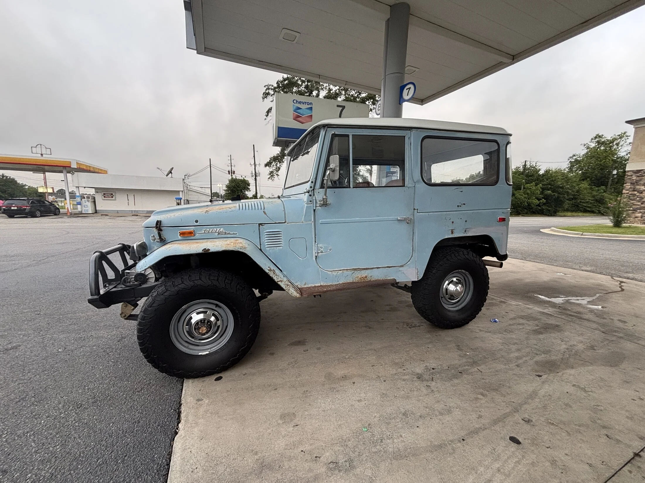

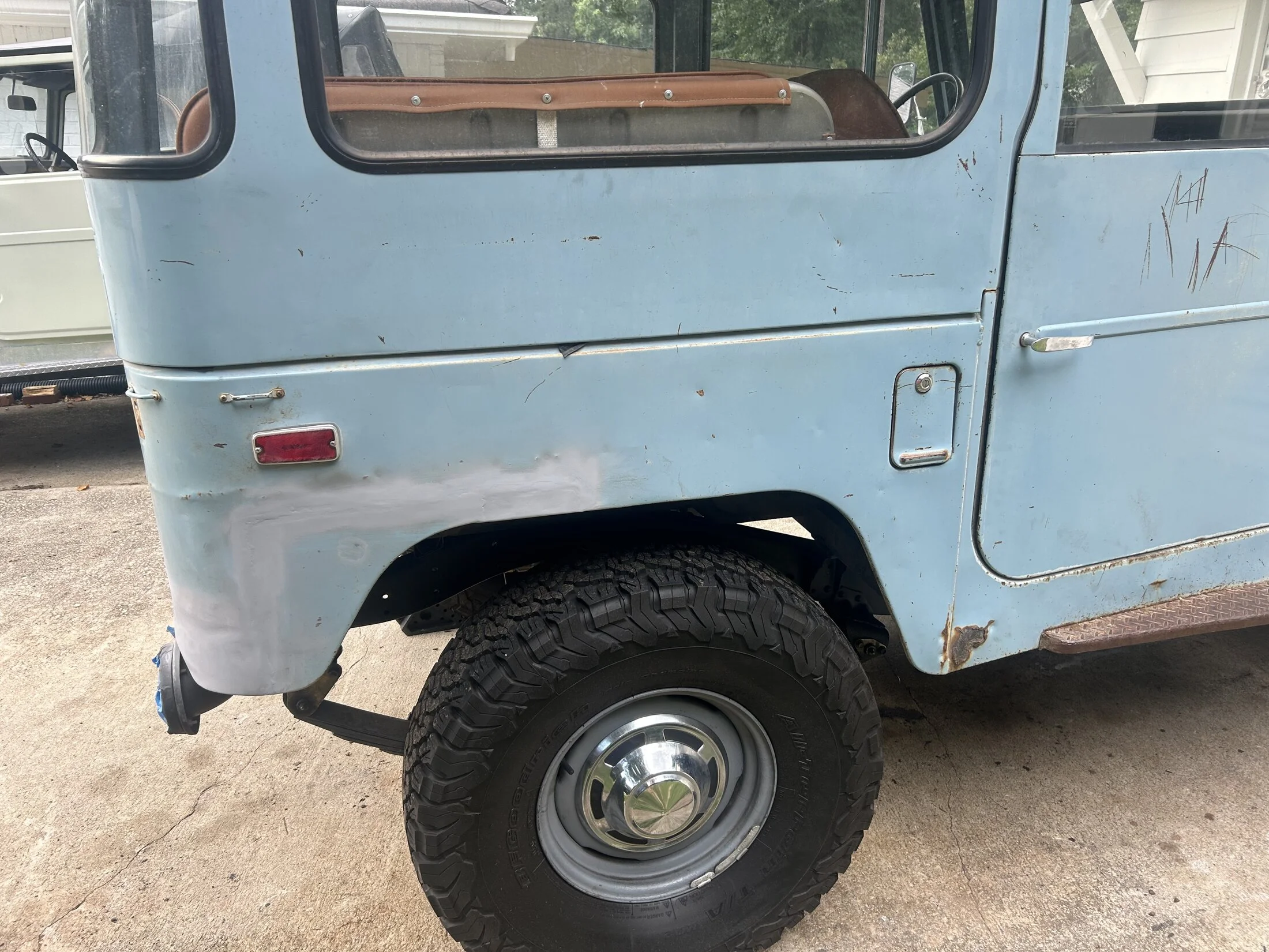

A few more pics. Hope to finish the passenger rocker tomorrow and be done!
Here is the thread I made where I explain the sill replacement in much more detail. Thanks @jesus888 for letting me work on Old Blue Eyes!

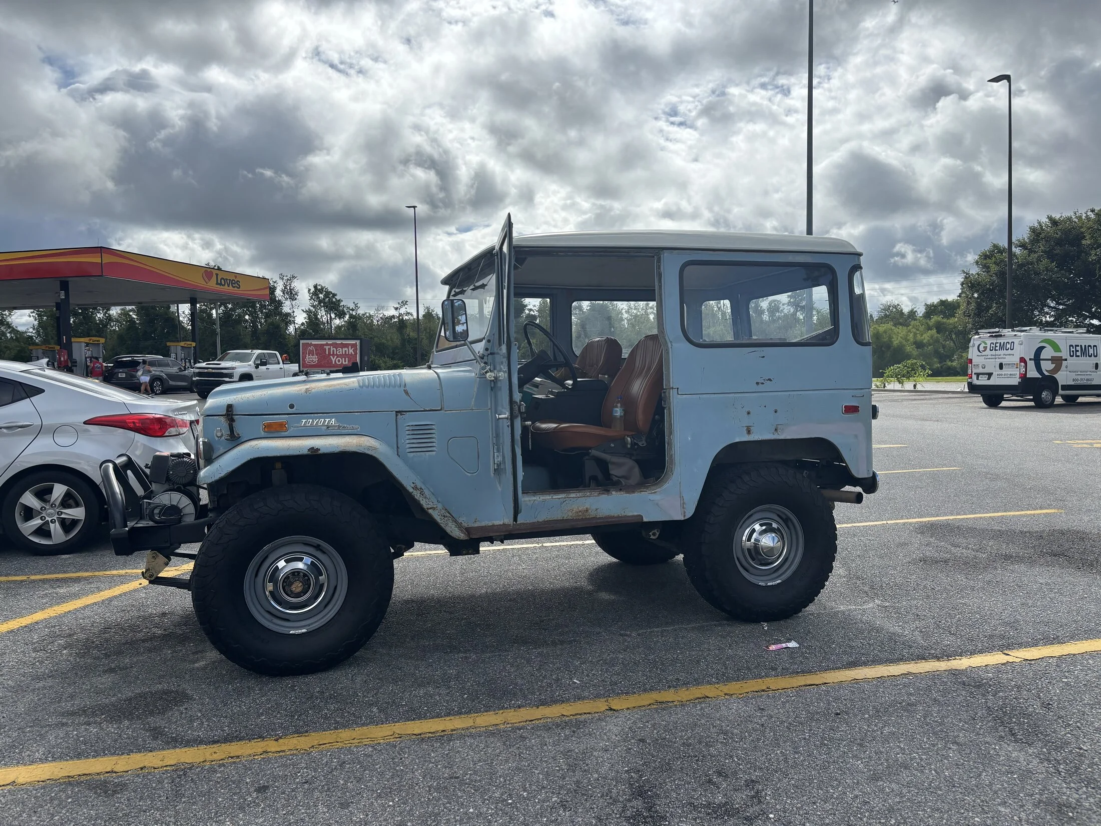

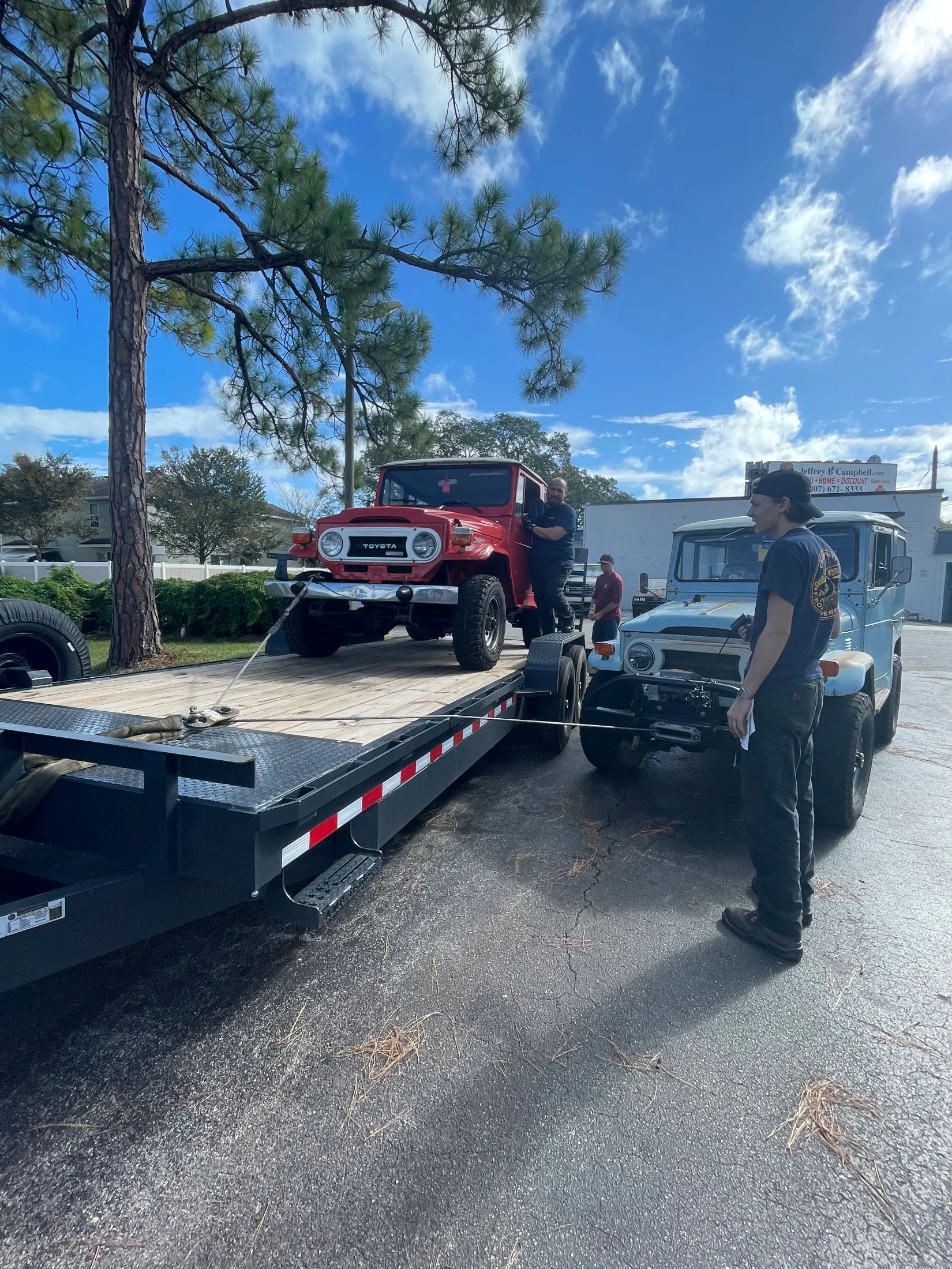

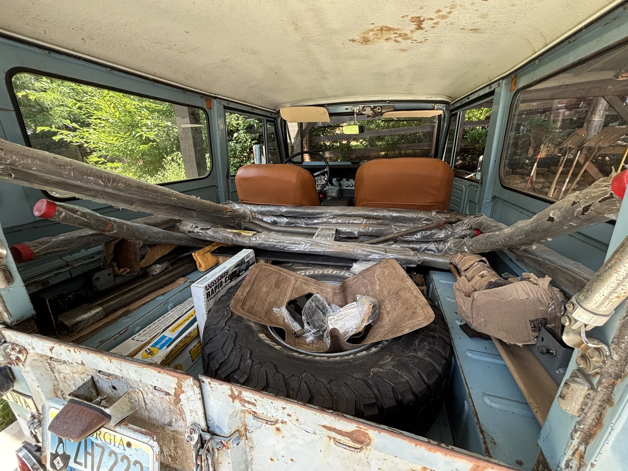

Loaded up the 40 with a buncha parts, and was on the road a 4:45AM (to hopefully beat some of the heat) to head 7hrs down the road to Winter Park, FL to meet the gang at Cruiser Matt’s Off-road and leave the 40 behind for the next phase of this project…
I won’t bore you with the details of this 470 mile trip, but I will say 40s sometimes require way more focus and attention than a newer vehicle, and this one has its quirks, steering is a little loose, for one.
It took me 9 hrs to get down there and by the time I made my 3rd and last gas/bathroom stop, it was 87 degrees, outside (and inside), I realized I had left my gas cap at the previous stop, and I was spentttt but I made it, and was excited to be there.
@cruisermatt was nice enough to introduce me to his gang of misfits, and give me a tour of the shop along with talk through my gripes and what I liked about the 40 to get a game plan together.
I came away super stoked (and with an 80 he helped to procure) and I can’t wait for him to iron out the final details of this 40. He helped with my 62, and I am more than happy for him to help with this 40.

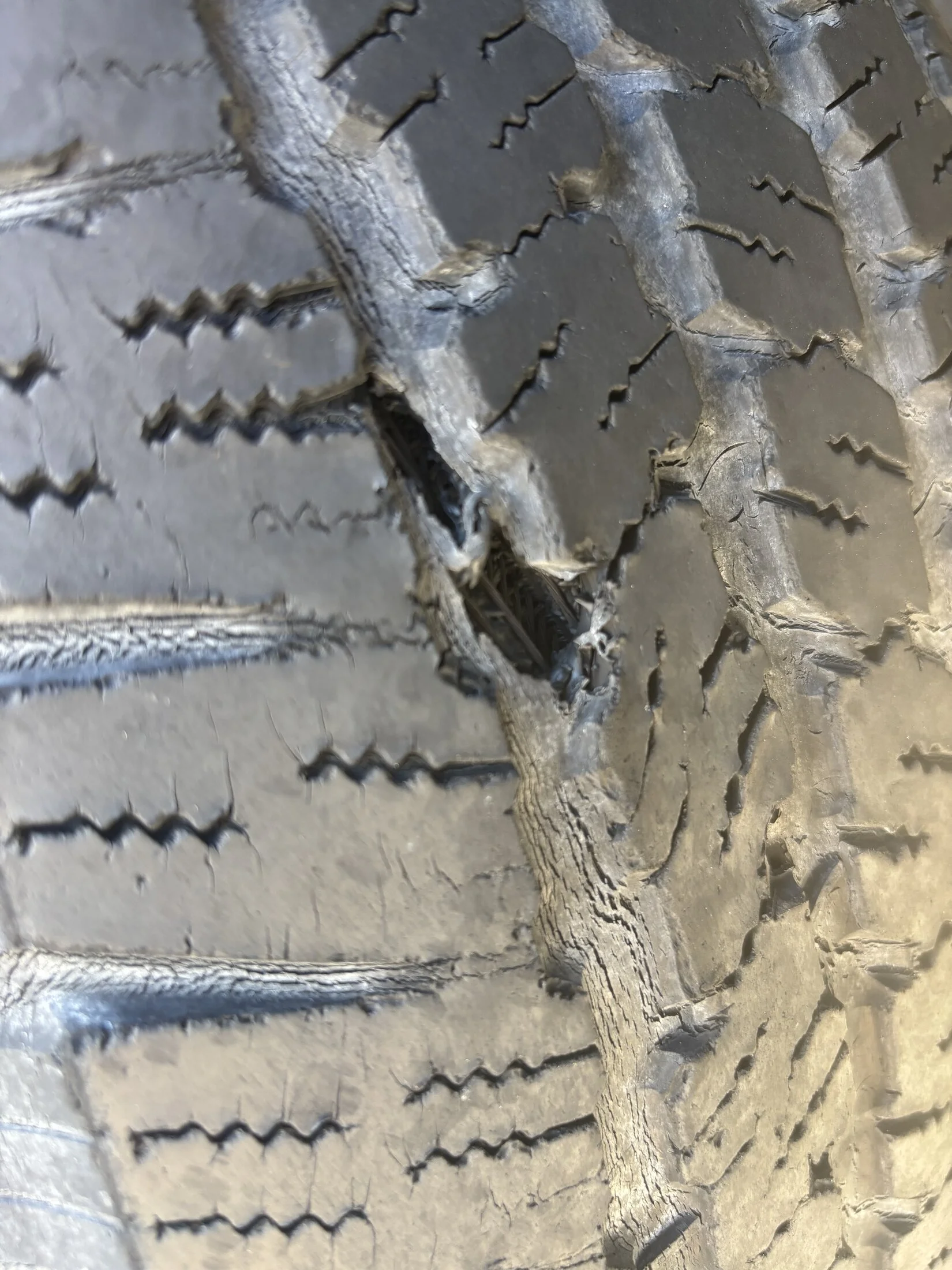

Oh and I knew I was gambling coming back home yesterday with 12 year old date code tires, and sure enough front right tire let go after about 250 miles, and had to get a ride the last 200 miles back… but I have new rubber waiting for me in Atlanta for this 80, so just add it to the 🥸 details of this 36 hrs…

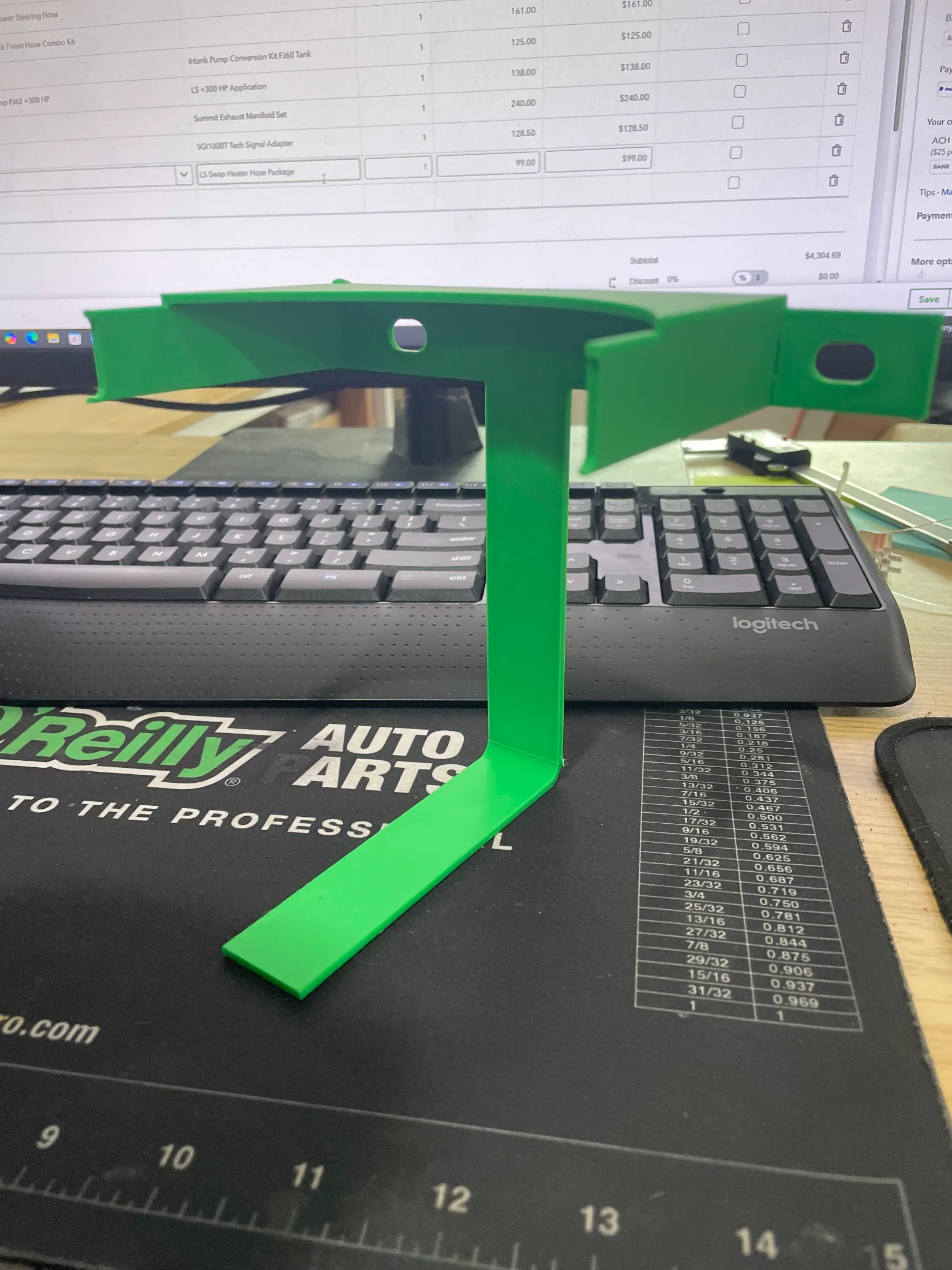

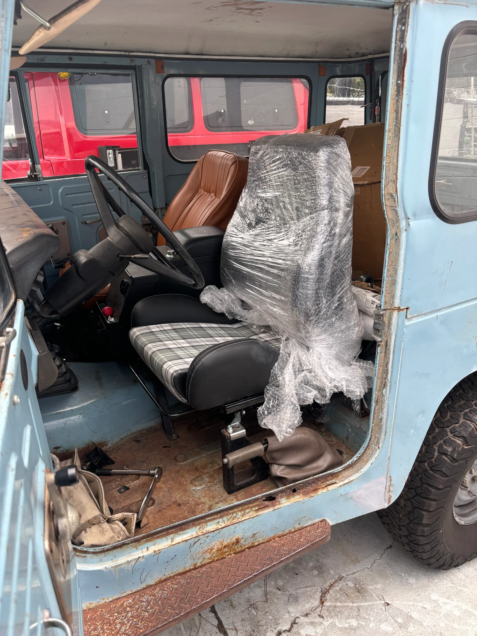

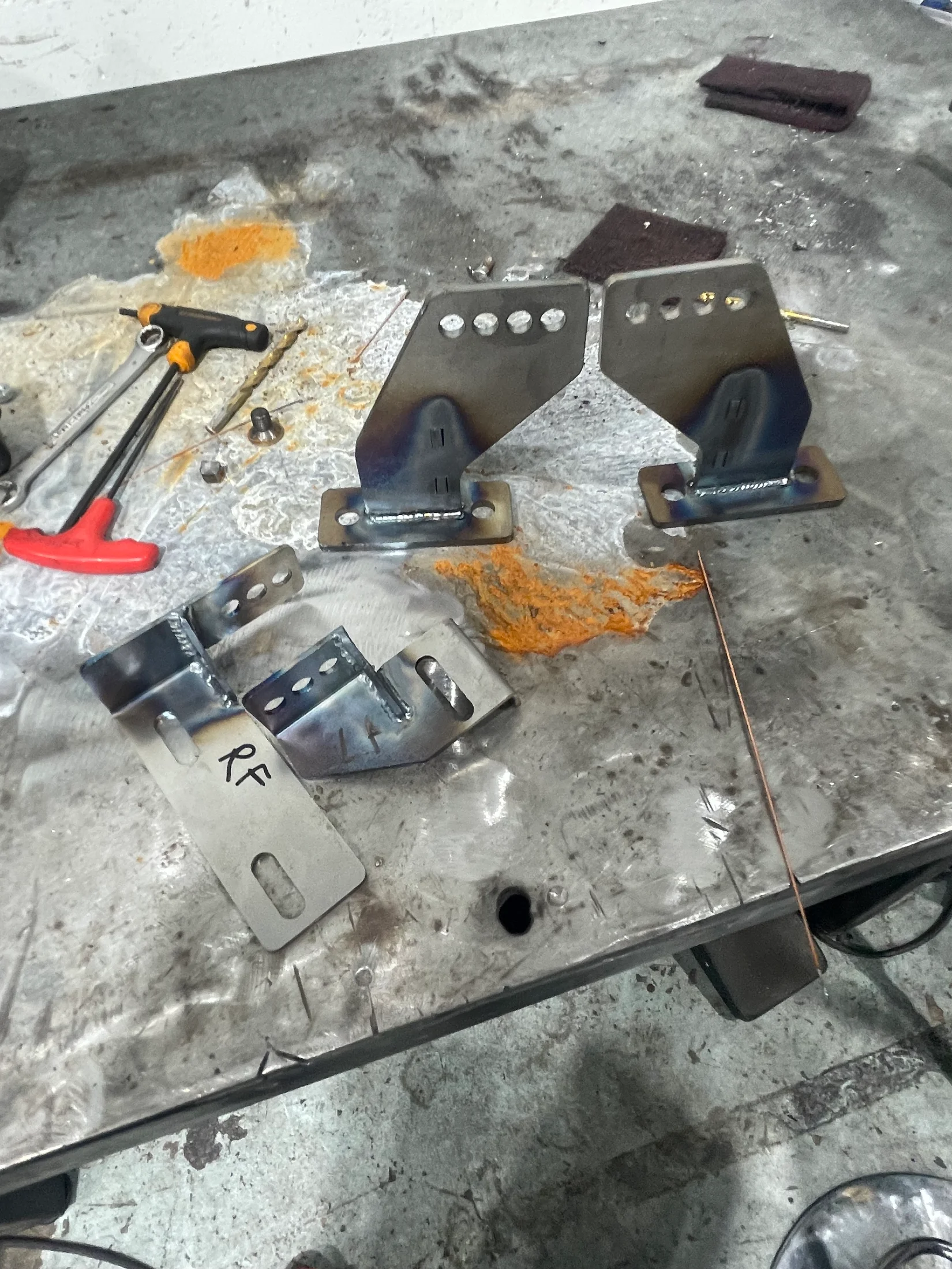

Here’s a little catch-up and some current work on the 40 @cruisermatt ’s Offroad… starting with some one-off brackets he 3d modeled and made a couple iterations to mount my Recaros… I am not sure these are final but they’re close!

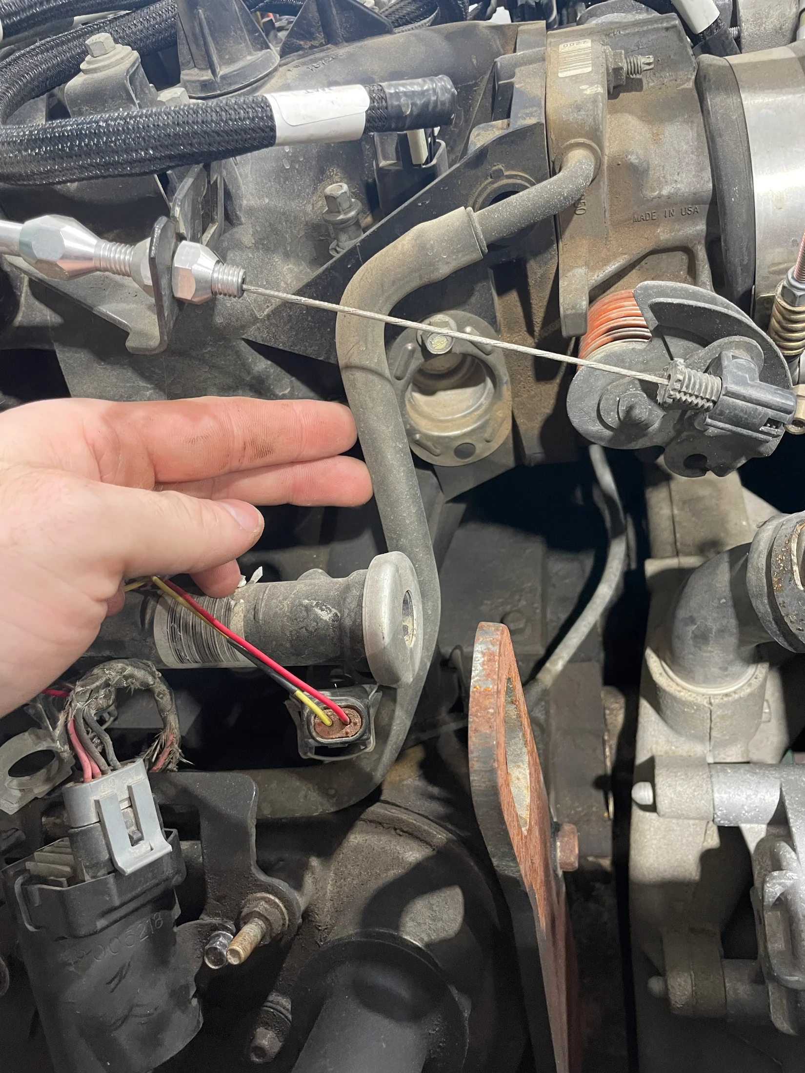

Picked up an evap manifold, evap check valve, a charcoal canister, and considering moving the upper outlet of the radiator to the alternate side to clean things up a bit and make it a simpler setup…

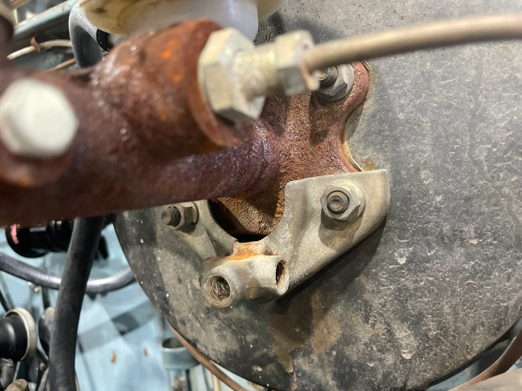

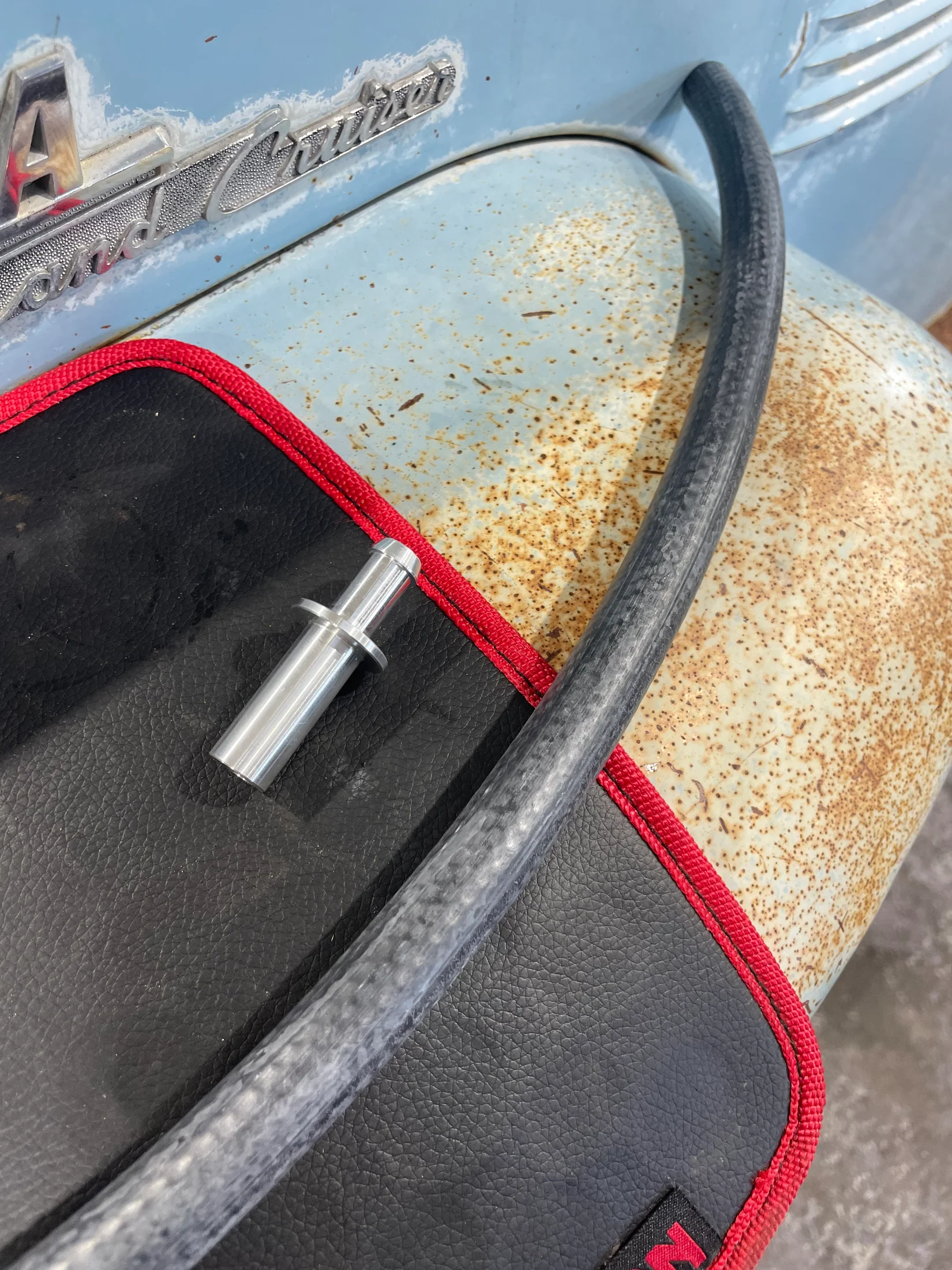

Brake booster hose kit from Cruiser Matt’s Offroad going in…

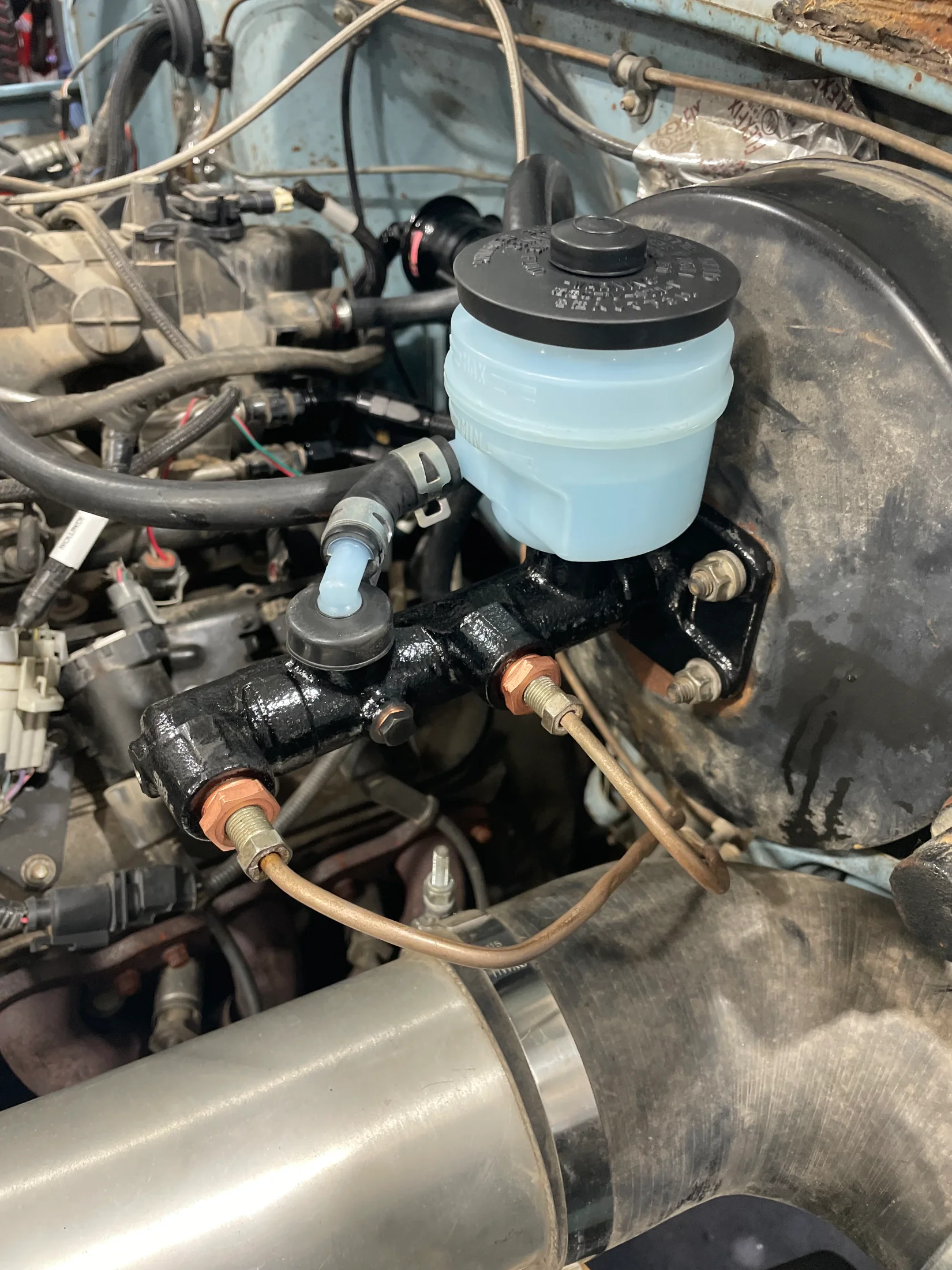

Also replacing the brake master cylinder with an FJ62 unit to clean it up with both ports being on the same side… also to get rid of the unnecessary T...

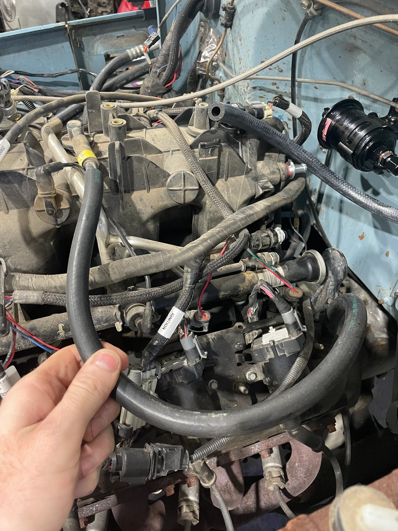

Also replacing all 3 of these hoses with new…

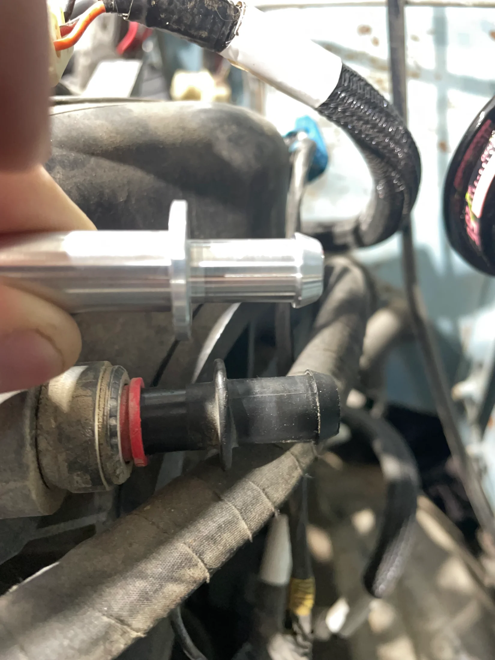

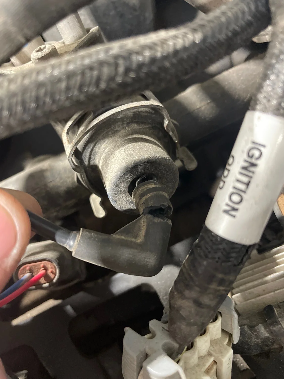

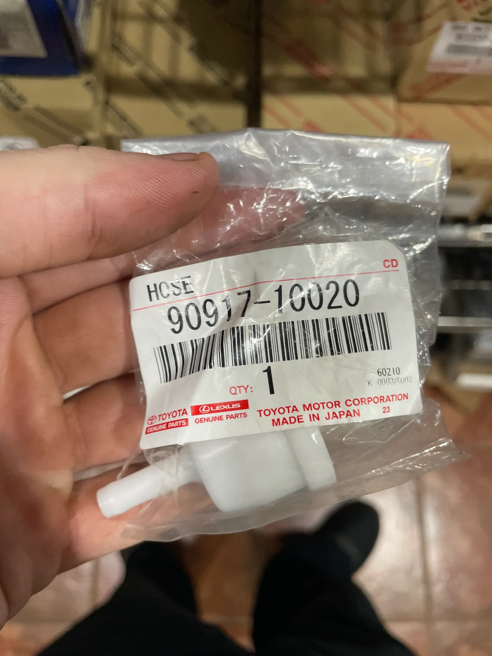

How is that brake booster nipple installed/stay in place? Looks like you had a booster line already....what was the need?
GM booster outlet is 1/2". Toyota Booster hose is 10mm
Typically everyone else uses a stepped barb to adapt or just monkey the wrong hose into place. Usually not proper vacuum-rated hose either.
The port is a simple friction collar just like GM

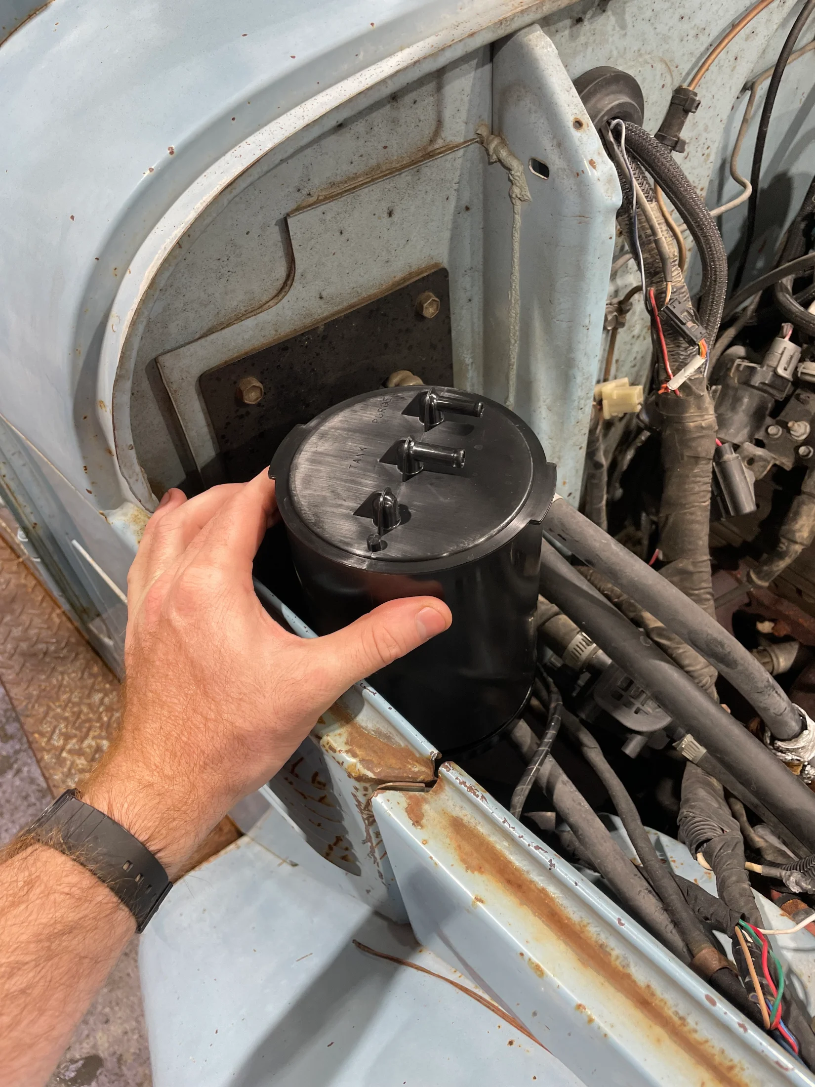

The guys at Cruiser Matt’s do some amazing work with the 3D printer…
This is the Charcoal Canister bracket… it’s designed, printed, test fit, and being laser cut 👊🏾

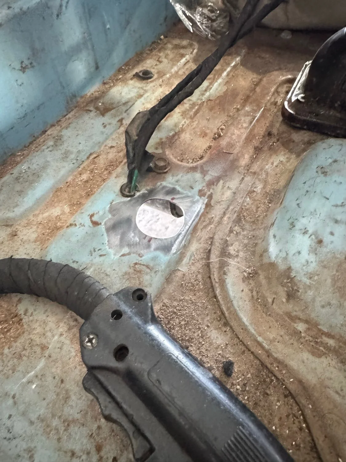

The original hole where the fuel lines came in has been welded up…
Master replaced and brake booster kit installed…

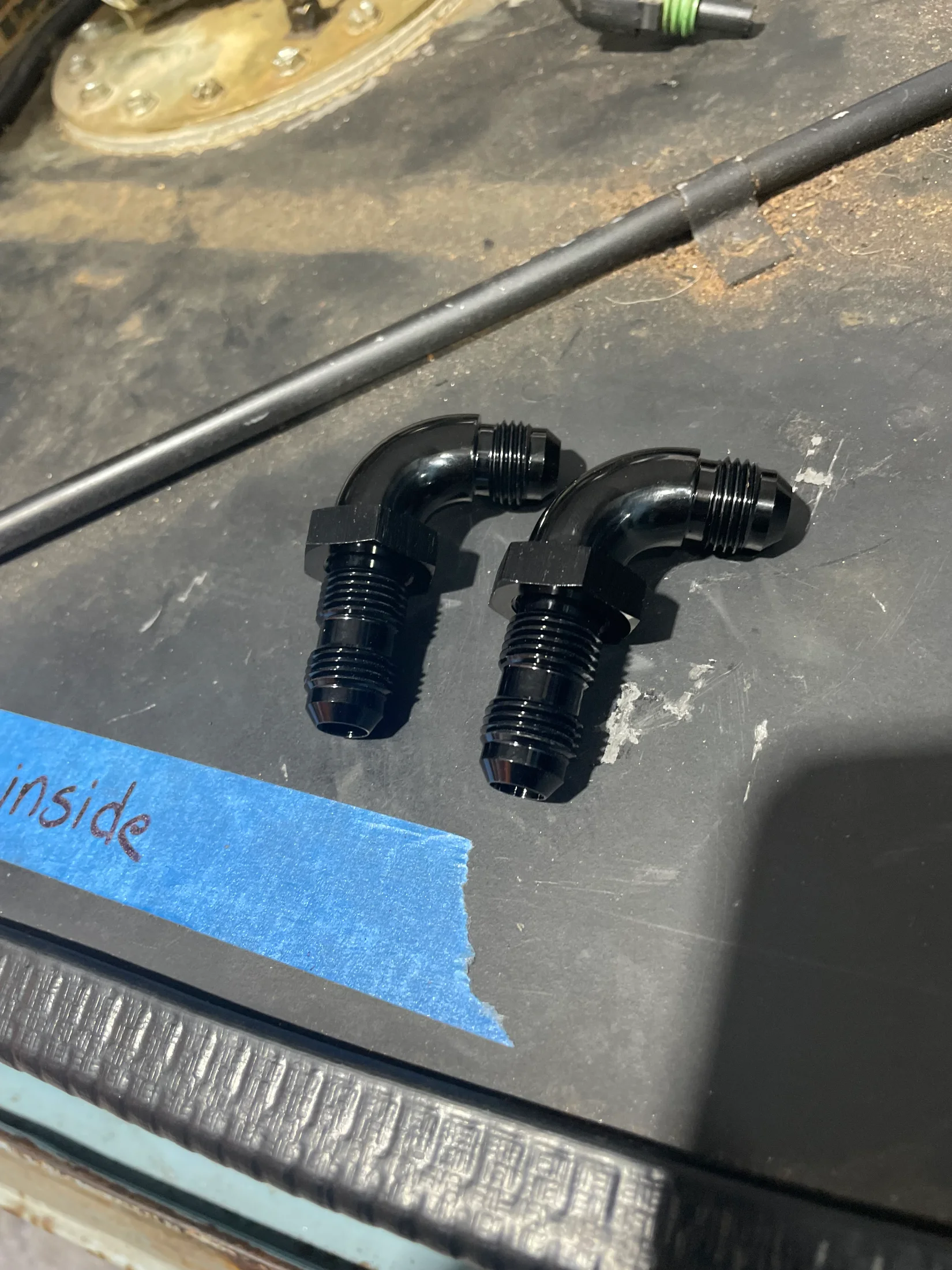

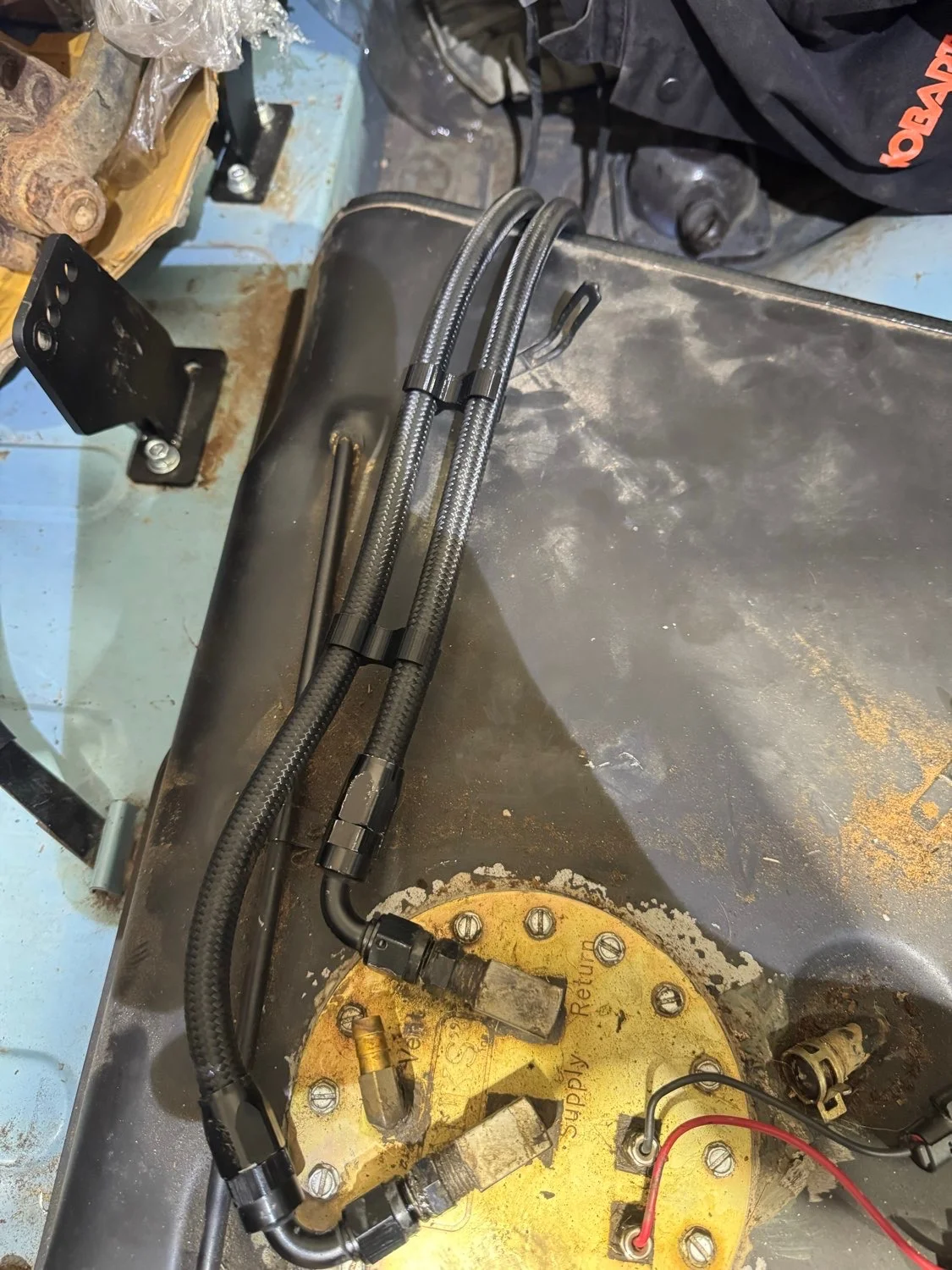

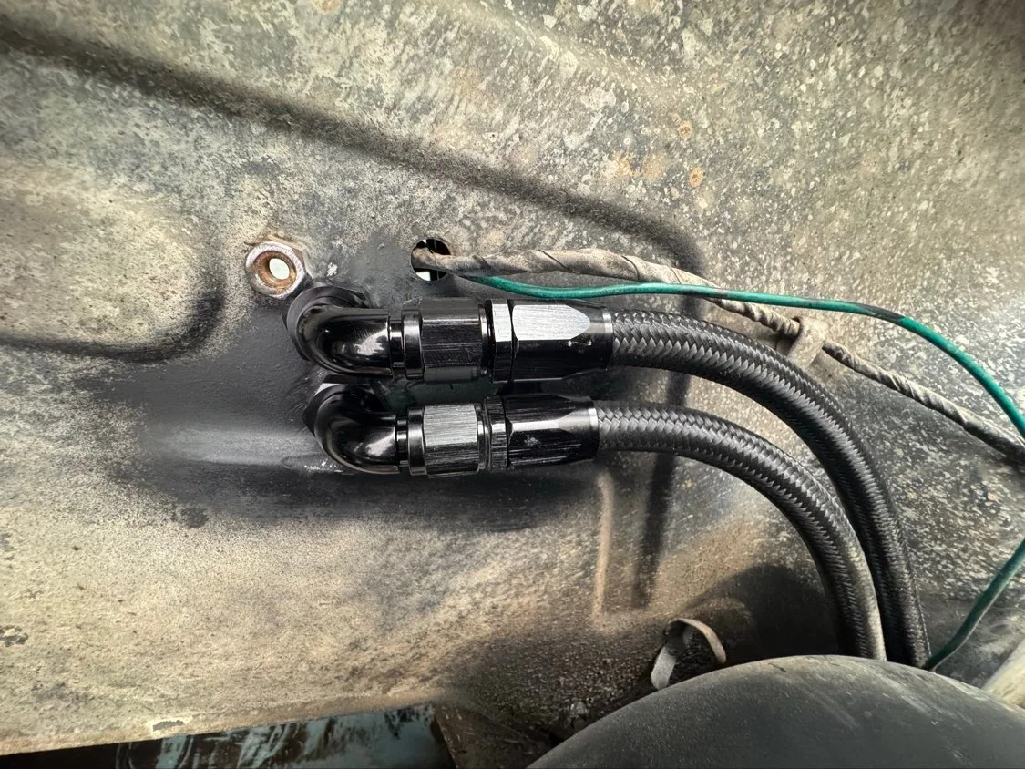

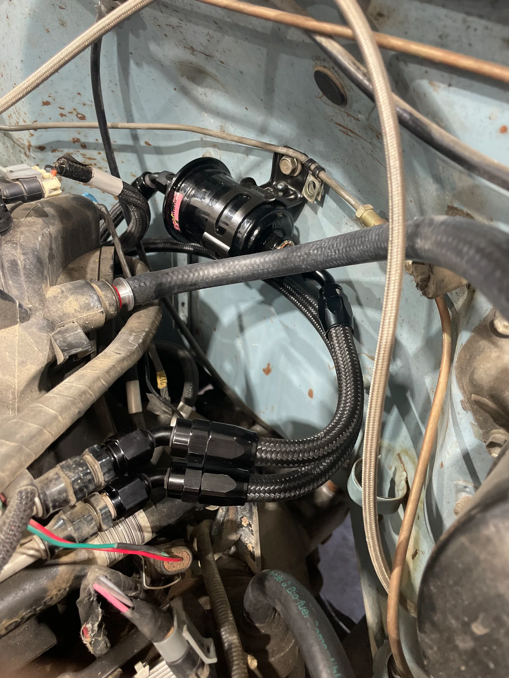

New fuel lines and an FJ80 fuel filter…

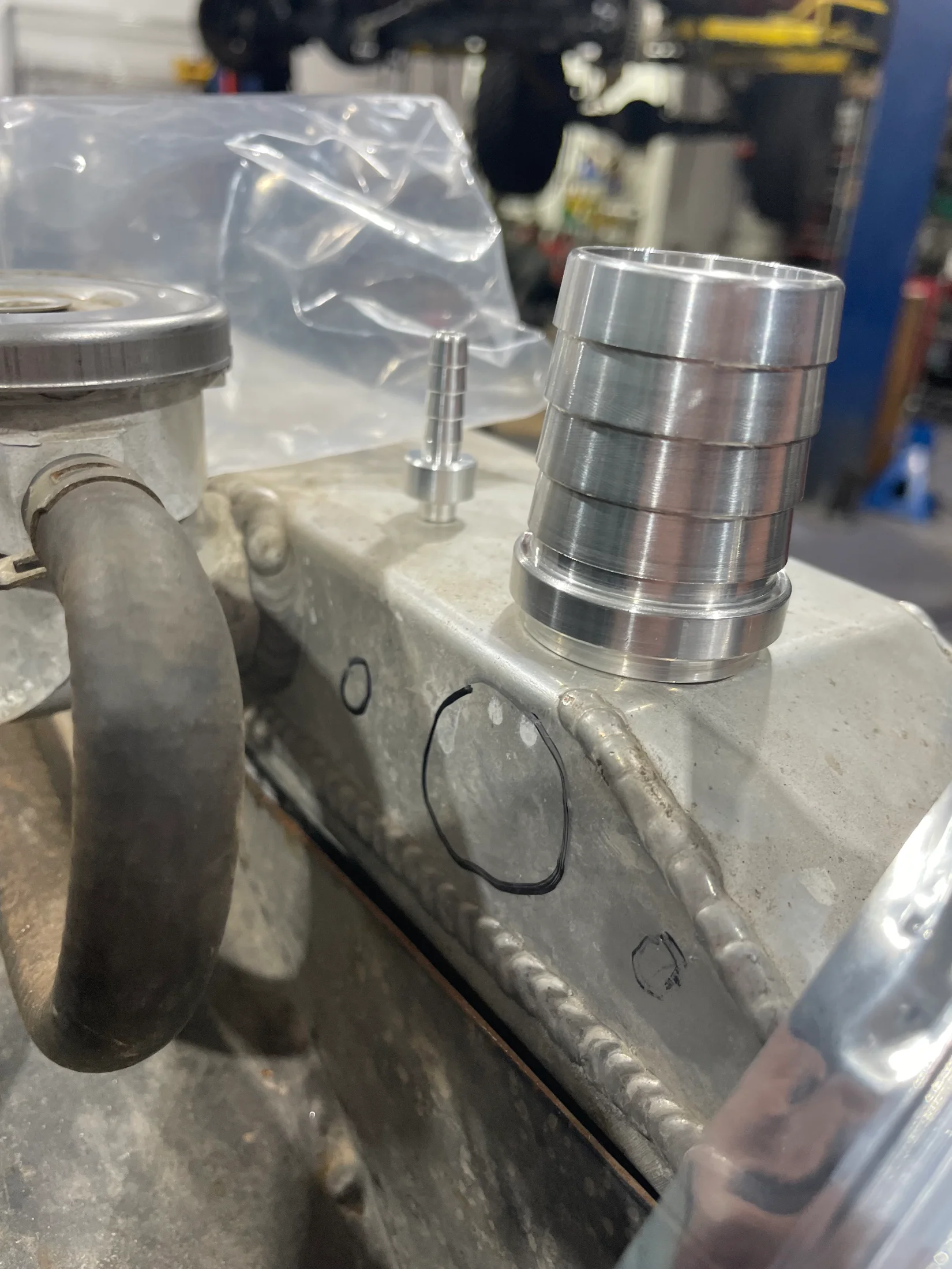

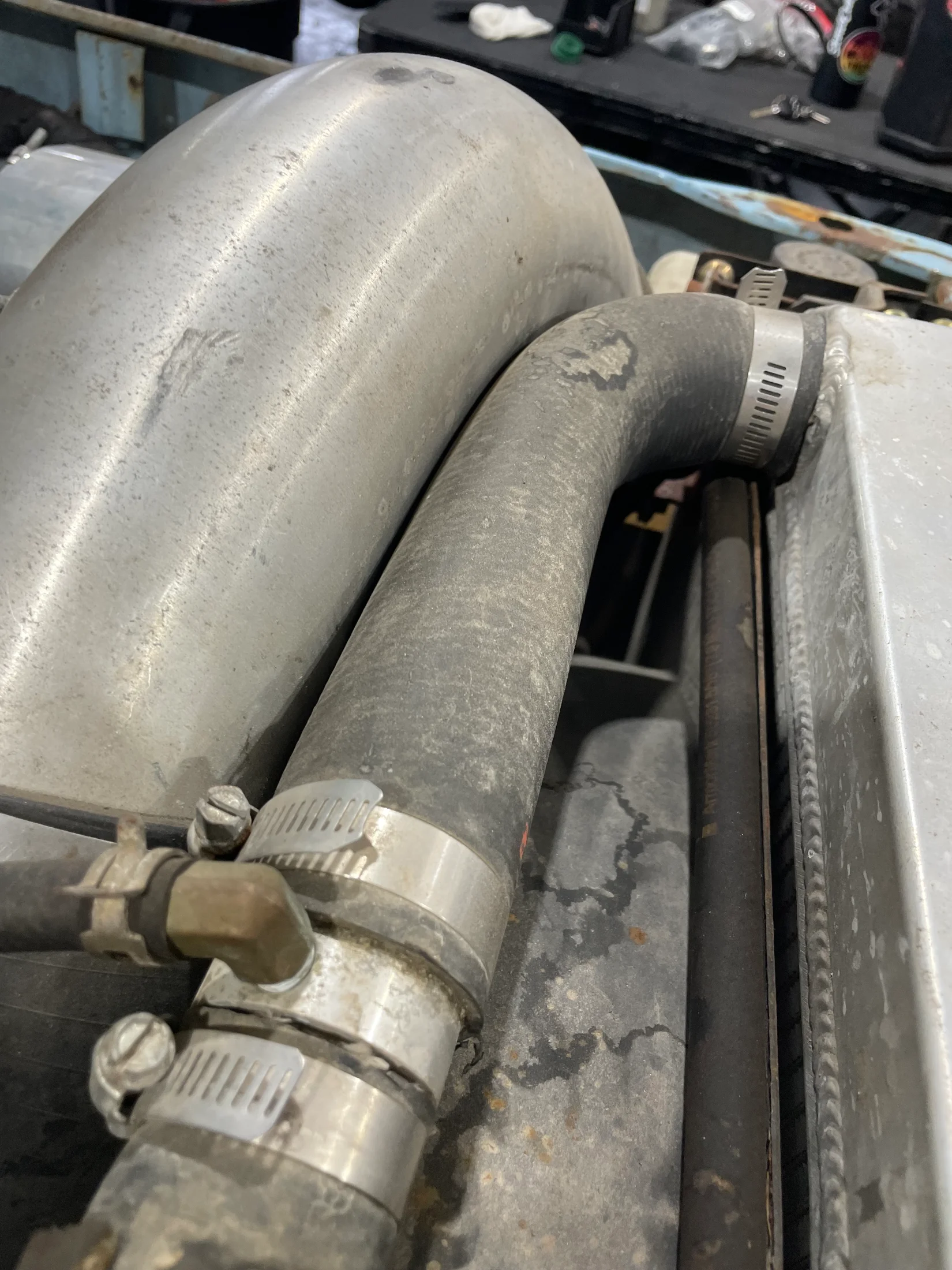

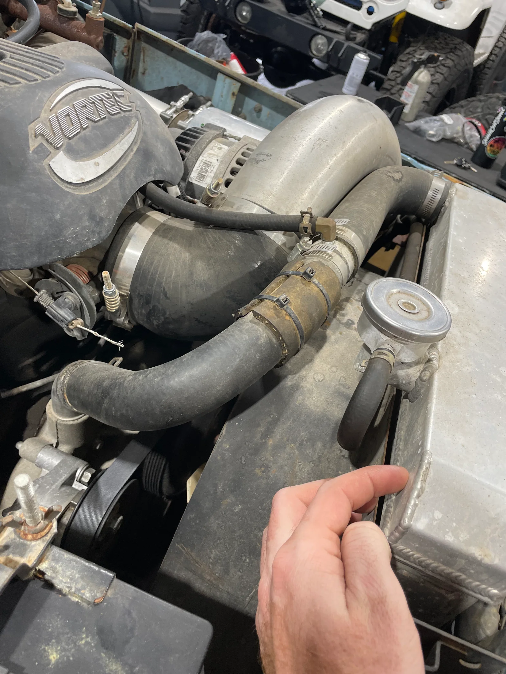

Steam port and radiator upper outlet are going to be welded on passenger side of radiator…

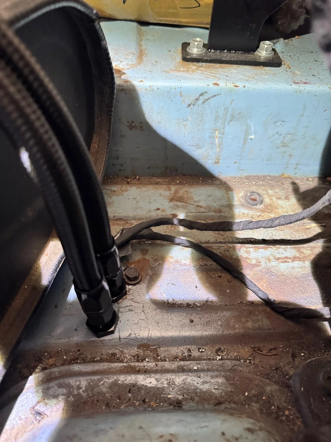

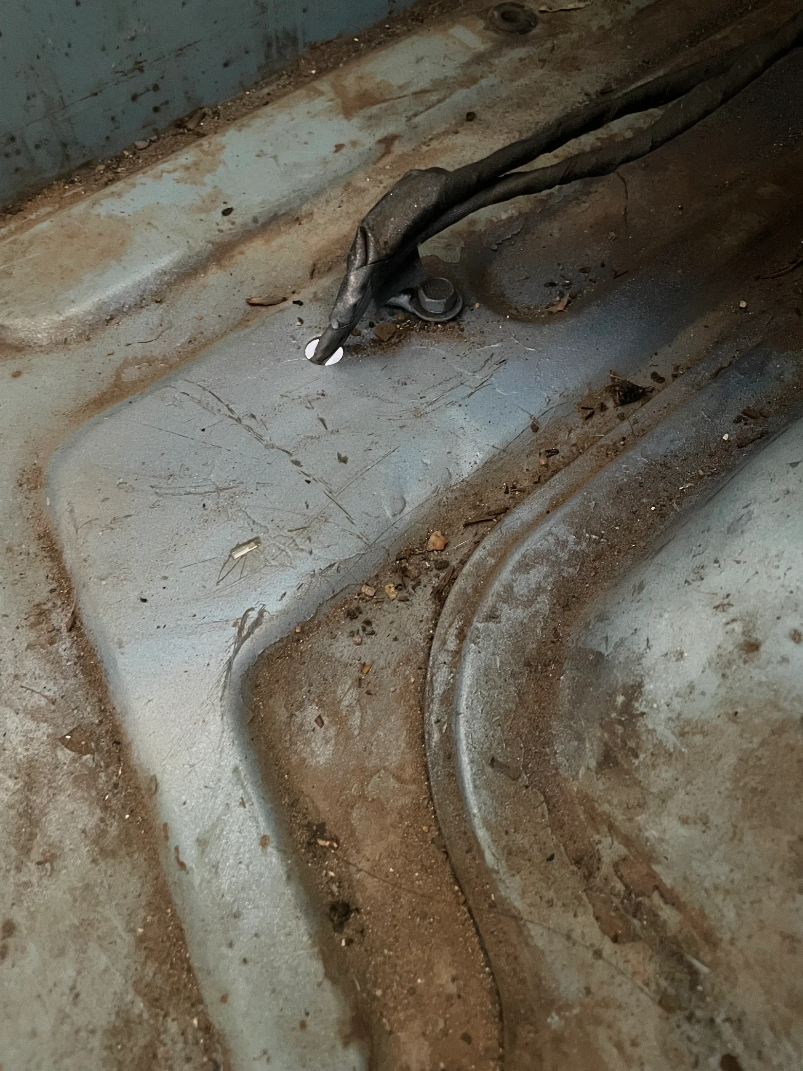

And some fuel line goodness going into the cab to the tank…
