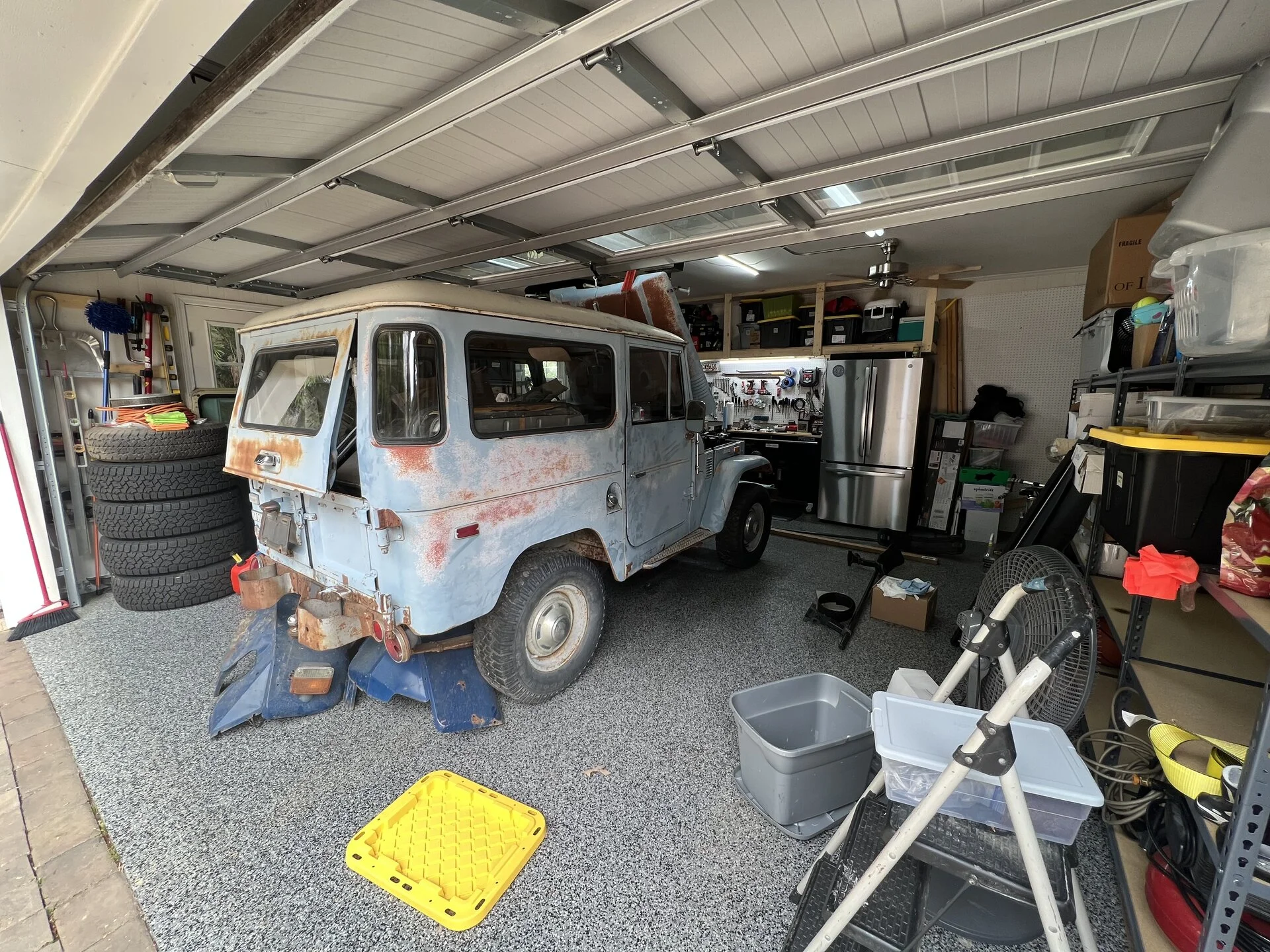

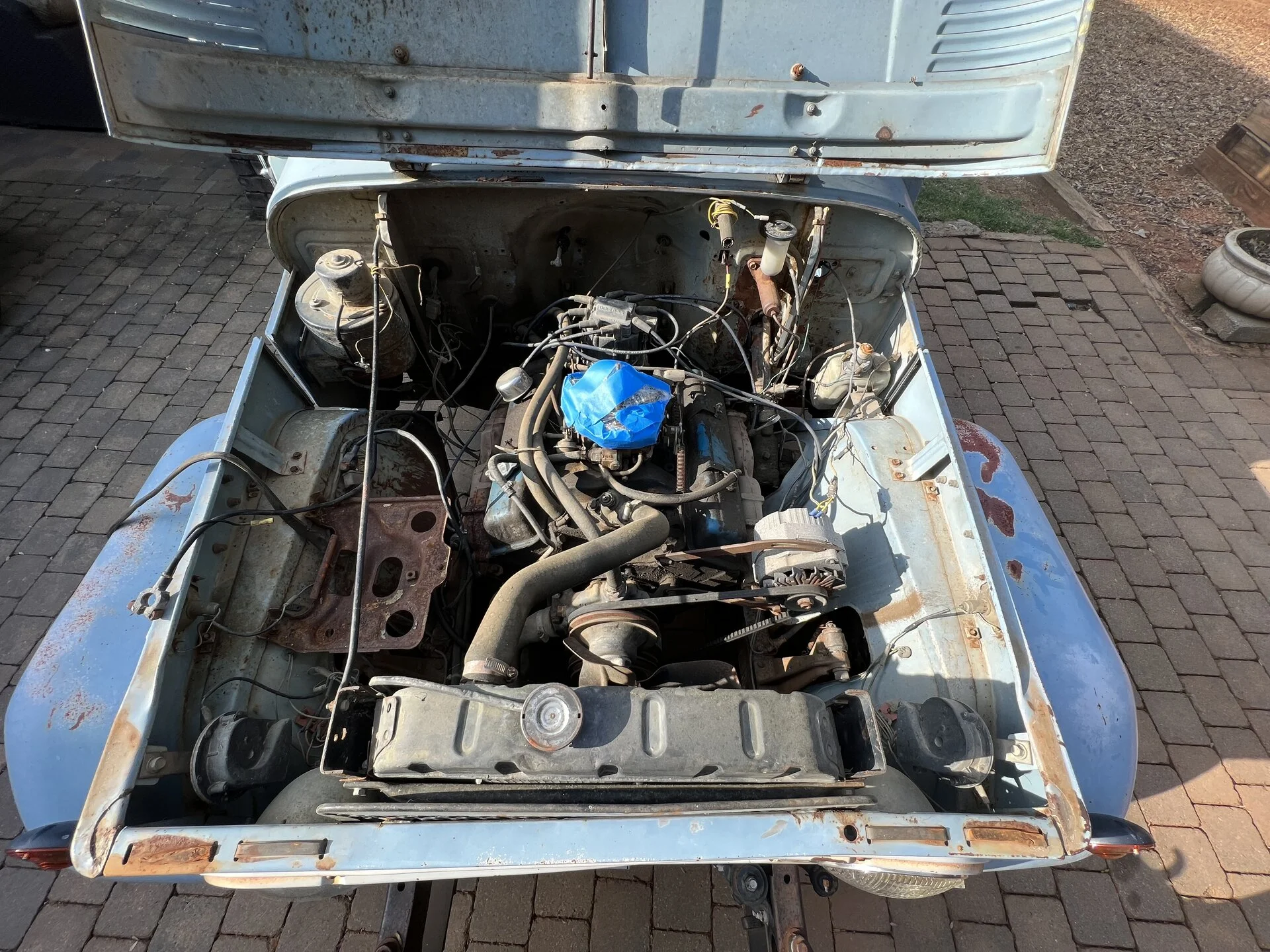

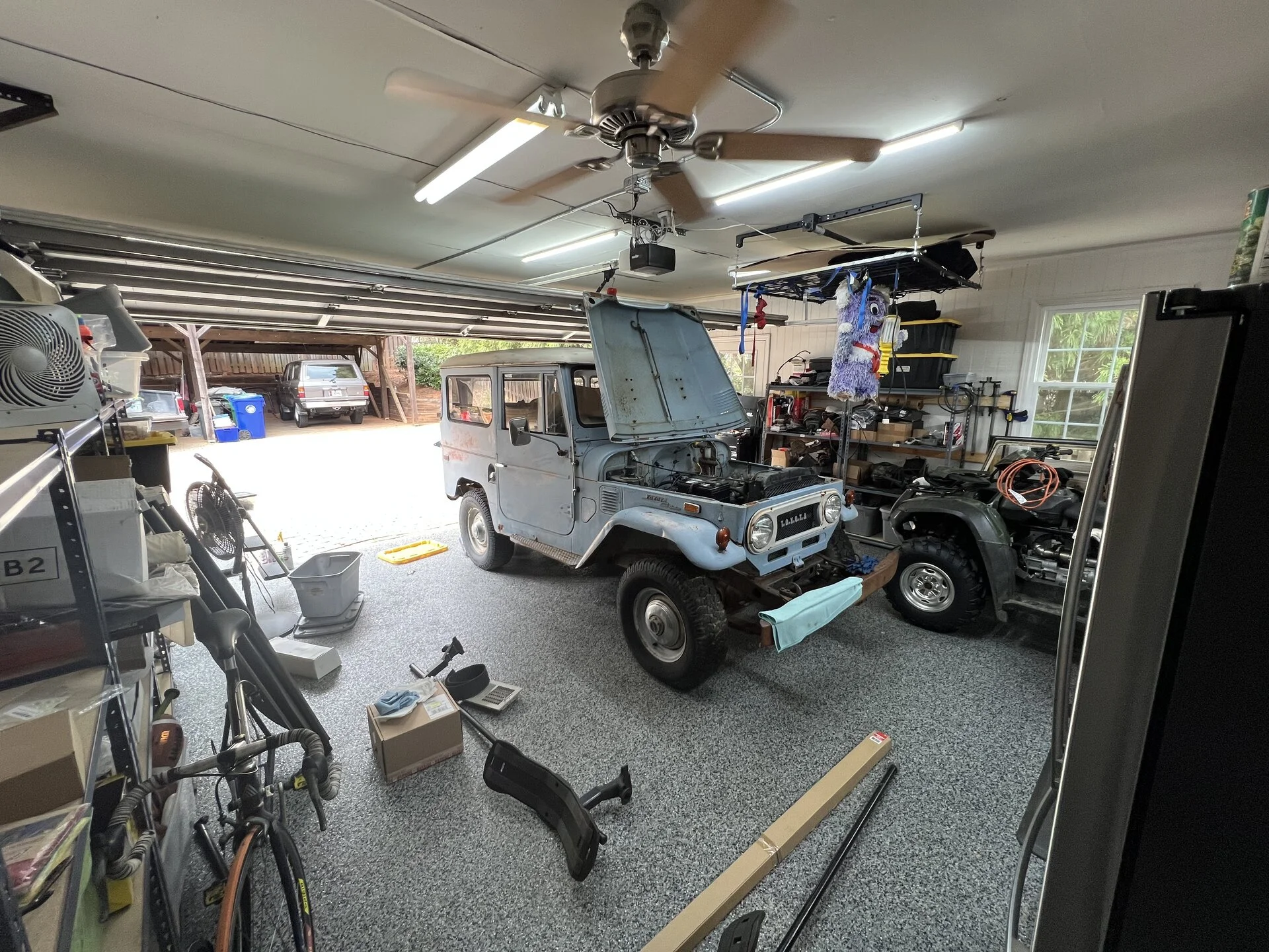

I mentioned backyard/driveway work before, so this girl needed to make her way into the garage (along with a bunch of other stuff/parts)… when I left it, the rear wheel was freed from whatever crusty mess was holding it stuck.

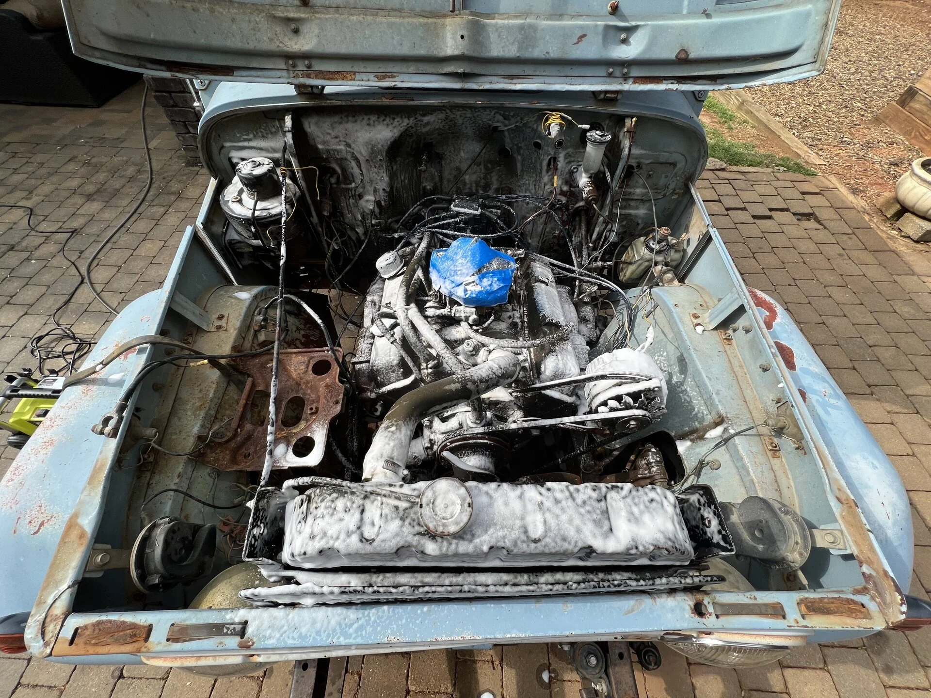

Before we attempted to roll/drive it into the garage, @SkeeLo22 had the bright idea to give the engine and transmission a good cleaning with 4 x cans of degreaser and a pressure washer… it was a good idea.
And with quite a bit of moving stuff around and throwing out stuff we didn’t need, we have room on both sides of this one, so plenty of room for activities… big step IMHO. And over the next month of backyard stuff/driveway stuff, we can make some progress (especially once tax season is over)
that's the nicest that garage floor is ever going to look :lol:
When you're right, you're right! Gonna be a mess coming up here after tax season is over!

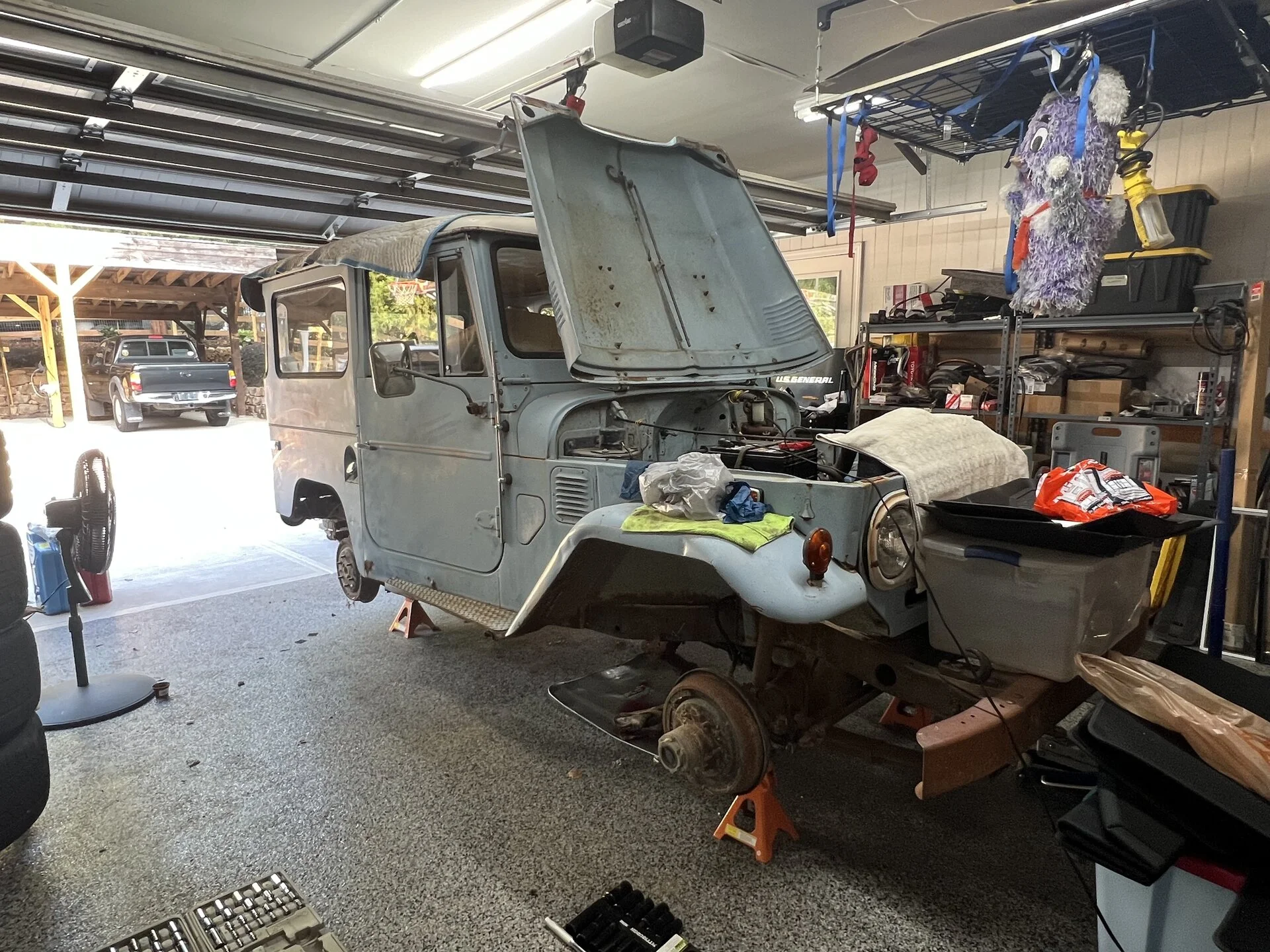

@SkeeLo22 came over and we decided to spend the morning into the early afternoon working getting to our next objective with Old Blue… GETTING HER TO STOP.
And while eventually, there may be discs up front, for the time being the objective is just to get it to stop so we can move it around and get to a couple other projects waiting in the weeds (literally - also pictured) and get them driving/steering/stopping before making any decisions about “upgrades”

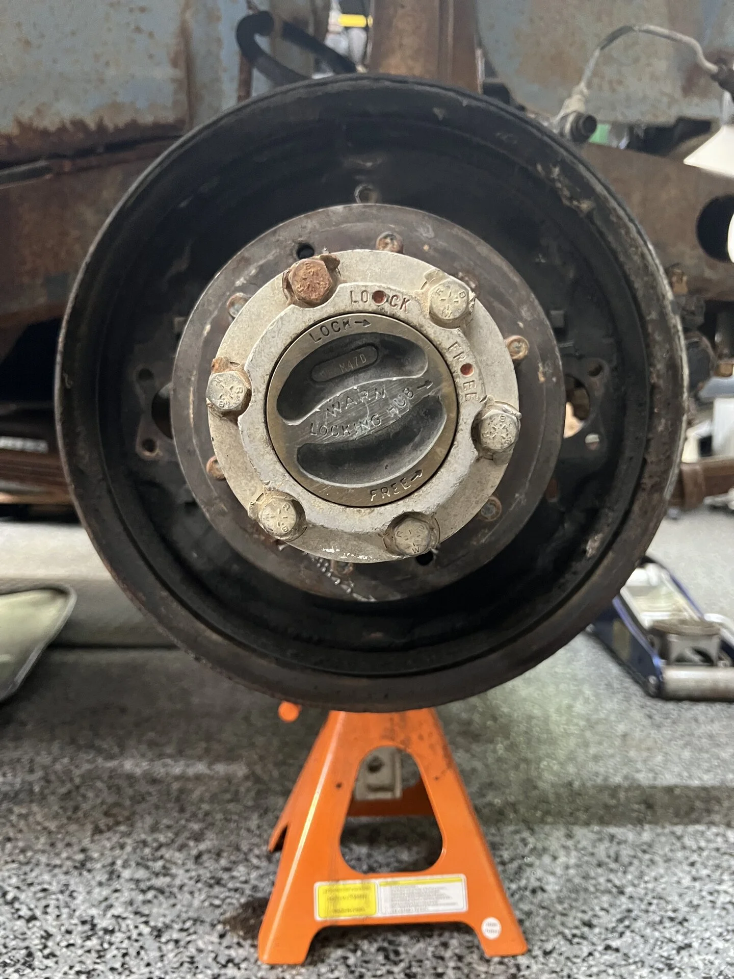

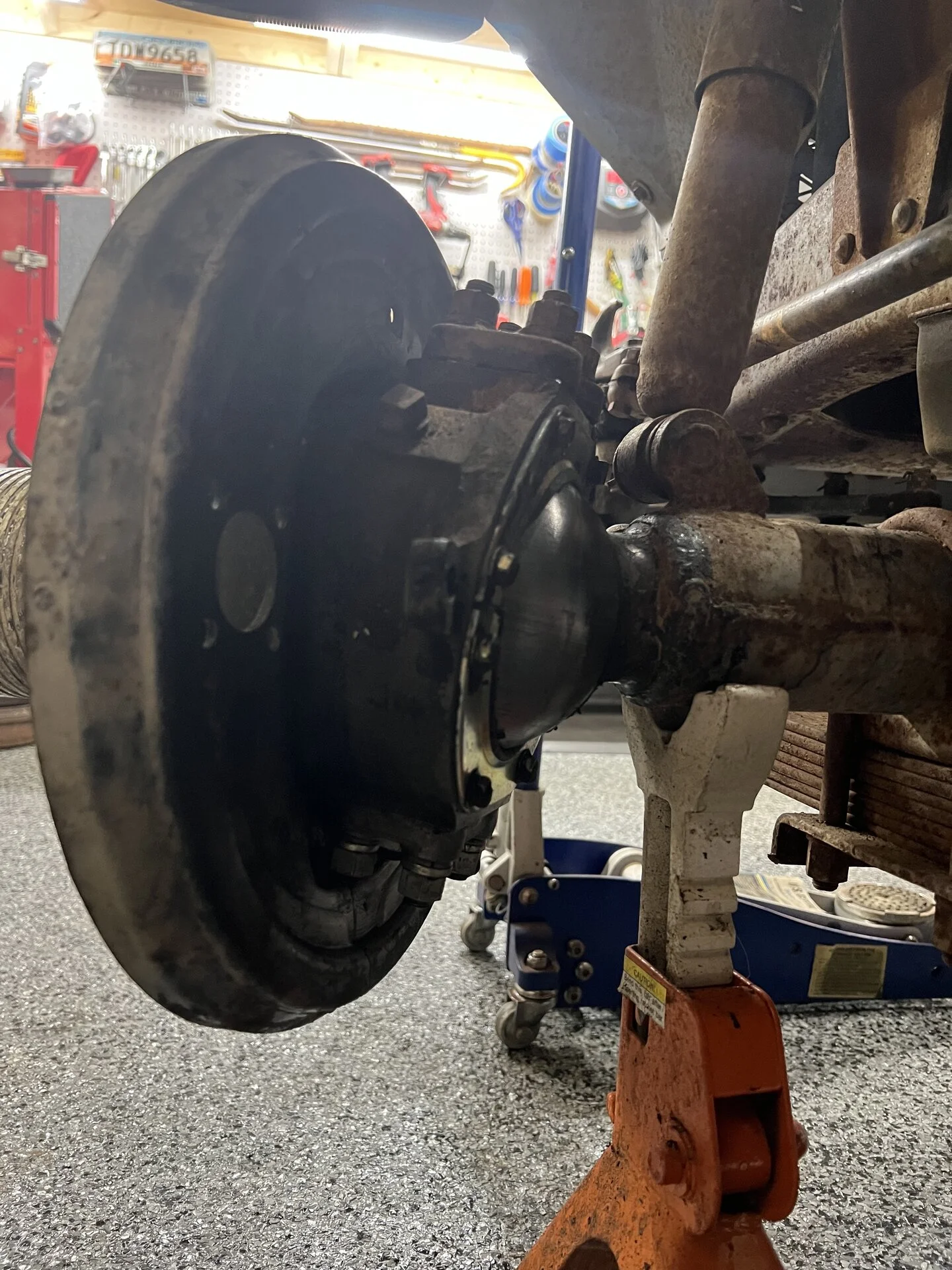

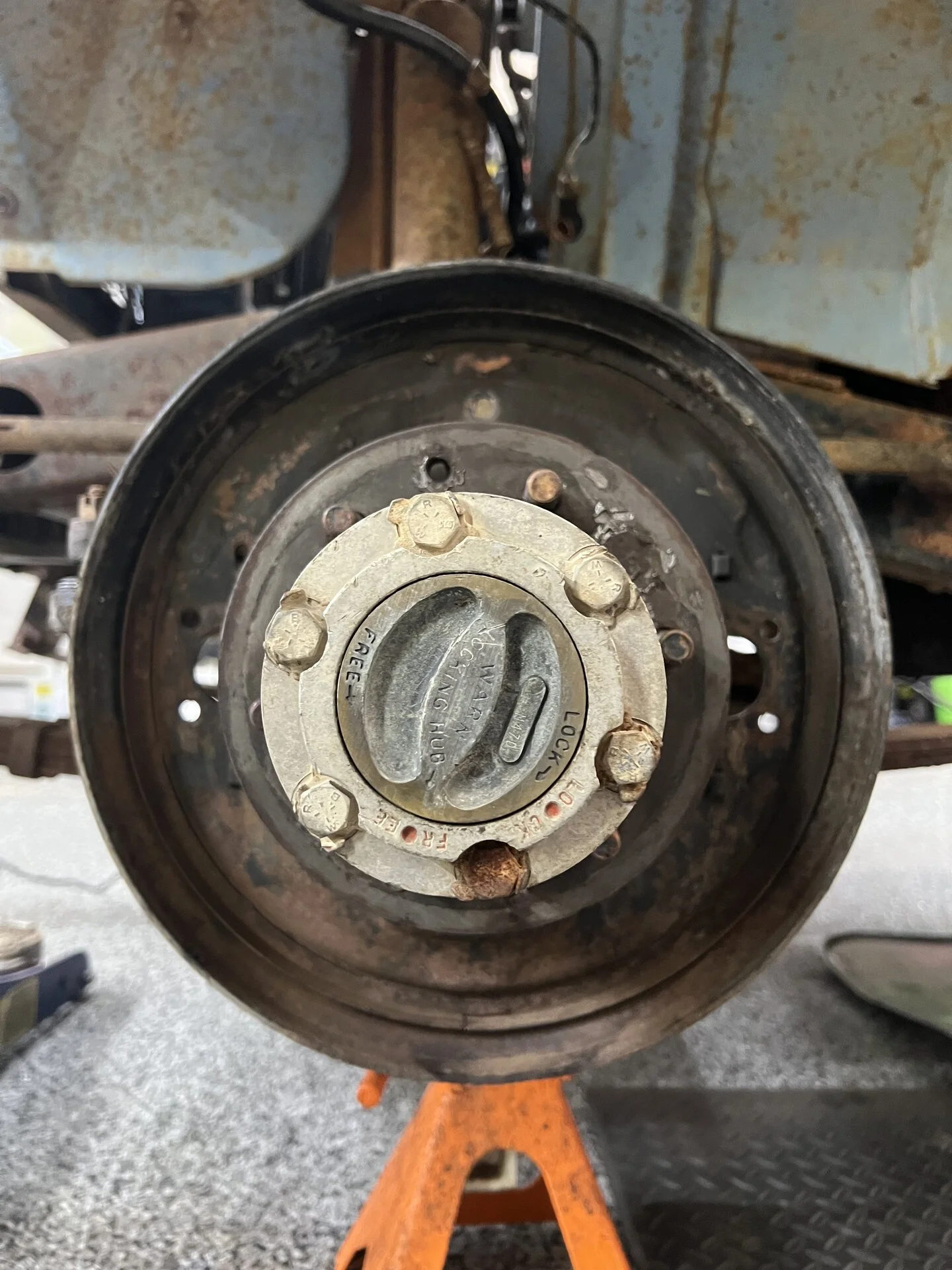

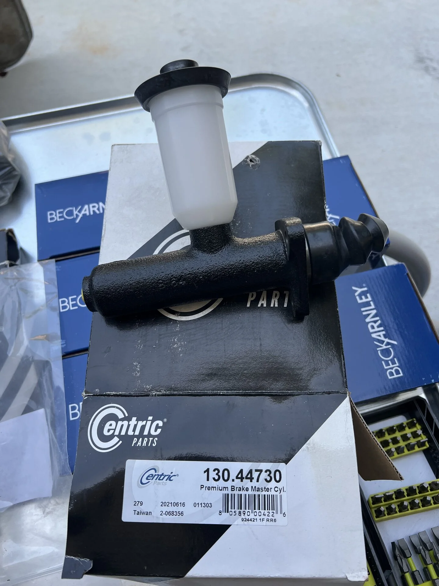

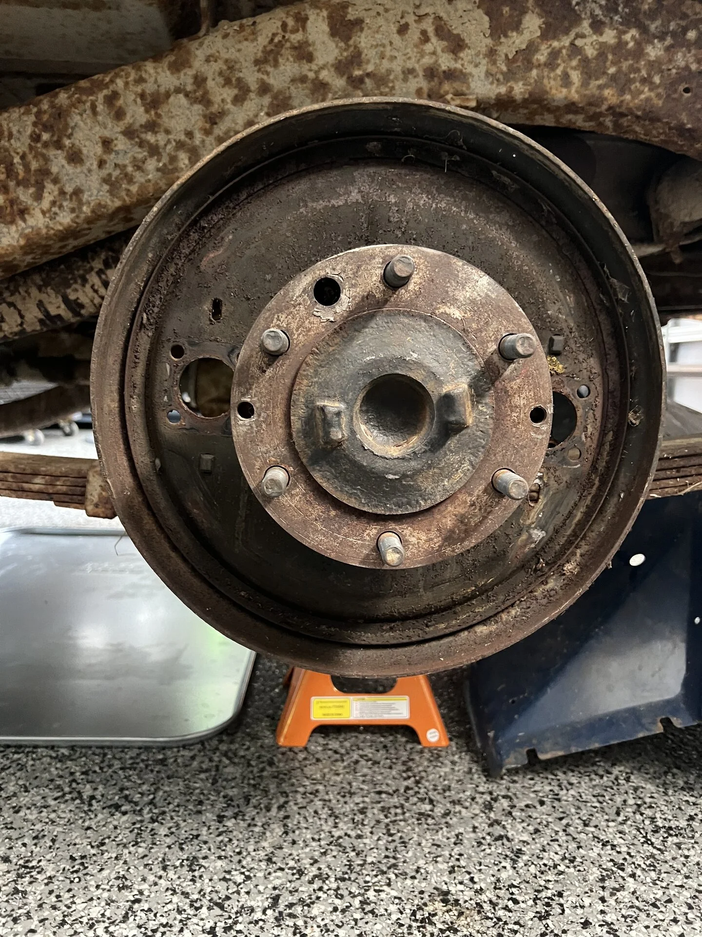

So with that said, to get her to stop we’re rebuilding the drum brakes at all 4 x wheels… purchased all the goodies (rubber lines, pads, springs, master cylinder, and wheel cylinders) from Rock Auto and proceeded to take things apart.
The brake shoes fought us, but are actually in pretty good condition considering this truck has been sitting for quite some time…

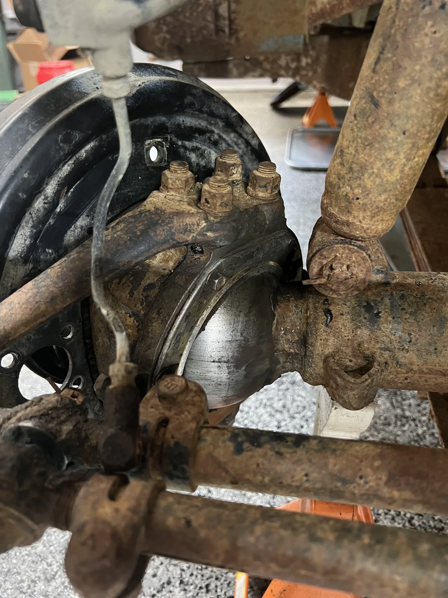

Today, we got everything removed from the front and back and @SkeeLo22 decided it was time to see the shiny front end birfs, so he took it upon himself to clean the crud out of everything in the front. At some point the front end will need a rebuild but who knows if we stick with these coarse spline front end? So for now R&R… clean and replace…
Later, who knows 🤷🏾‍♂️

  • Bench bleed master and install

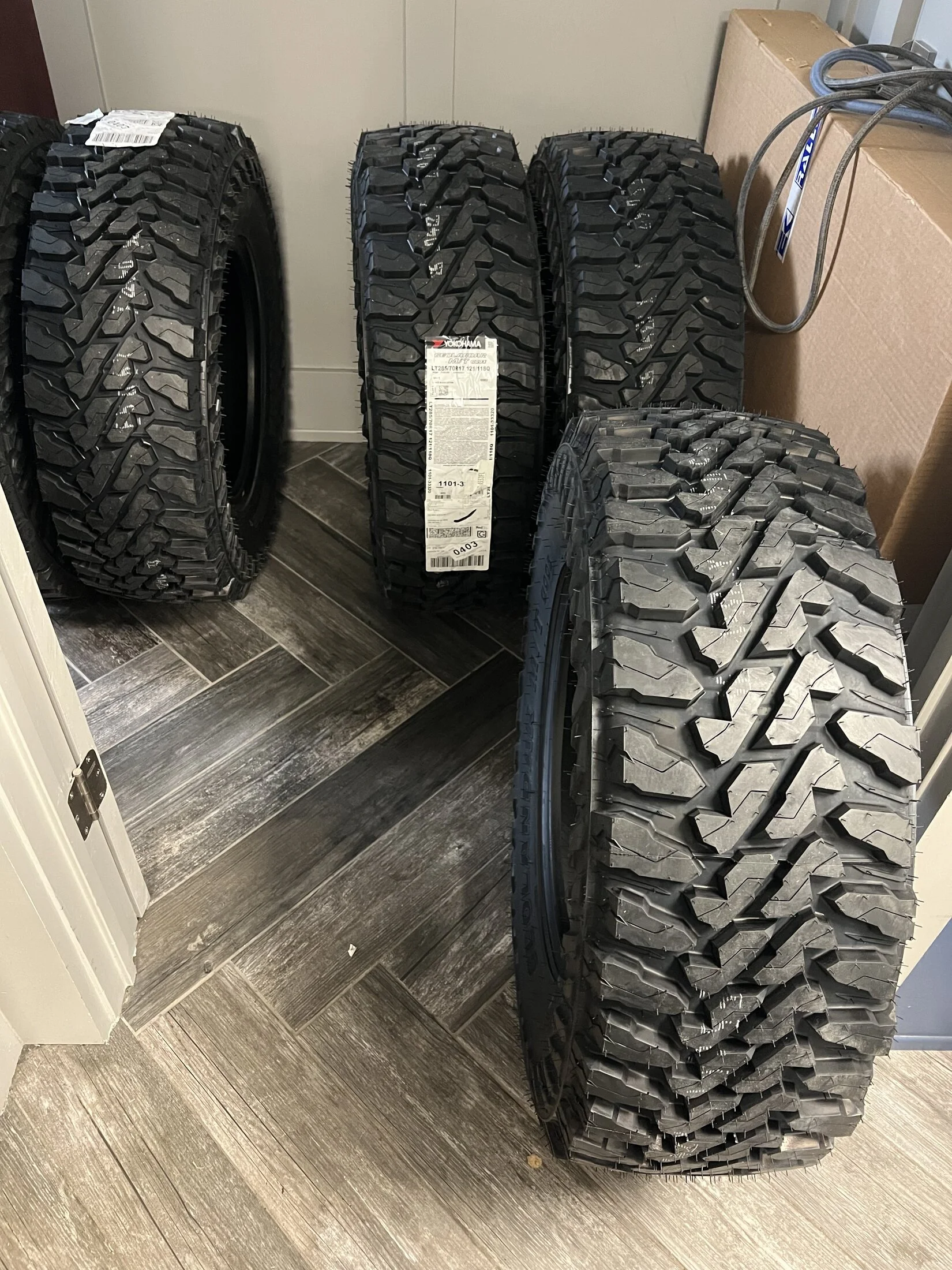

  • Bought 5 x 17” FJ Cruiser steelies and ordered up some of @cruisermatt hubcap rings to weld on… wheels will be painted grey for final assembly
  • Also got 5 x Yokohama Geolander MT G003 in 285/75/17 (32.9” tall) to wrap those wheels…

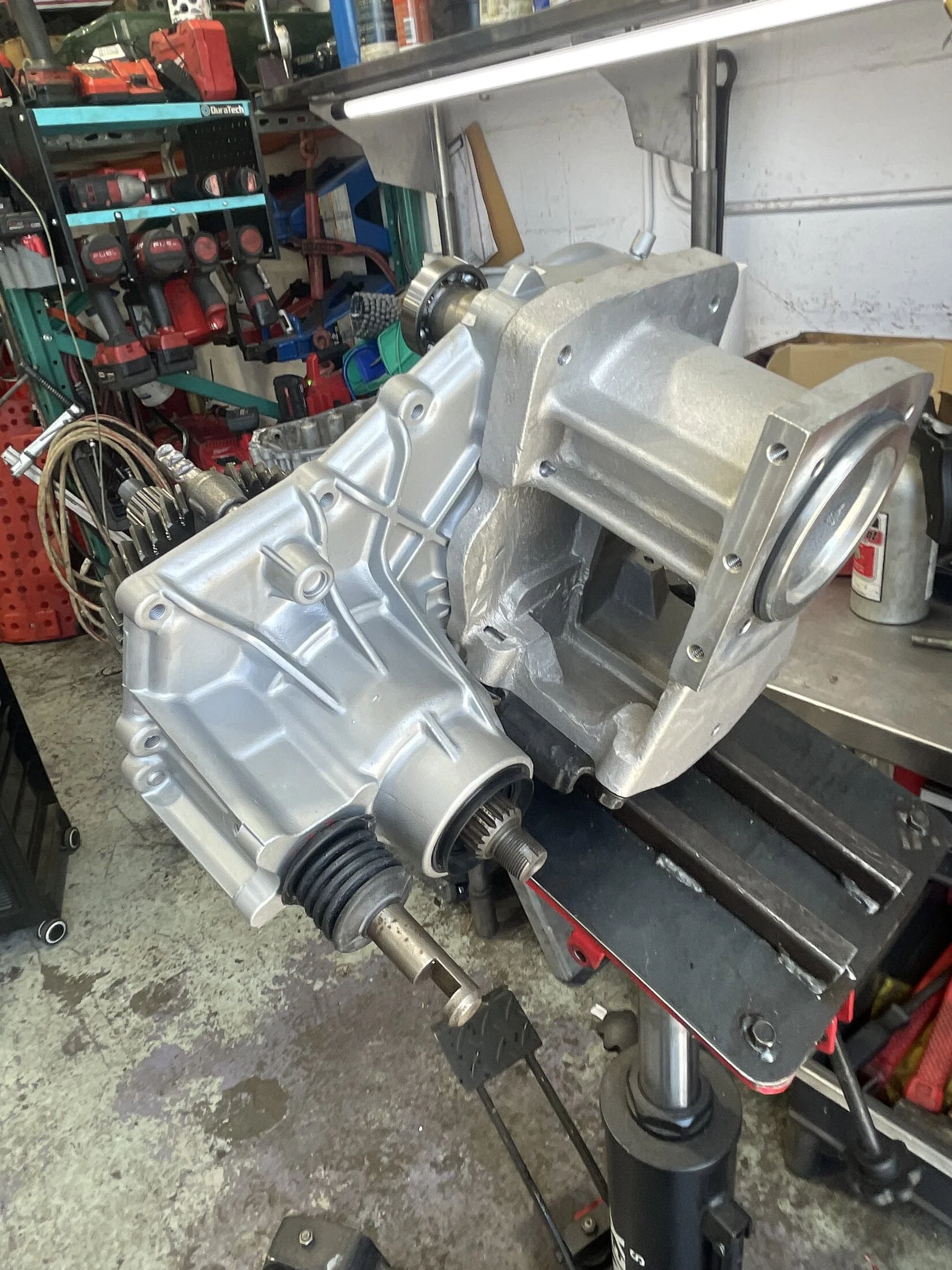

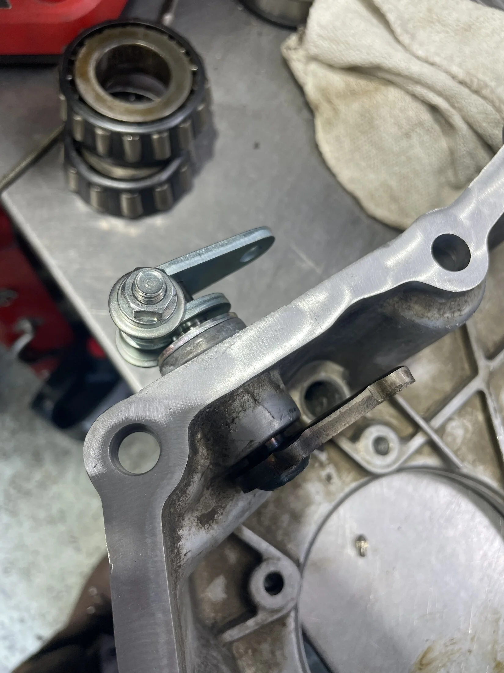

After vapor blasting the split case, @cruisermatt pitting her back together and setting it up to try and use the OEM 4wd shifter in Old Blue Eyes…
Kind of a shame it’s hidden under the truck.

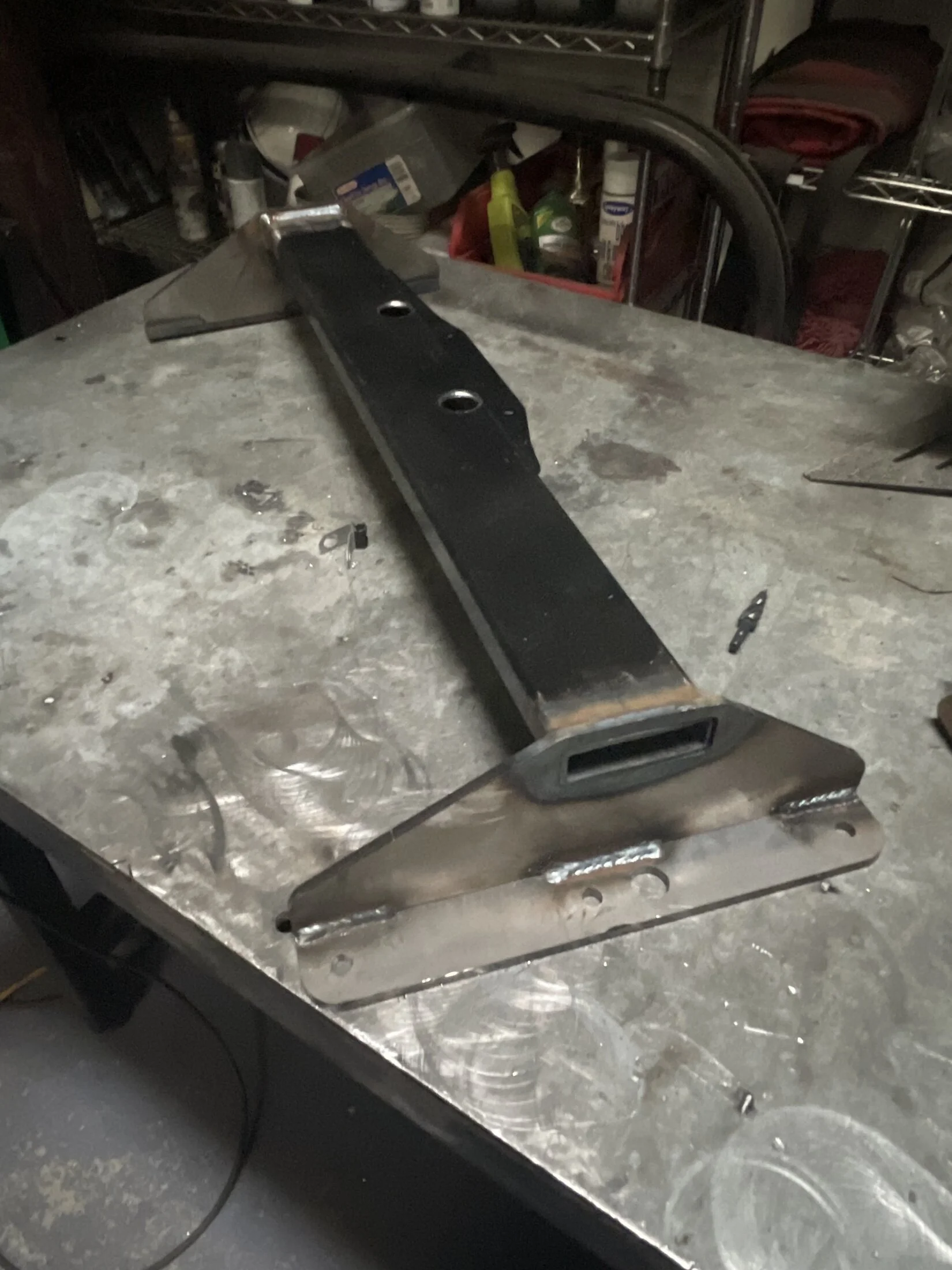

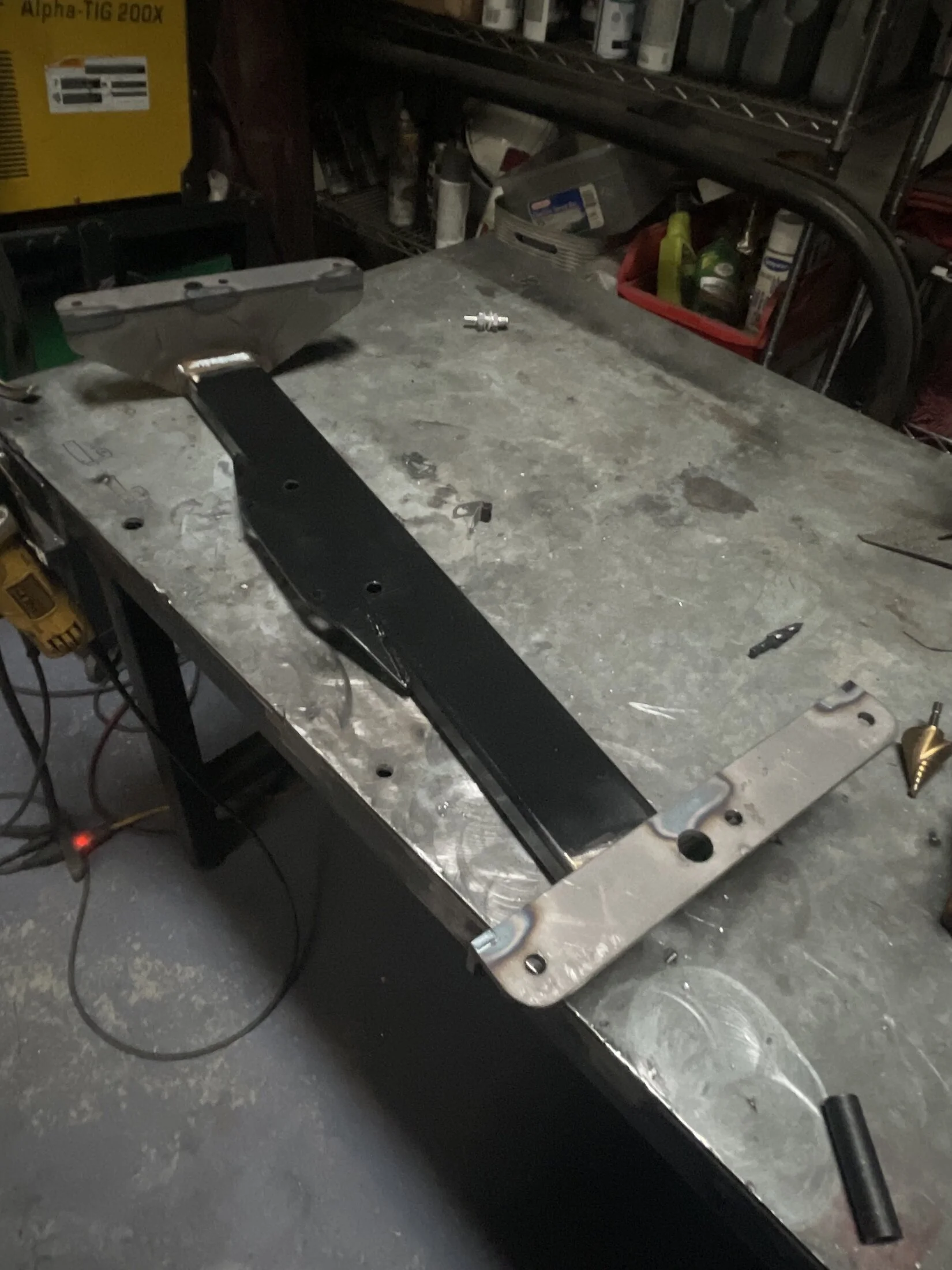

Also a crossmember for the adapter because nothing @cruisermatt does is half-ass.
