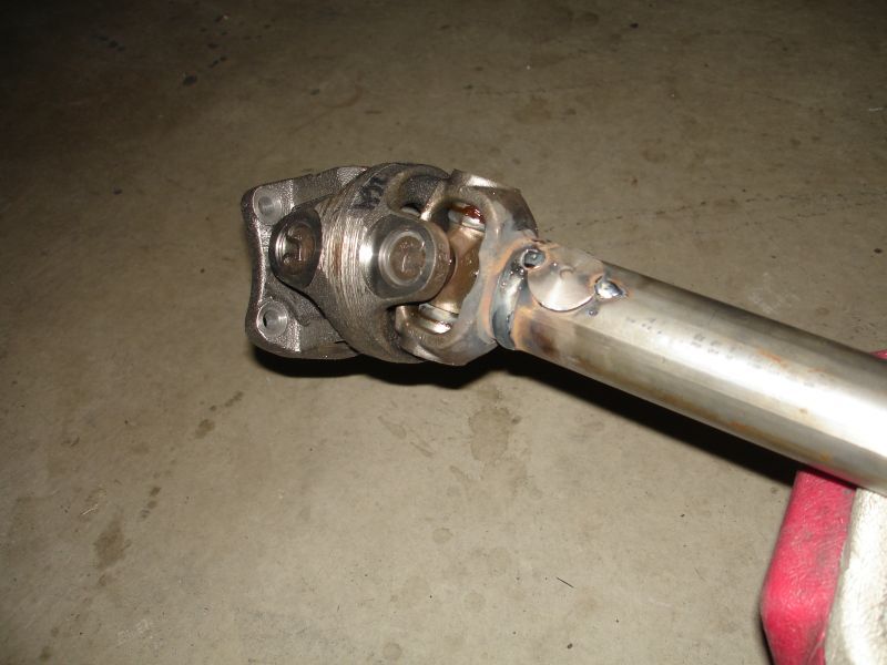

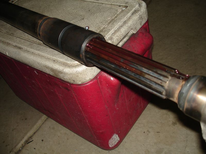

LOL...Ive been using Dean @ driveline for years, since I got into the SICKENSS. Youre RIGHT...not much in the way of customer service, but you WILL FIND that his prices CAN NOT be beat.
I JUST WENT to Bayshore yesterday to price a shaft like the one you have pictured from DLSCC...they quoted 4-500 bucks.:eek:
They were SOOOOPER FRIENDLY though and willing to answer questions. They actually told me that the mini truck DC shaft I have would be fine, but just increase the tube wall thickness. They quoted 200 bucks to re tube it IF the flange could be turned. It sounded like the have a 160.00 shop minimum.
The rig is coming out great. Glad to see youre still working on it. I had considered running my exhaust myself, but...Im gonna take it to Mr.Z's down here in Reno. It seems that it would be cheaper than what I could do it for.
BTW...this is the shaft Dean built for my front.
Its BEEF! Long slip, DC 40 some odd inches long...450 bones.
Got quoted AT LEAST 100 bucks more elsewhere. Once you get past his rough personality, he's really not a bad guy...He'll piss you off with wait times, and closing the shop early and stuff, but...his work is GREAT and like I said...his prices are GREAT!
