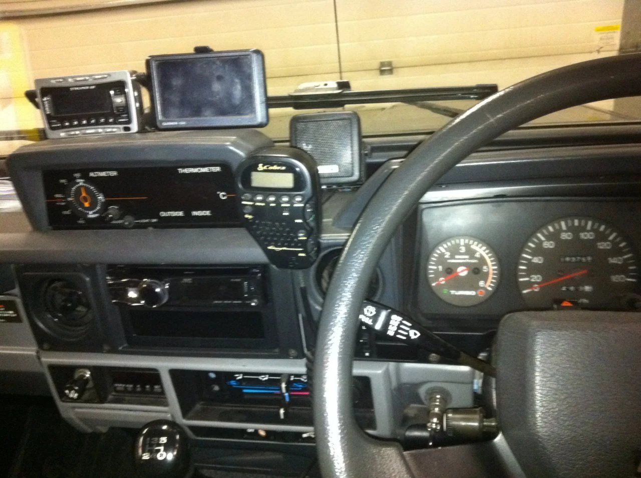

Also I am running the exact same CB and by bending a piece of 1" flat iron to the shape of the dash and securing it to a bolt at the base of the windshield frame, I was able to mount mine and an auxilary speaker in a very user friendly location
That looks great, I'll have to look into that.
