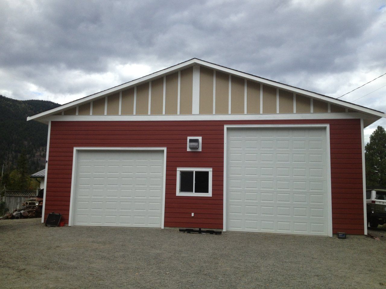

Project" I should probably get a girlfriend"

[QUOTE="Sure did, getting married this summer. And she let me build this :)[/QUOTE]
Letting you build... sounds like we know who's in control going forward....
Letting you build... sounds like we know who's in control going forward....[/QUOTE]
Damn straight.... She owns a kickboxing gym and is the head instructor. Prsonal preservation is always on my mind ;)
