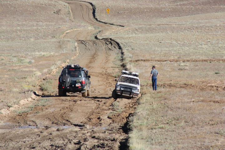

Fast forward to last weekend and I was en route from Moab to CruiserFest primarily on dirt with a group of 12 from across North America. We were not on the trail for more than an hour before we stumbled across a German tourist super stuck in a particularly wet section of the Blue Hills Road north of Moab. He was axle/fender depth mired and the road offered little in the way of traction for a snatch strap. Out came the winch. We were able to get ~100' away from him on a better section of road, we winched him every bit of that 100' and a bit more in order to get
him free of the mud's intense suction. Two thumbs up for the VR10000.
Robert, the stuck German Tourist as we get set up for winching

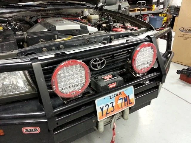

Let there be more light!
I've been absolutely thrilled with my IronMoose LED light bar but it is strictly a flood. While it offers fantastic light on slower trail conditions and as a flood at camp or during recovery... it didn't help my need for something out on the horizon. I have IPF lights on the front bumper and they had served me well, they are actually a combo set consisting of one flood and one spot. While the housings look near identical the lens and reflectors are different thus producing different light. With a single set of aux. lights in play, they were a great solution but as after adding the light bar on the rack, they lower flood became near obsolete and was literally drowned out by LED bar. The decision wasn't easy as the new ARB LED offerings are not tilted to the low end of the price scale however the technology is solid (built by Rigid) and I by far prefer the round light and easy fitment on my ARB winchbar. The ARB LED's are available in both a flood and spot configuration, as my flood needs are covered I opted for the spots. As I already had a high capacity light harness installed (OE IPF setup) I opted not to use the ARB LED specific harness rather I swapped connectors as my IPF's harness used a connector similar to a weatherpack and the LED's use a Deutsch connector. Beyond that it was a matter of swapping the lights themselves and plugging them in. Let me just say the initial testing is impressive. I still need to figure out a way to take some good night shots with the limited camera equipment/skills I have. I think they look right at home:

Let there be more light! I've been absolutely thrilled with my IronMoose LED light bar but it is strictly a flood. While it offers fantastic light on slower trail conditions and as a flood at camp or during recovery... it didn't help my need for something out on the horizon. I have IPF lights on the front bumper and they had served me well, they are actually a combo set consisting of one flood and one spot. While the housings look near identical the lens and reflectors are different thus producing different light. With a single set of aux. lights in play, they were a great solution but as after adding the light bar on the rack, they lower flood became near obsolete and was literally drowned out by LED bar. The decision wasn't easy as the new ARB LED offerings are not tilted to the low end of the price scale however the technology is solid (built by Rigid) and I by far prefer the round light and easy fitment on my ARB winchbar. The ARB LED's are available in both a flood and spot configuration, as my flood needs are covered I opted for the spots. As I already had a high capacity light harness installed (OE IPF setup) I opted not to use the ARB LED specific harness rather I swapped connectors as my IPF's harness used a connector similar to a weatherpack and the LED's use a Deutsch connector. Beyond that it was a matter of swapping the lights themselves and plugging them in. Let me just say the initial testing is impressive. I still need to figure out a way to take some good night shots with the limited camera equipment/skills I have. I think they look right at home:

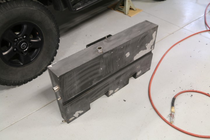

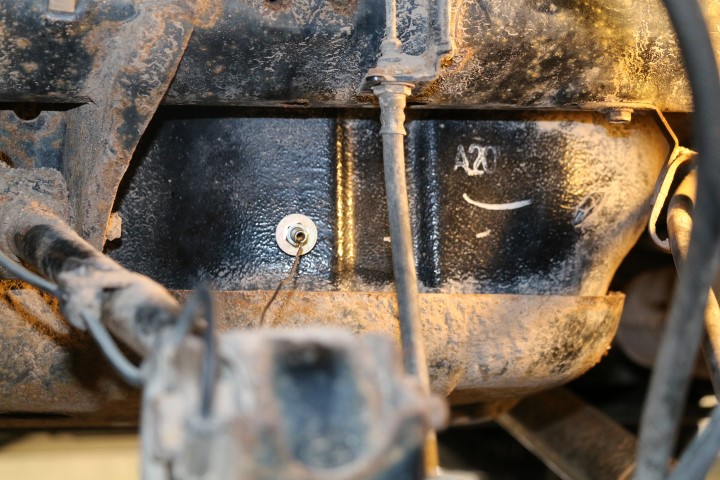

With that behind me I had a few other modifications in queue including the installing the Front Runner fuel tank I had picked up from one of the employees at Proffits Cruisers. Jeremiah had mentioned to me that Bob won a 100 aux. tank at the Cruise Moab raffle and after a few calls I figured out that it was the 62L Front Runner gravity feed tank that was originally donated to the raffle several years earlier by Paul May of Equipt Expedition Outfitters. Paul was confident in the tank as a practical and reliable solution so Bob and I were able to work out a deal and get it out to Utah. There it sat on the shelf in the shop for nearly 9 months as other more pressing projects took priority, all until this weekend. I had a Saturday morning to spare and I was able to convince Olly (my shop tech) and Jake (one of my past employees) to come spend some quality time in the shop, they took the bait. Olly and I had previously reviewed the instructions and anticipated the project taking just a few hours. We were very wrong. Between a couple of missing parts and some shall we say 'lacking' instructions, it took the better part of the day on Saturday and a few hours this morning to finish it up. In the end the extra day worked out as I was able to get some good paint coverage on the parts. The stainless steel tank's original paint was flaking bad and the more I roughed it up with scotch-brite, the worse it became to the point 1/4 or more of the paint was gone. Between the scotch-brite, fine-grit sand paper and compressed air, I as able to get the failed paint off and start priming the bare areas with a self-etching primer. I applied a couple coats of primer and then 2-3 good coats of flat black paint. I'm less than optimistic that the paint won't blow back off with the pressure washer but at least I started with a fully painted tank and access is reasonable if I need to touch it up on occasion.

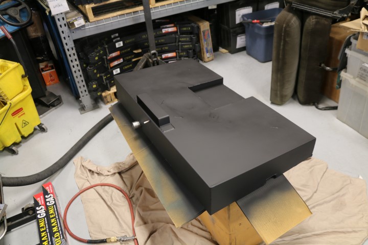

Prepping the tank for re-paint

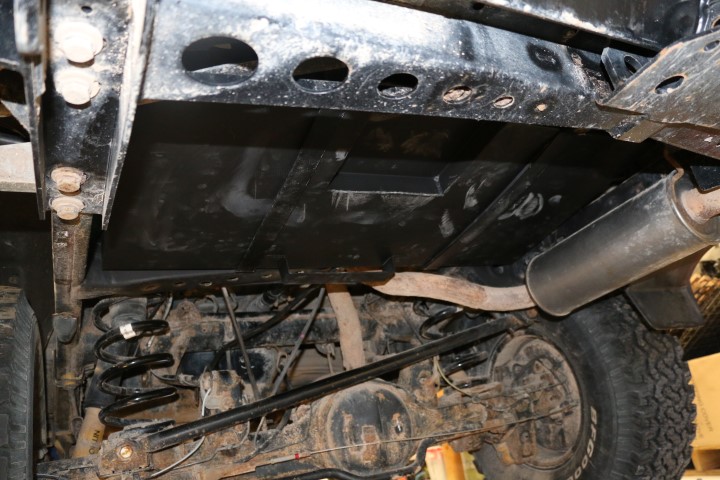

The tank mounts in place of the factory spare tire carrier and includes provisions for lowering the stock tire carrier in the event you choose to run it. I've got my spare tire on the bumper and had taken off the factory tire winch and cross-member during the original build. So while I could have utilized a much larger tank, I weighed all the options in my mind and really 62L (16 gallons) is going to work out well for my needs. Additionally, I won't be too much weight to the already heavy rear end or losing any ground clearance. A full aux tank and the additionally weight of the tank itself is roughly 150 lbs, well within the load capacity of my current springs given I'm now going to carry two less 20L Scepter fuel cans. If I find myself wanting for more fuel in the future, Long Range has a 160L auxiliary tank.
8.5mm hole in the factory main tank
Balance fitting in place

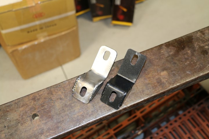

Mounting the tank was straightforward but required we clean out and re-tap 4 holes in the bottom of the body, one of which is directly above a frame cross-member leaving very little room to access the hole. The part of the project that took the most time was plumbing, more specifically adding a balance line into the lower portion of the stock tank. Front Runner includes a specialized fitting made for this application and the instructions state that it must be inserted from the inside of the tank and secured on the outside with a nut. However the inlet of the factory tank as a spring loaded 'flapper' 6-8" down the tube so even trying to fish it through with a wire proved impossible. Perhaps the non-US diesel tanks don't have the flapper and thus the lack of detail in the instructions? We ended up pulling the entire inlet/vent assembly from the tank by removing 6-7 8mm bolts and carefully separating the gasket. With that removed we had better access and could fish some bailing wire and glide the fitting it place. In hindsight, I'd likely drop the entire tank which would provide easier and safer access. We cut the factory fuel neck as directed by the instructions even adding a 1" or more of 'cushion' room as a second cut is always easier then too short. However when we went to test fit the filler system, the provided hoses were not going to work as they were shorter than the instructions part list specified which was already 1/2" shorter than we wanted ideally. It simply wasn't going to work. Fortunately NAPA had a 12" section of fuel fill hose in stock and we were back on track, thanks for making a quick parts run Jake! Somewhere along the transport, one of the mounting brackets for the tank came up missing. Its design wasn't anything difficult to duplicate but it took some time to recreate the bracket using our sheet metal brake and weld gussets into place for a near identical mount. With that behind us we went back to watching paint dry, literally. :D
Reproducing the the tank bracket
Painted to match
This morning we were ready to rock and roll and in just a couple of hours we had the tank mounted, finalized the plumbing and were cleaning up tools. Thanks again for spending a couple of your days off helping Olly :cool:
Tank paint completed

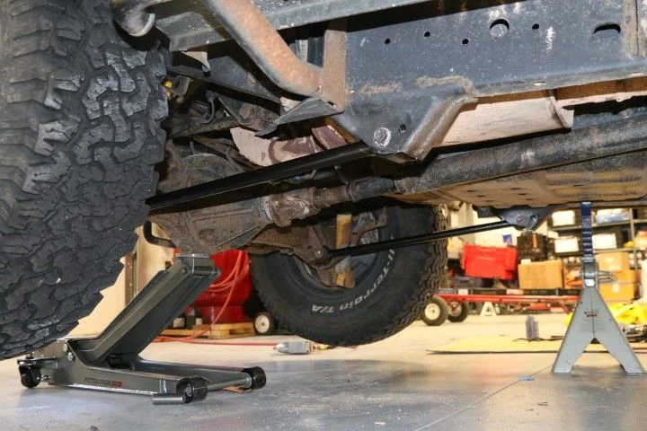

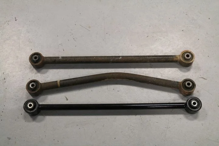

Now, back to mods for the hundy. During our quick Swell trip, I pulled a total rookie move landed on a control arm. I was making a 3-pt turn and rolled a rear tire up on top of a rock, wasn't centered up on it perfectly and I slid down, landing on my control arm with a heavily laden 100. All 4 tires were firmly on the ground but it was just enough anchor to require a quick tug. Low and behold I bent the control arm so it was time for an upgrade. It just so happens Old Man Emu released control arms for the back of the 80/100 Series recently and I had a set sitting on the shelf :D
Swap was super easy, 4 bolts. It literally took more time to pull it in the shop than it did to swap them.

Stock on top, bent in the middle and the new HD model on the bottom. While the HD unit is actually a slightly smaller diameter, it's solid HD metal and uses poly bushings and a sleeve versus the stock rubber bonded style.
The finished product:
