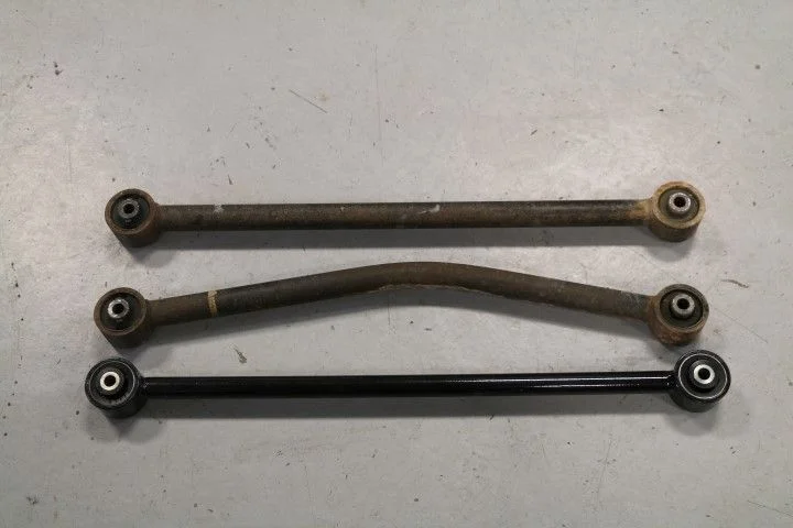

Now, back to mods for the hundy. During our quick Swell trip, I pulled a total rookie move landed on a control arm. I was making a 3-pt turn and rolled a rear tire up on top of a rock, wasn't centered up on it perfectly and I slid down, landing on my control arm with a heavily laden 100. All 4 tires were firmly on the ground but it was just enough anchor to require a quick tug. Low and behold I bent the control arm so it was time for an upgrade. It just so happens Old Man Emu released control arms for the back of the 80/100 Series recently and I had a set sitting on the shelf :D
Swap was super easy, 4 bolts. It literally took more time to pull it in the shop than it did to swap them.

Stock on top, bent in the middle and the new HD model on the bottom. While the HD unit is actually a slightly smaller diameter, it's solid HD metal and uses poly bushings and a sleeve versus the stock rubber bonded style.

Curious why you didn't go with a high clearance model with a bend in it?
Good question, my answer is a couple reasons. This truck has been wheeled quite extensively in the past 18 months, literally 5k+ miles off-road throughout the Western US and MX. I felt this was a rather isolated incident and the HD option used will be that much better. I have other rigs for rocks. The other reason, I have these on the shelf and have been very happy with their performance/longevity on customer rigs using them.
You really get out there and use your rig (fully loaded as well), so I think your opinion is well founded. I am a fan of OME too and have thought about what I'll do if/when I bend one, so thanks for your input.
