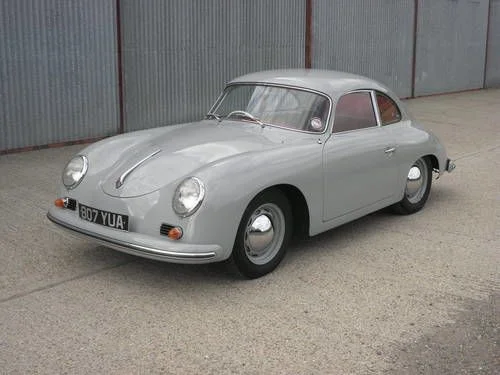

Amazing builds. Really look forward to seeing them done. Re:colors - my other interest is old Porsche’s - so one of the colors I have always liked is the 356 Modegrau.
