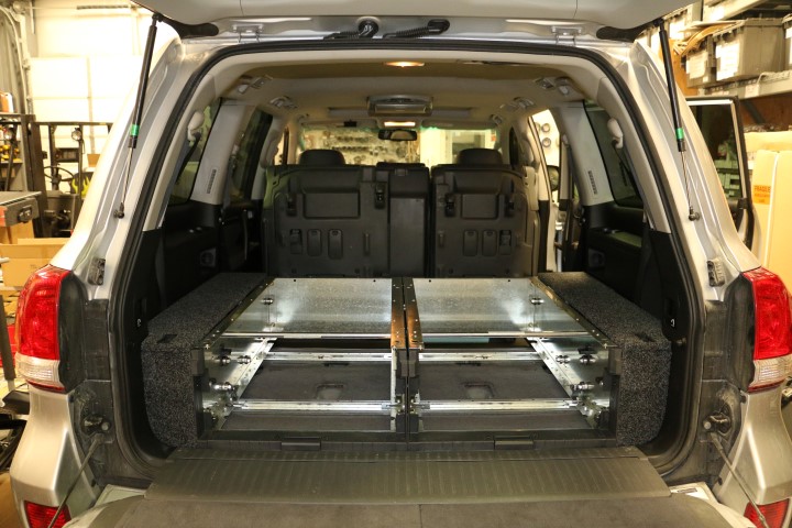

Stage Three Continues - Drawers
My buddy Dave is a fellow 200 Series owner and recently installed a set of Outback Drawers in his 200. He had actually purchased them along with a 100 Series fit kit for his UZJ100 but it went on to a new home before he mounted the drawers so he mounted them into the 200. At the time there wasn't a 200 specific fit kit here in the US so he used the already purchased 100 fit kit and cleanly modified it to fit the slightly different side profile of the 200. His install was super tidy but he was still curious about the 200 fit kit, just curious enough to help me install my drawers this evening. :cool:
Start to Finish
The install went pretty smooth. We've installed a handful of drawer kits in the shop and Dave did his not to long ago so most of it was pretty familiar to us. We varied a bit from the instructions. They have you assembled the two drawer frames outside of the vehicle and then install together. However not only are you dealing with a bulky frame, it's a VERY tight fit in the 200's and I found it easier to install on side with the bolts loosely started and then install the second. With both loosely fitted we can them mount them together and true them up. It worked perfectly and we had it finished up in just about 3 hours total including some vacuuming/cleaning before hand and some BS time through the middle. I've got a couple of things to work on back there yet to come including 12V/USB outlets and mounting/wiring the fridge. I need to spend some time laying out my electrical wants needs for the entire vehicle so I can knock it all out at once rather than have wires heading every direction twice. I'll save that for another day.
Start to Finish

The instructions seemed to have improved over the years. I know when I put them in my 100 Series it took 5 guys what seemed like 8 hours. Of course it takes 5 guys 8 hours to agree how to rotate a tire too :D We've since done full 100 Series installs in under 2 hours here in the shop with two guys that have done multiple sets. I think we could do a 200 even quicker as the drawer bottom hat's are all set in the correct locations and rear Dickie seats come out with 6 bolts.

Yes, the RD1045. 41x21x11". I'll acutally measure the ID's in the 100 tomorrow as it has the RD1045 and a RD1045 which has a slightly lower inside height due to the roller top floor. Might be better info to offer plus I need to clean it out... from Baja last month :eek:
Would also love to see if the 2nd row folds down as close to flush with the drawers as my 100 series did...as it makes a great sleeping surface if it's as flush/level.
They absolutely do and I plan to sleep there too! Dave (local customer, racemate and pal) has spent a month worth of nights sleeping on his drawers (200 with one RD1045 and a shorter drawer on the left), works great. I've slept 100+ nights in my 100 setup, absolutely love it.

Same exterior dimensions but as the top deck (roller floor) mechanism has t0 fit in there, you have a bit less usable room in the drawer. The boxes themselves are likely the same, I can't recall (will measure) but you can stack the RD1045 a bit taller than the drawer (perhaps 1") without worry but the RDRF you don't have much room above the drawer sides or you'll snag opening and closing either the drawer or the floor. Clear as Mud?
