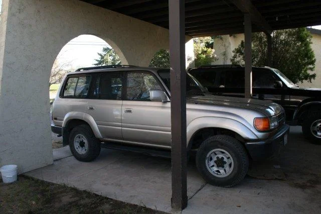

and about a week later a cheep fj80 dropped in my lap.. with a overheating problem..( turned out to be a radiator hose behind the powersteering pump..) motor was fine even drove it a while.. then took it apart..
here is the 80..

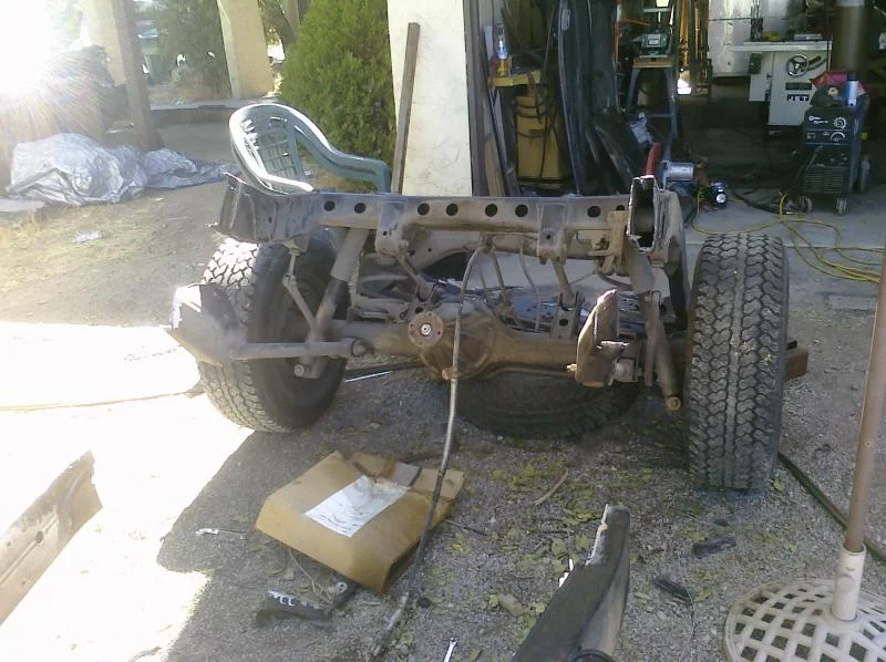

sold the parts .. and got some spares for my other two fzj80's...
combine that with my wore out 72 fj40 and we have a cheep lift that will support 35's and disc brakes and coils .. and since I needed body work on the fj40.. we will just add a little to stretch the body..

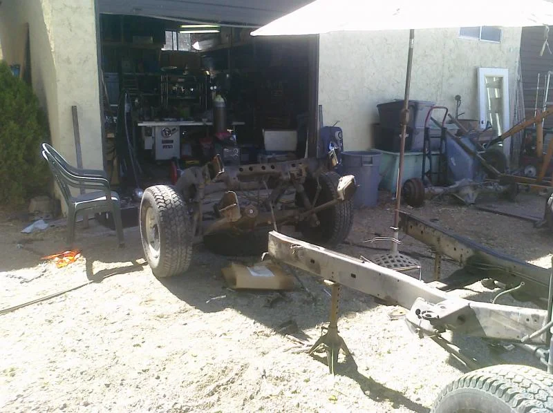

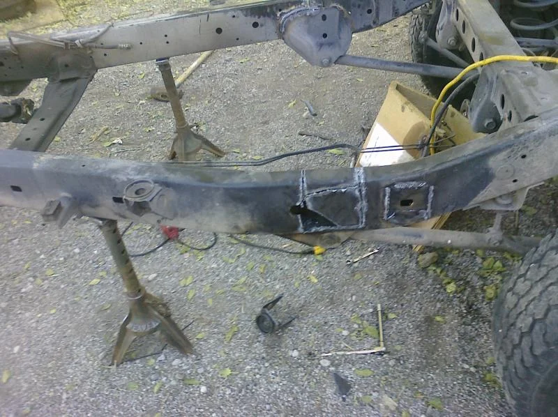

so today I started with the torch on the fj80 frame.. cut off the rear control arm hangers and then made initial cuts on the frame.
the goal is to shorten it 8" like IPOR did and then stretch the body... marked the inner and outer frame cut at different points will also reinforce where the splice it with some c reinforcment inside..
