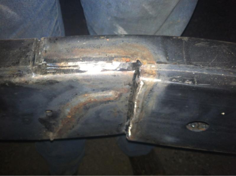

so I finished working on the frame, taking 6" out of the middle..
I know others have shortened an fj80 frame but this is how I did it, first remove the lower rear control arm mounts, then mark the frame for the rear cut I started on the outer 4 inches behind the inside joint on the boxed frame there is a reinforcement on the inside of the box, I cut with a die grinder there making sure to not cut the inner reinforcement. Cut most of the way thru then use a chisel to split it and clean with a grinder.. at the same time I took the weld off the inner joint and the top and bottom of the frame rails, this gave me a 2 piece frame.. then shorten the inner and outer square it all up and if everything is right 106" wheelbase, I ended up a little shorter 105 3/8" but I think that is due to no weight on the frame because I removed 6" and both sides are even..
the reason for keeping the inner reinforcements is one strength and two it helps align the frame when you put it back together. I am still going to make an outer c reinforcement extending 3-4" ahead and behind the weld joint, for some extra strength..
Some pix, I'm still fitting at this point, alot more grinding to do.. but gives you an idea where I cut and the way it fits..I cut about 1/4 an inch long on both sides then fitted from there you can see the score marks in the pix of where I marked the frame before i started..
hope that makes sense, the inner and outer weld are 4" apart, the outer will have a reinforcement when I'm done and the inner will be reinforced by the control arm mounts.. May take it over and put it on a frame rack before I finish welding it all up.. just to double check, but everything is square and even. Planning and marking/scoring everything paid off, took some time to lay it all out but it fit up nice..

Why would you make a vertical splice section on that frame???
Radius of AT LEAST a diagonal splice would have made it stronger, dont you think???
looked at a 45 splice or a z, the inner already had a lip splice just moved it forward, on the outer, there was no real way to do it like I wanted with an inner sleve,
I have some metal the same thickness going to bend a C going 4 inches a head and behind the weld and 45 the ends and plug weld it, will give me plenty of weld area and it it will be stronger than it was before,
