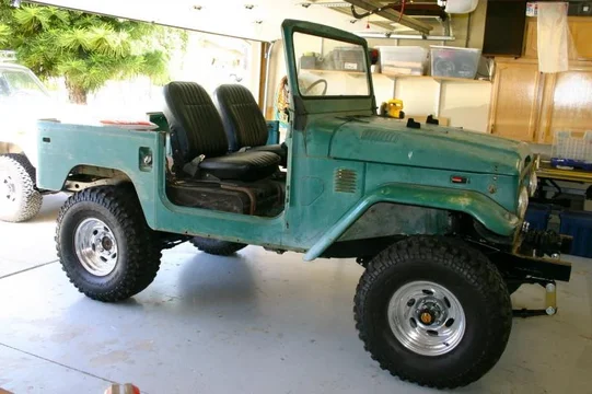

New Shoes. Before and After
What do you guys think about these 33 x 12.5s A friend has this used set for sale and they look like a great fit. BFG Mud Terrains. hopefully they are not too loud on the pavement. ultimately i would like to go with a different tread pattern, but these might work for a while.
Opinions?

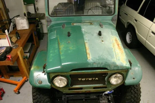

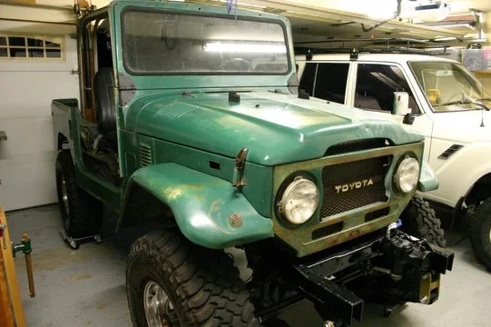

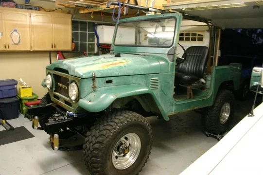

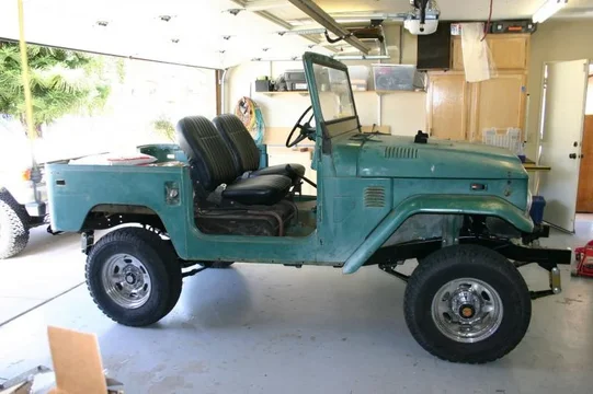

Patina; awesome or not awesome??
Hey Guys,
looking for some opinion here. since I have been working on this project I have been convinced that a full re-paint is going to happen at some point. since it has started coming together, the stock paint has begun to grow on me.
i took a few minutes tonight to try to knock off some of the oxidation and see what it would look like if it was cleaned up a bit, and i think it is looking much better.
what do you guys think? would it be a shame to blast it all off and repaint. I think it may have a little more character as it is.
The biggest question on my mind: is there any way to stop the surface rust from spreading? it's not likely that it will spend much time in the rain other than the occasional back country trip if we get caught out.
here are some pics. Opinions welcome!
before
after
side by side
I saw in another post a guy used CLR to clean his rig. It was AMAZING! Perhaps try that out, then shoot a satin clear over the top to preserve it. ???
:beer:
A purist would tell you to keep the petina, but since this isn't a purist's dream I would go for the repaint. You have a lot of time and effort into this rig so why not take every precaution to keep it preserved? I would completely strip it, treat all the seams you can get to then repaint in your favorite OEM color. I would also drill a small hole in the inside of your rocker panels and spray some frame saver in there as well as your main tub spar. Since you wont have the panels off you can access the spar from underneath. There are several holes there for draining that you can insert the sprayer through. BTW I love the build. I have been watching for some time now and it makes me want a vortec for mine. Keep it coming and more pics please! Nice work!:popcorn:

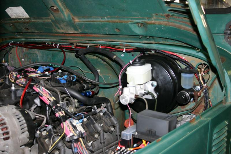

A little brake help
Hey Guys,
have a question for you brake guru's out there. so, here is the setup.
1. stock drums in the back
2. disk brake conversion in the front, new rotors, calipers, pads, lines, etc.
3. early 90's 4 runner brake booster and master cyl.
4. summit racing proportioning valve.
First of all, the brakes have tons of stopping power, its amazing how much force they generate even with 33" tires.
i am currently limited to the high school parking lot (still no exhaust yet) but i am finding that even with max reduction in pressure to the rear with the proportioning valve, the rears are still locking up before the front. without the prop valve, the rear would lock up with the slightest touch of the pedal.
possible causes:
1. little to no weight in the back.
2. rotors/pads are not broken in (i probably have less than 1 mile driven on it yet)
3. drums are not adjusted correctly (is there an adjustment for this, or are they self adjusting?)
4. something else??? Opinions welcome. Thanks.

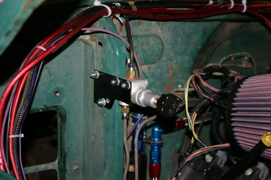

Proportioning valve
booster/master. booster is reman, MC is new
no weight in the backend
Sounds like a drum cyl adjustment issue. U can adjust them from the backside with a screwdriver.
First check to see if u can freely turn the drum by hand with the wheel off. I would guess u can't. U should feel a very slight resistance when spinning the drums. Adjust the cyl until u achieve a slight resistance.
If they feel fine right now, then maybe the prop valve is not working as fully as it should.

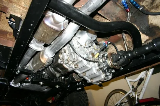

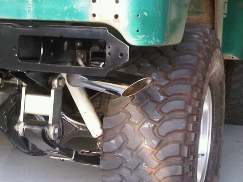

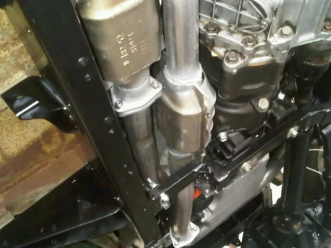

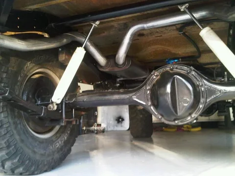

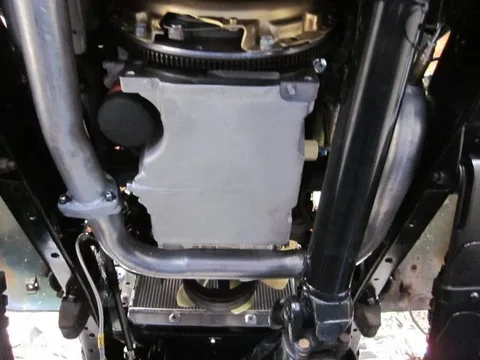

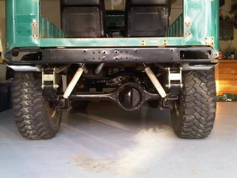

some updates- exhaust
It's been a while, have been making some headway, but have not had time to post results. have a little time so ill post some pics of several things i have been working on.
Got the exhaust squared away a few months ago. Took it to Ed Hansen in San Diego. his guys did an awesome job.
Had to route the pass. side exhaust around the oil pan and back down the driver side.
two cats under the cross member.
magnaflow, 2 in, 2 out with x-pipe inside

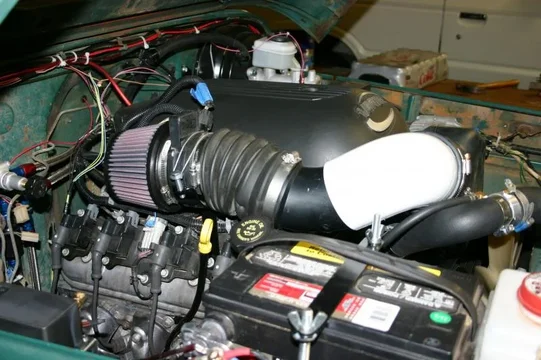

Air cleaner details
Here are a few shots of the final air cleaner configuration. Got the rubber 90 from a buddy here on Mud, i think its call the Cobra. The white 90 is from home depot. and the flex line is part of the OEM chevy setup. cut it down and make a bracket that mounts off the valve cover.

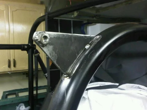

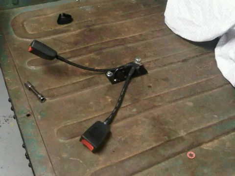

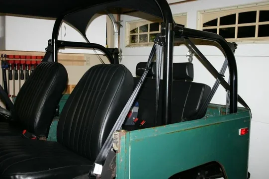

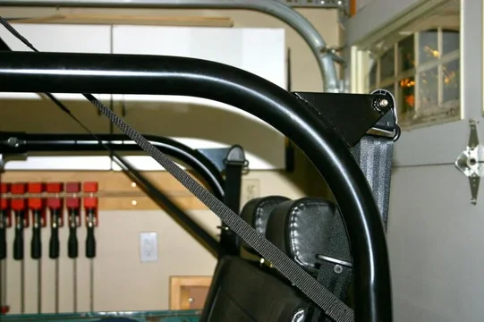

Shoulder Seat Belts. x4
Finally got all the parts together to convert to shoulder belts all the way around.
the fronts were a piece of cake. 2 of the 3 bolts fit the oem brackets, the third (to mount the box) only took a few minutes to fab a 90 with a couple holes.
i ended up welding a small section onto the roll bar to make the belt sit in the right spot. The bolts are a wierd size. 11mm. i think i ended up welding on some nuts from the front knuckle rebuild. i replaced them with new.

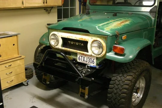

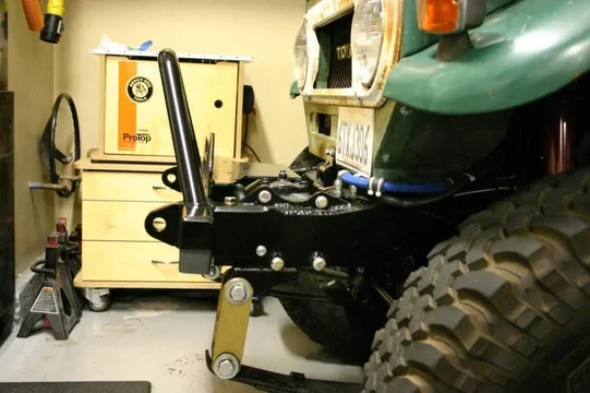

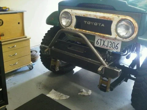

Front Bumper
I saw an article on this bumper several months ago in Toyota 4wd owners magazine.
http://www.redlinelandcruisers.com/assets/documents/RedLine40Bumper.pdf
I really liked the simplistic and strong stance this thing has. i though the price was really reasonable too. if i recall shipping was only about 30 bucks.
Here is a shot of it un-finished
With a couple coats of rattle can.
I did have to make an "adjustment" i specified the width exactly, but it was about 1/8" off, (too narrow) so i had to slice off one frame mount and re-weld it back on. no big deal, solid as a rock, and it fits perfectly now.
