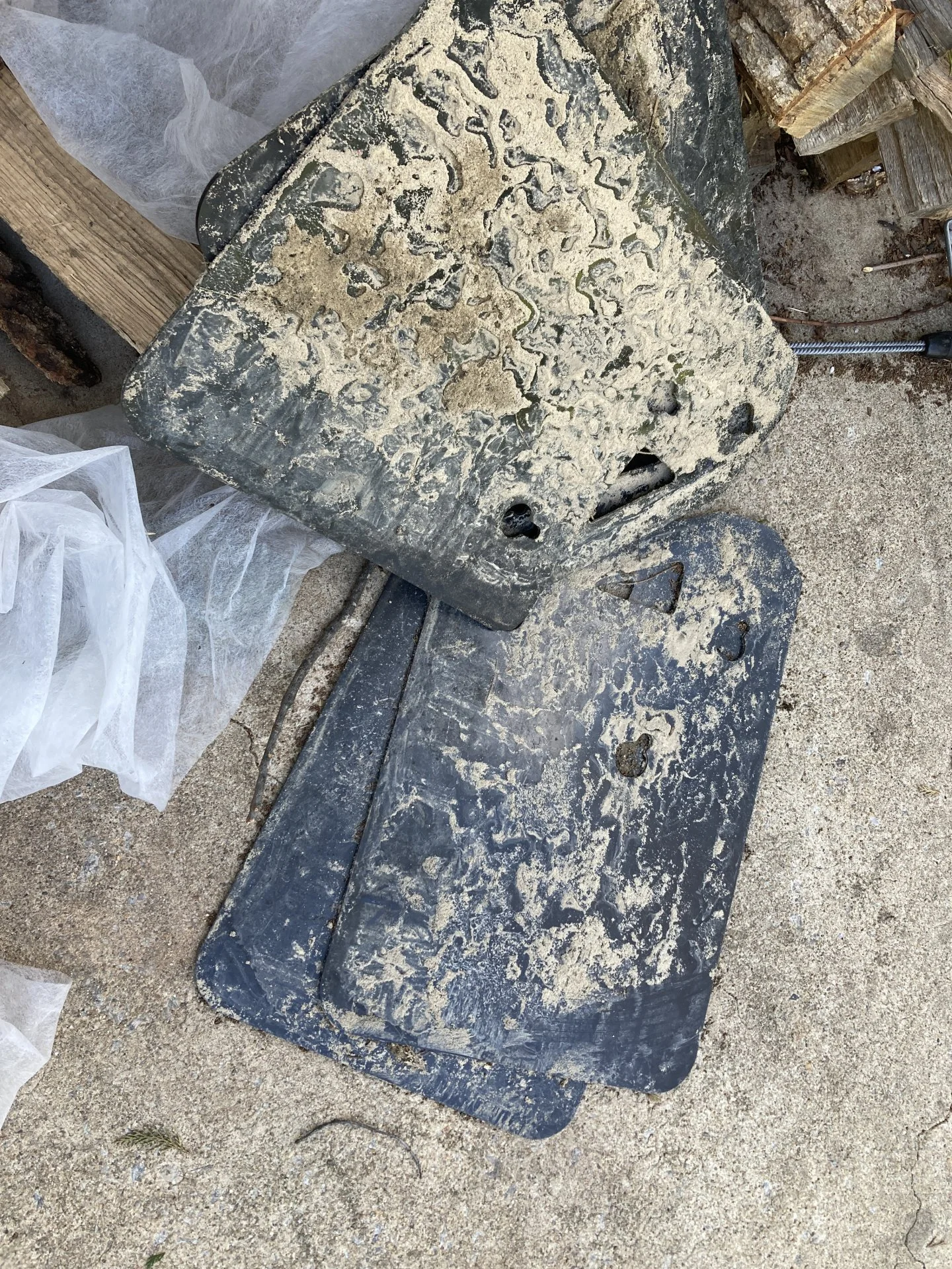

Nope—I think to damage them you’d need to be in a pretty tight spot with rocks or mud behind your wheel and would then need to use reverse. Probably many a trail run could be done with them in place with no issues.
But I should have thought to pull them while I was standing around waiting for my tires to air down….don’t let my absent mindedness keep you from pulling the trigger!

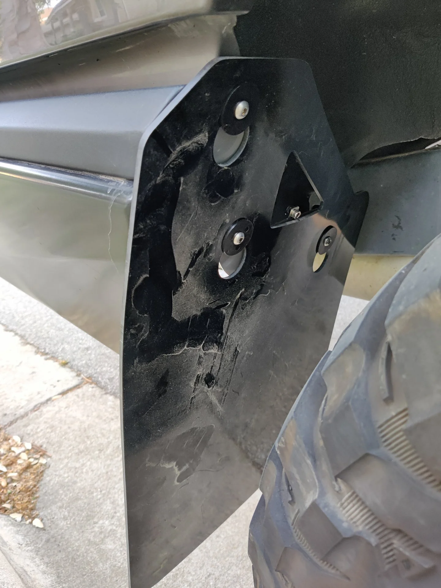

As @mdcoa mentioned, they are pretty hard to actually break. Usually a reverse scenario up against a big rock. I also intentionally used plastic washers to hold the flap on, so they should tear away in a scenario like that before doing any damage. You just have to make sure you notice and retrieve the flap.
I actually forgot to take them off a couple years ago when doing some heavy rock riding. I came off a rock step and the front flap got pinned between the slider and the rock. It was too late at that point to remove them as the whole weight of the truck was pinching them (front wheel off the ground). I kept moving and the urethane slid on the rock until I cleared it. Figured I'd destroyed the urethane, but it was perfectly fine minus some scratching. They probably helped me slide off the rock easier lol. These things should outlast these trucks which is saying a lot.

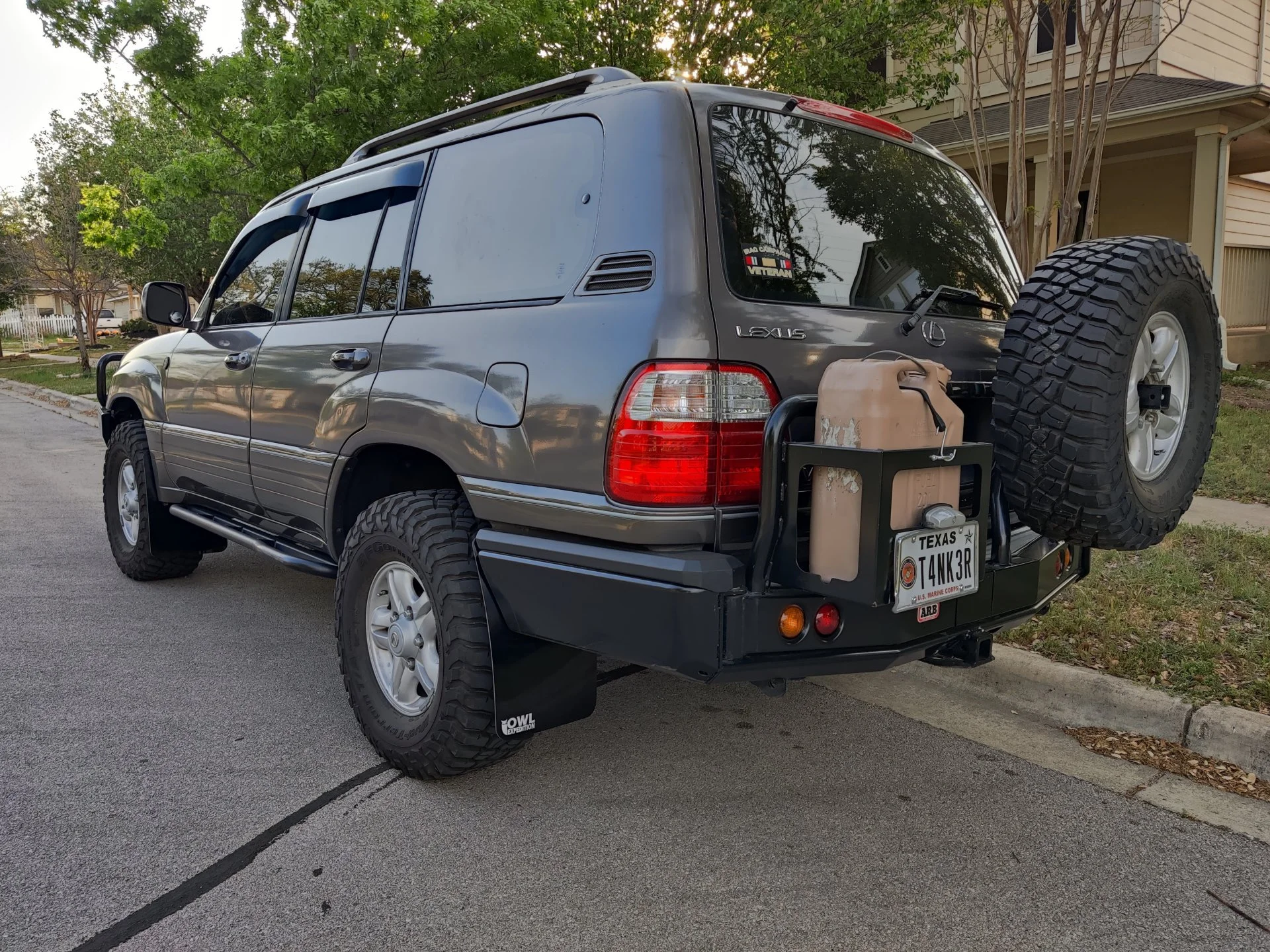

Alright, boss had an emergency come up and had to cancel dinner so I got home and installed the ASAP Flaps. Here's my initial impressions:
Holy crap, these things are quality! The flaps themselves are nice and thick and all cuts are crisp. I noticed the mounting brackets were super sturdy, but even moreso once installed on the truck. They are solid, period. All hardware was there and they even included 3 extra nylon washers and spacers. Perfect if you forget to take them off and happen to rip one out, which I imagine would only be a one time thing and so 3 spares is perfect.
I downloaded the instructions and the install went super smooth. Mine is an LX with the body cladding and so I was a bit disappointed to see I'd need to lower my sliders to get to the bottom 2 bolts, but I pushed on. What I found was that by simply loosening the forward most bolt under the cladding it gave me just enough wiggle room so that I didn't need to mess with my sliders.
These worked great on my ARB rear bumper, but it wasn't until I installed these that I noticed it sits a little too far forward (into the wheel well) on the drivers side. Oh well, the flaps went on just fine anyway.
I took a drive to the store after getting them on and heard a bit of rubbing as I was braking, the flaps contacting the turning rear tire, but they didn't fold up. I'll keep an eye on that and report back if it becomes cause for concern.
In short, I love em. They make the truck look so much more well rounded and I feel like a much more responsible MT owner knowing I'm not gonna be flinging rocks up on cars behind me. I've got a trip out to Big Bend coming up in June with plenty of back country driving in store so I'll be putting them to work. Can't wait!

Glad you like them and everything was there! I constantly second guess myself if I remembered to get all the hardware in the box. The LX install is more tedious, but once it's done you never have do it again. If for some reason you decide to scrap the flaps in the future, you can just use the bolts to hold the cladding without the flaps/brackets.
It's very unusual to have rubbing in the rear. Since it's one side, part of me wonders if your bumper is installed crooked. Hopefully you can get it sorted as the rear shouldn't rub even at full stuff.
