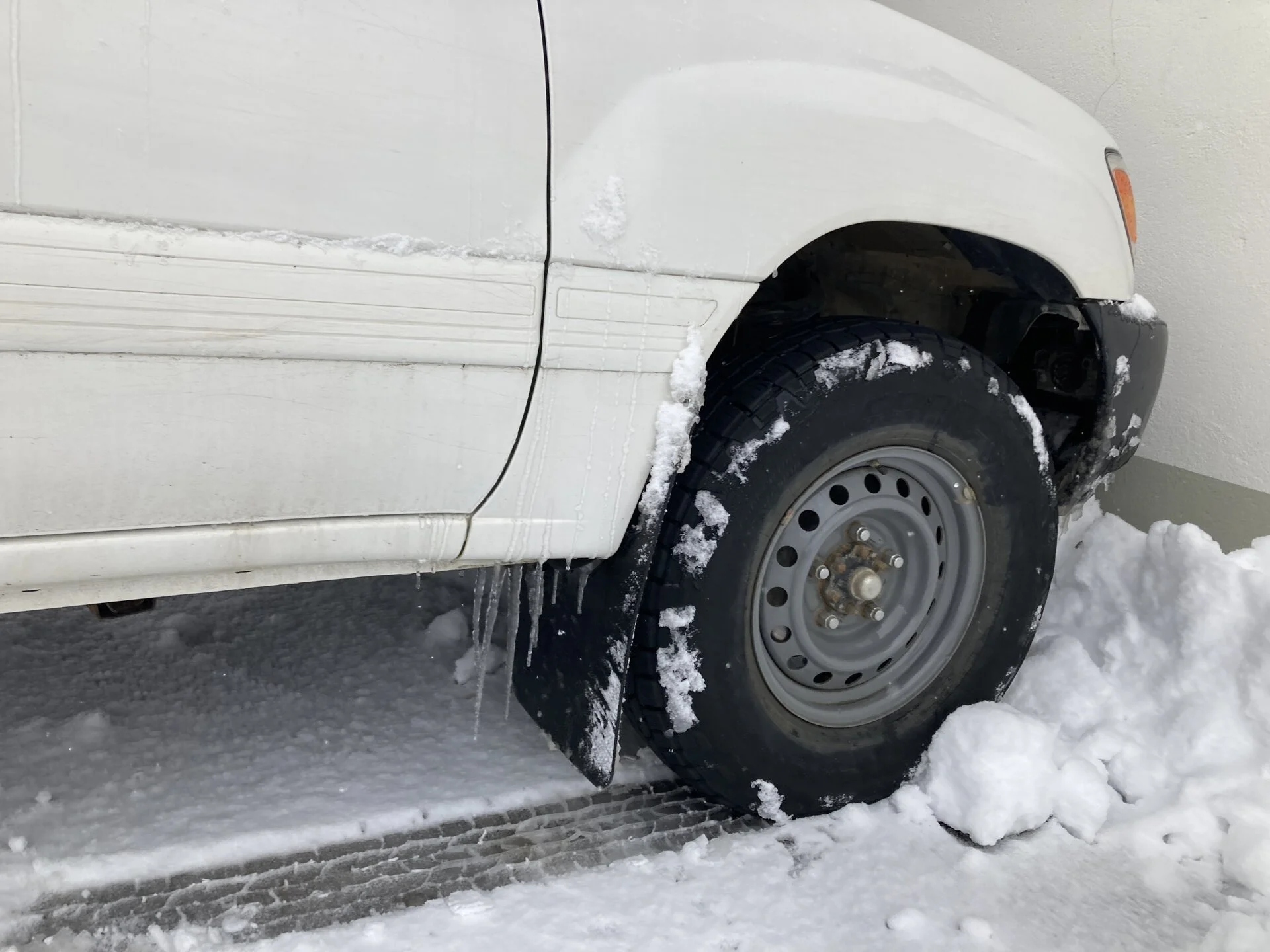

Love mine so much. Lost a front one in Morocco last month—let’s me contribute a “with/without” contrast here in the French Alps, where we got hammered with snow earlier this week.
These things do keep significant amounts of crud off your body.
