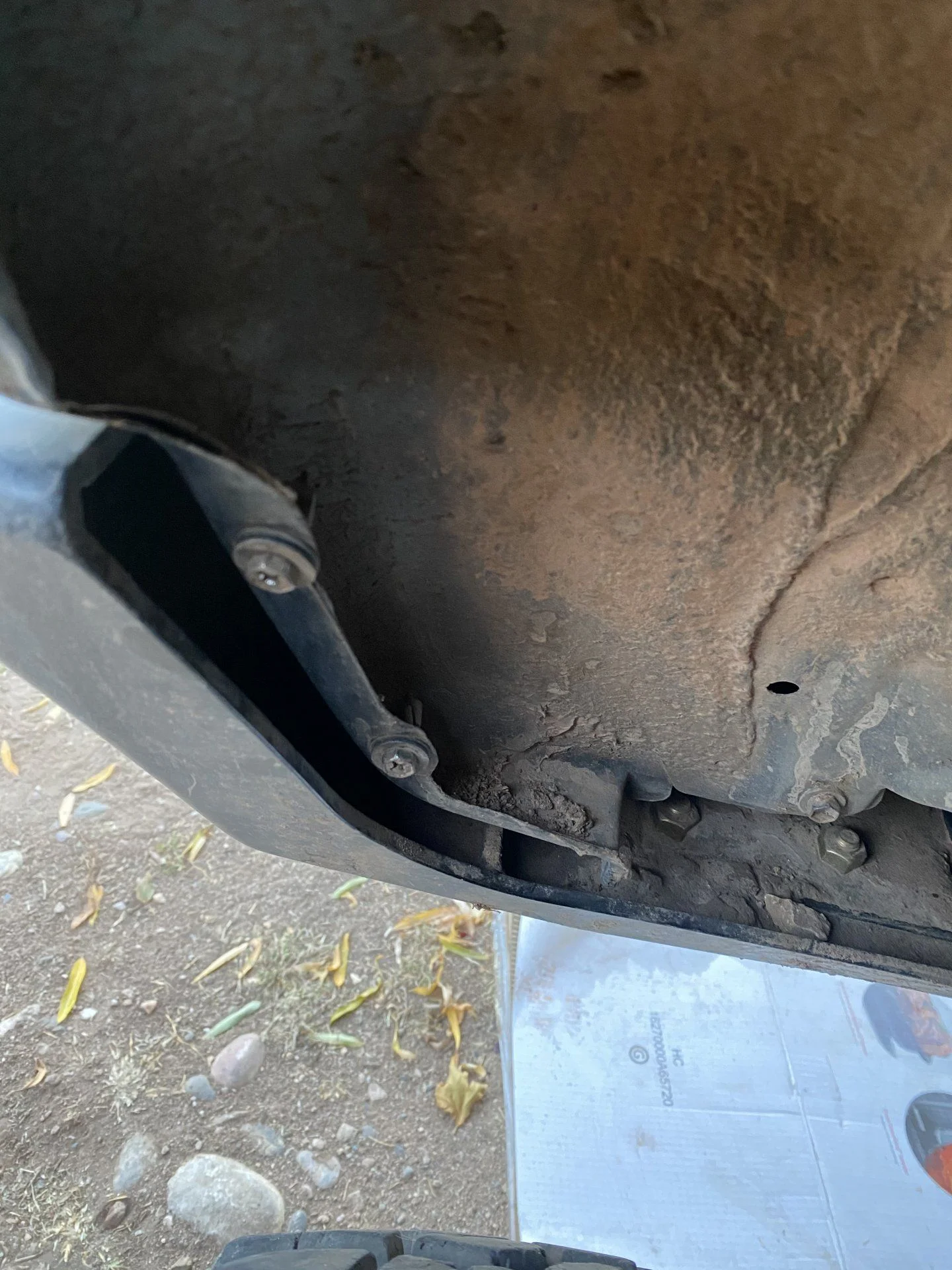

It doesn't seem like anyone else has had trouble, but I'm struggling to get the flathead screws to fully engage with the extruded nuts on my LX470. A couple of them went in fine, but the rest don't want to go in more than about halfway.
Edit: I'm thinking it's probably my angle of approach, my tires are knobby so it might be easier to remove them to get everything lined up.

I had a lot of trouble and even stripped a bolt and nut. They have to be at the perfect angle to engage. Wiggle and loosely spin the bolt until they engage and then spin them down.
One thing that I should mention in the directions (sorry!) Is that sometimes the black coating on the nuts is thick and makes starting the bolts for the first time difficult. It's easier to put a little wd-40 on the nuts and run the bolts in before installing them just to take off the excess coating.

Just as an update I was able to get these mounted this morning. I ended up using some other spare clips I had, running the screw through them first to make sure they seat before attaching them to the bumper/body made things much easier. Thanks everybody!

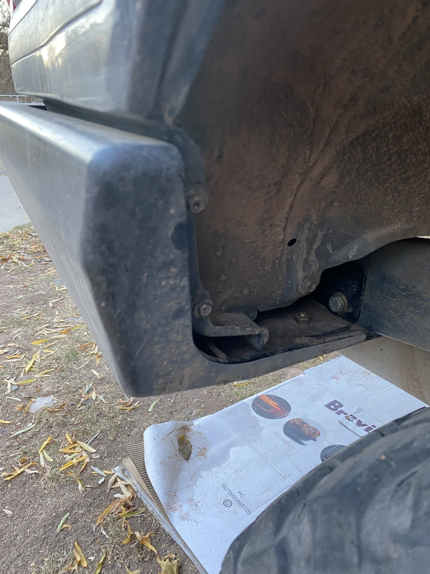

If anyone is looking to get a set of the ASAP flaps that I just purchased in the last group buy send me a pm. I was really hoping these would work with my aftermarket rear bumper but it doesn't seem like they will. The price will be what I paid for them plus shipping.

It’s like the bumper extends a little past the rear wheel well to far. I can’t see a way to get the bracket on and still be able to slide the mud flaps on it off. If you guys have any tips I’d love to hear. I would like to keep them if possible. The kit I ordered from owl was for the after market bumper

I posted several pictures in this thread. A few pages back. That guy installed his bumper differently than I did. My bumper lines up flush at the wheel well like factory, his looks a good inch or so into the wheel well.
Mines aluminum so maybe that’s the difference. Oh well
