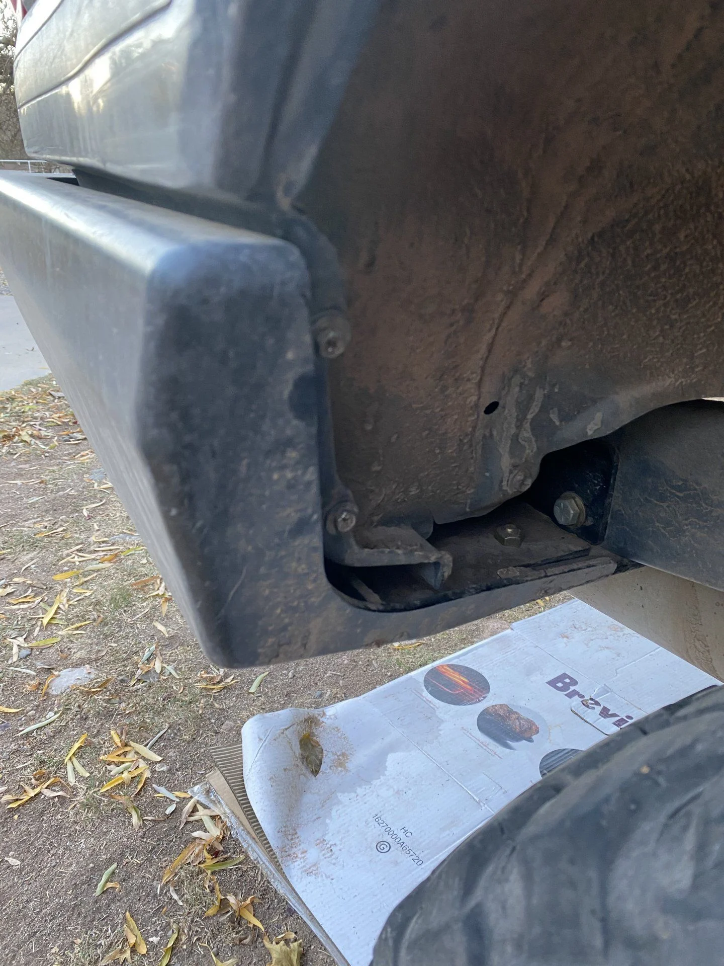

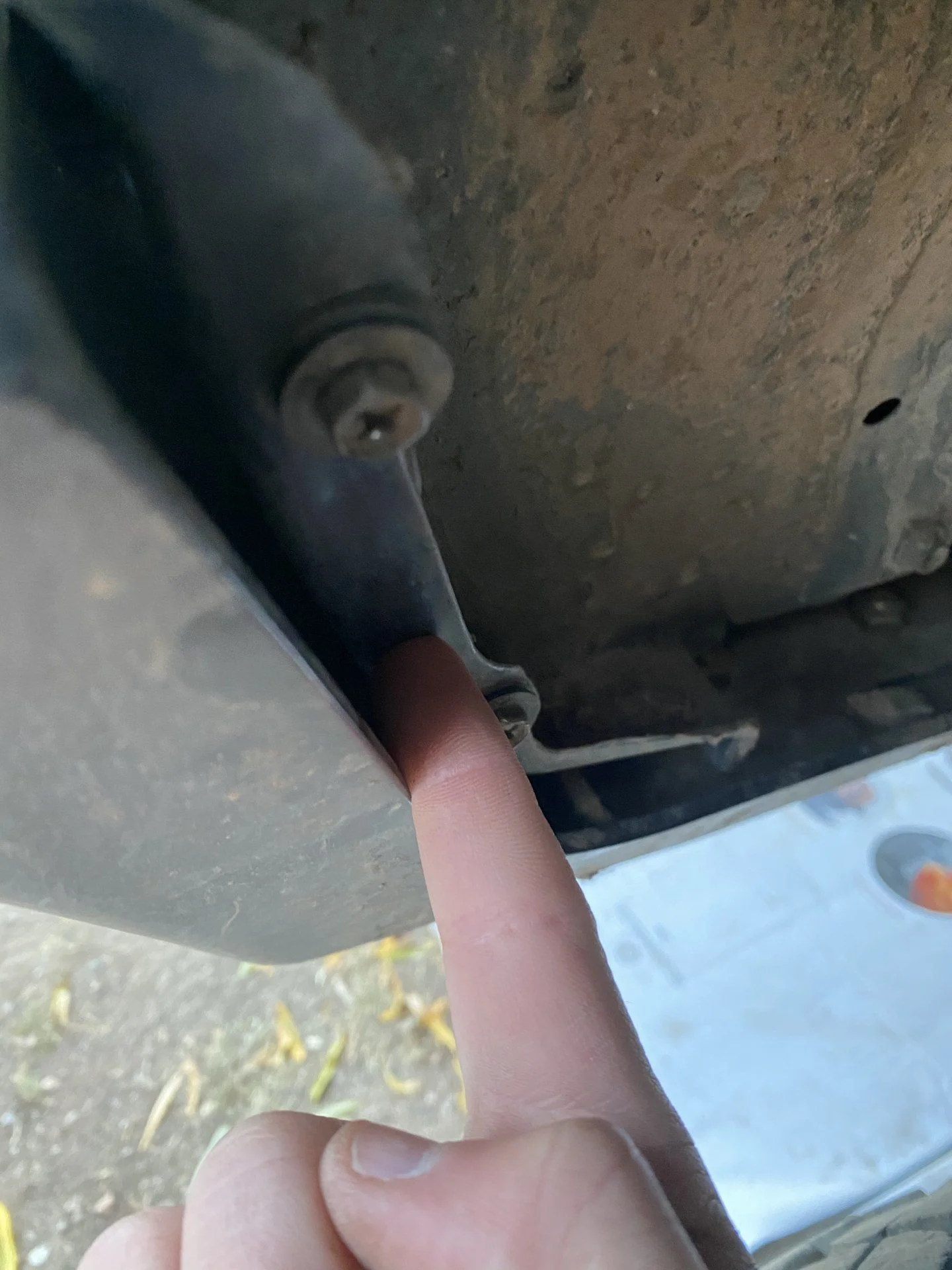

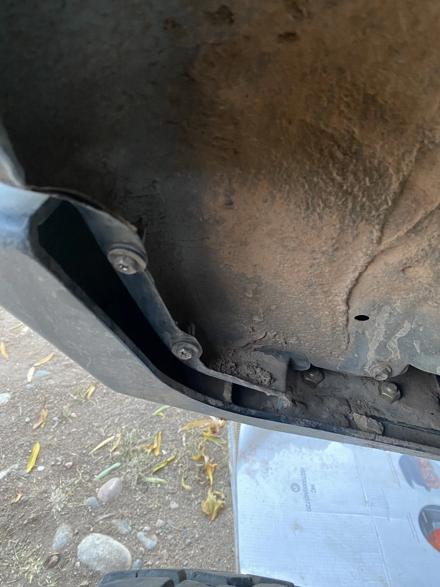

It’s like the bumper extends a little past the rear wheel well to far. I can’t see a way to get the bracket on and still be able to slide the mud flaps on it off. If you guys have any tips I’d love to hear. I would like to keep them if possible. The kit I ordered from owl was for the after market bumper View attachment 2518011View attachment 2518013View attachment 2518014
Shoot! Ben must have changed the design slightly. The flaps could still work though! You would just need some spacers (and possibly longer 1/4-20 machine screws) to bring the bracket flush with the bumper. Many do this with the BIO bumper and everything you'd need can be had for like maybe $10 at Lowes or HD.
