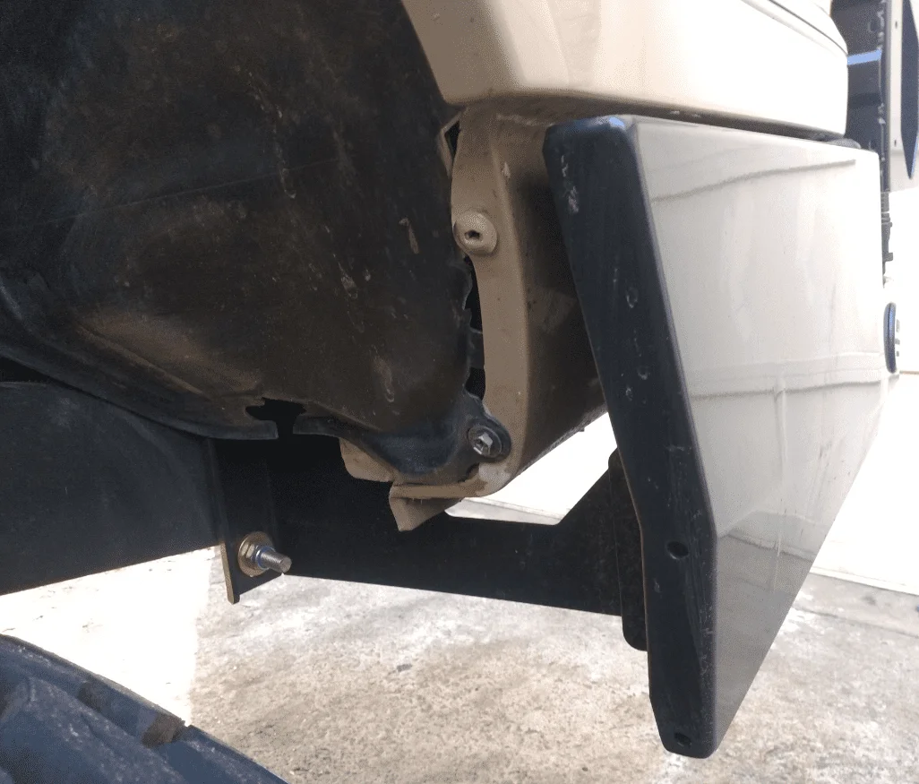

Here's a picture of my rear Dobinsions. No idea how this compares to anything else. I guess the aftermarket type is what I need?

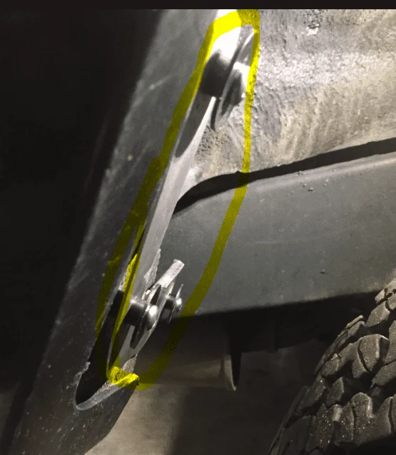

Did the bracket in the picture come with the new flaps?
Sorry I’m not following your question. The mounting brackets come in the kit with the flaps.
That's right. Did you order the aftermarket kit?
Yes, "aftermarket" kit. I think the only difference in that nomenclature is the added number of spacers, maybe some longer screws. Rami can confirm. The flap kit works well on my truck with the Bior bumper- very happy with the result. Impressed with the bracket design and quick removal; simple but its really ingenious. 👍
Thank you for the quick response. The bracket looks like exactly what I need. Nice design. I ordered the aftermarket kit also. 👍
