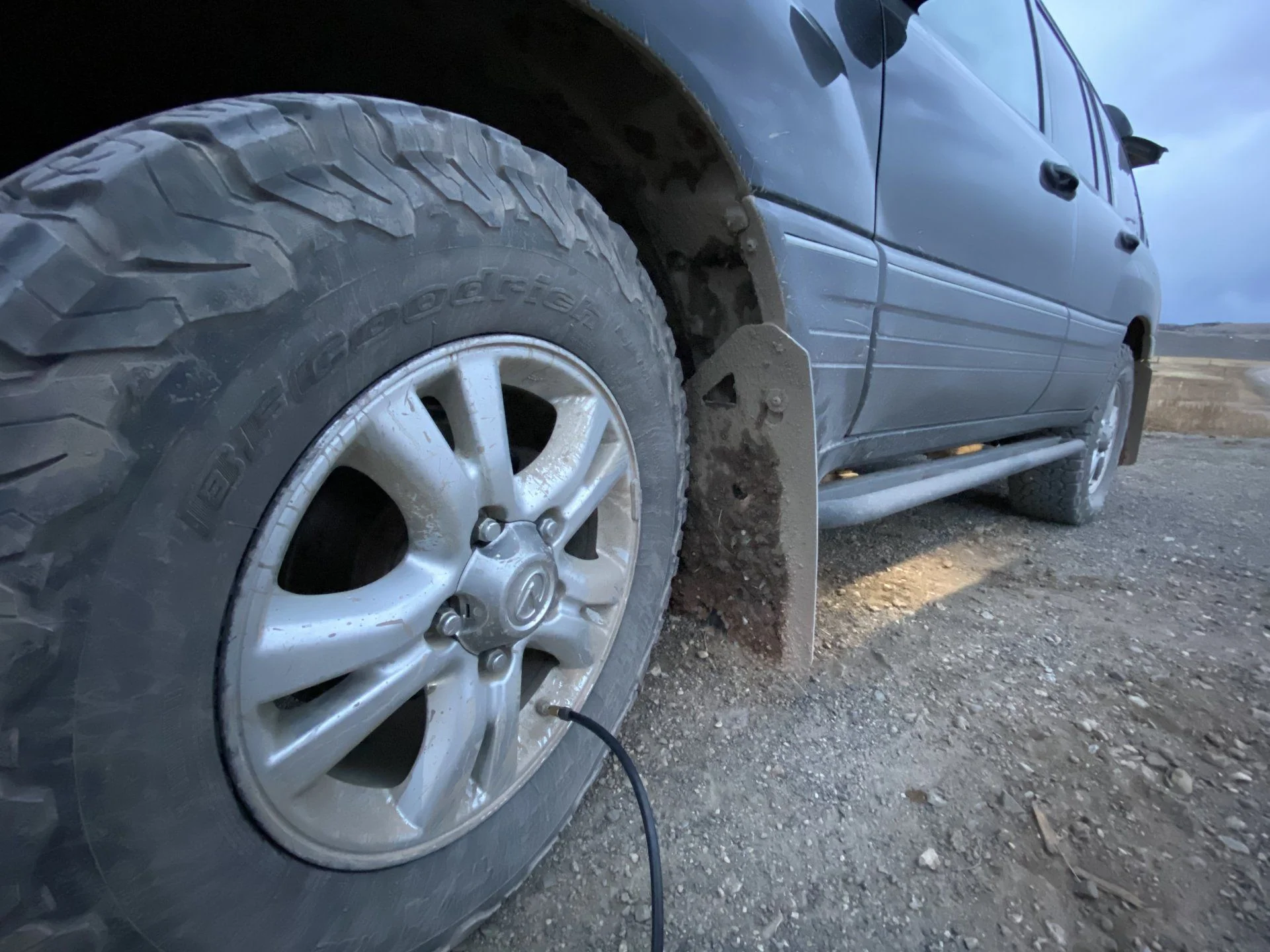

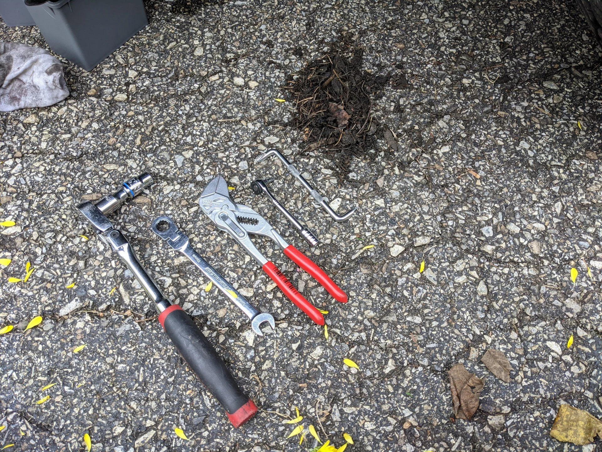

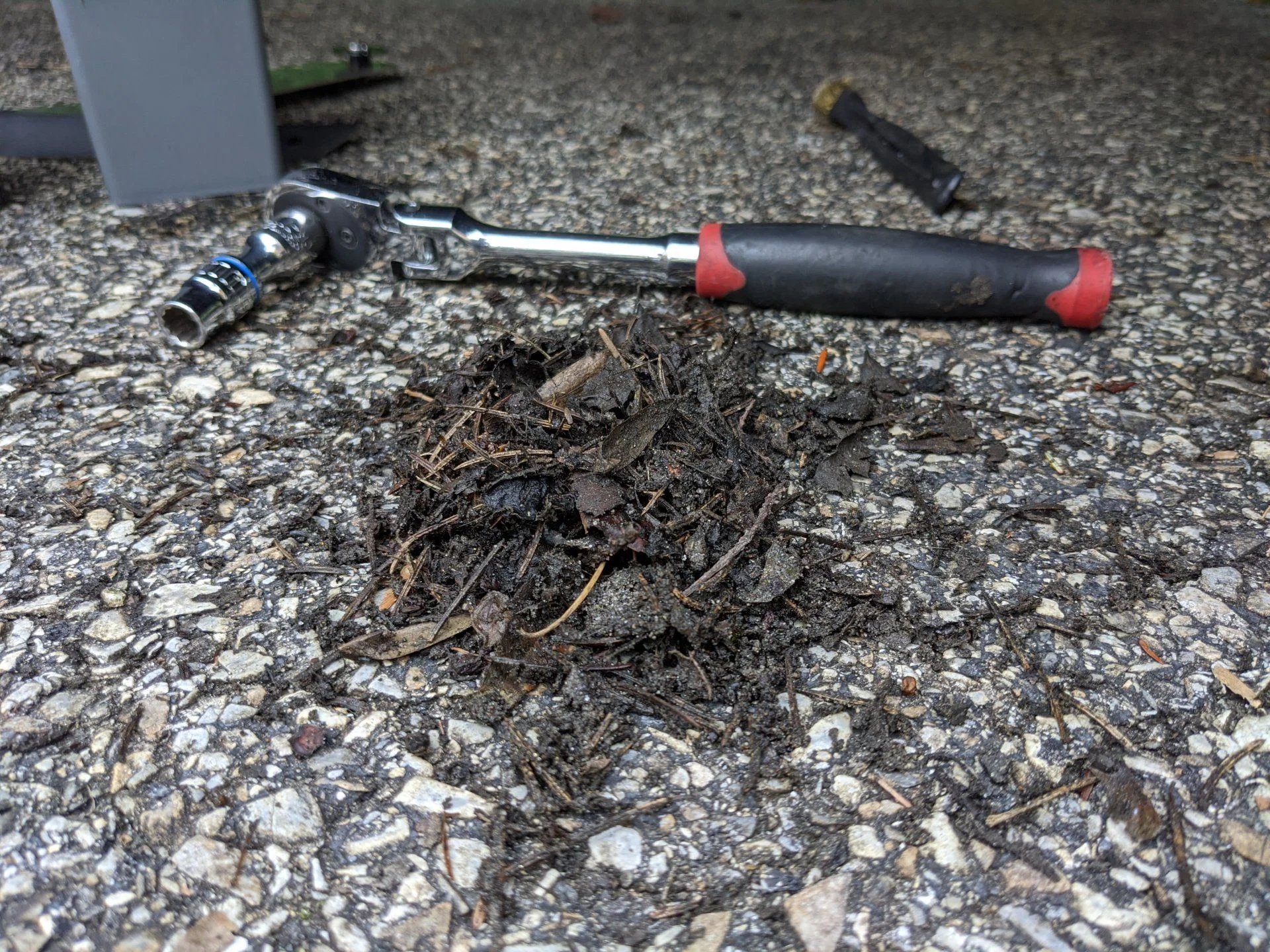

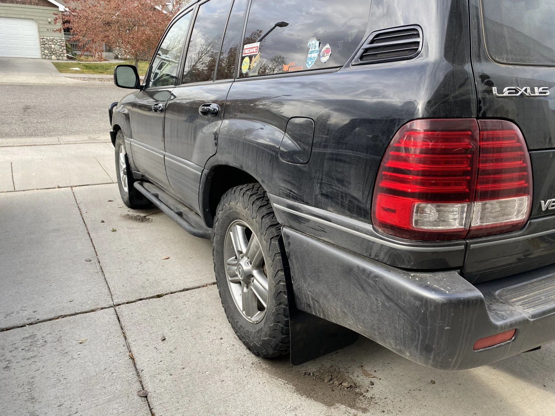

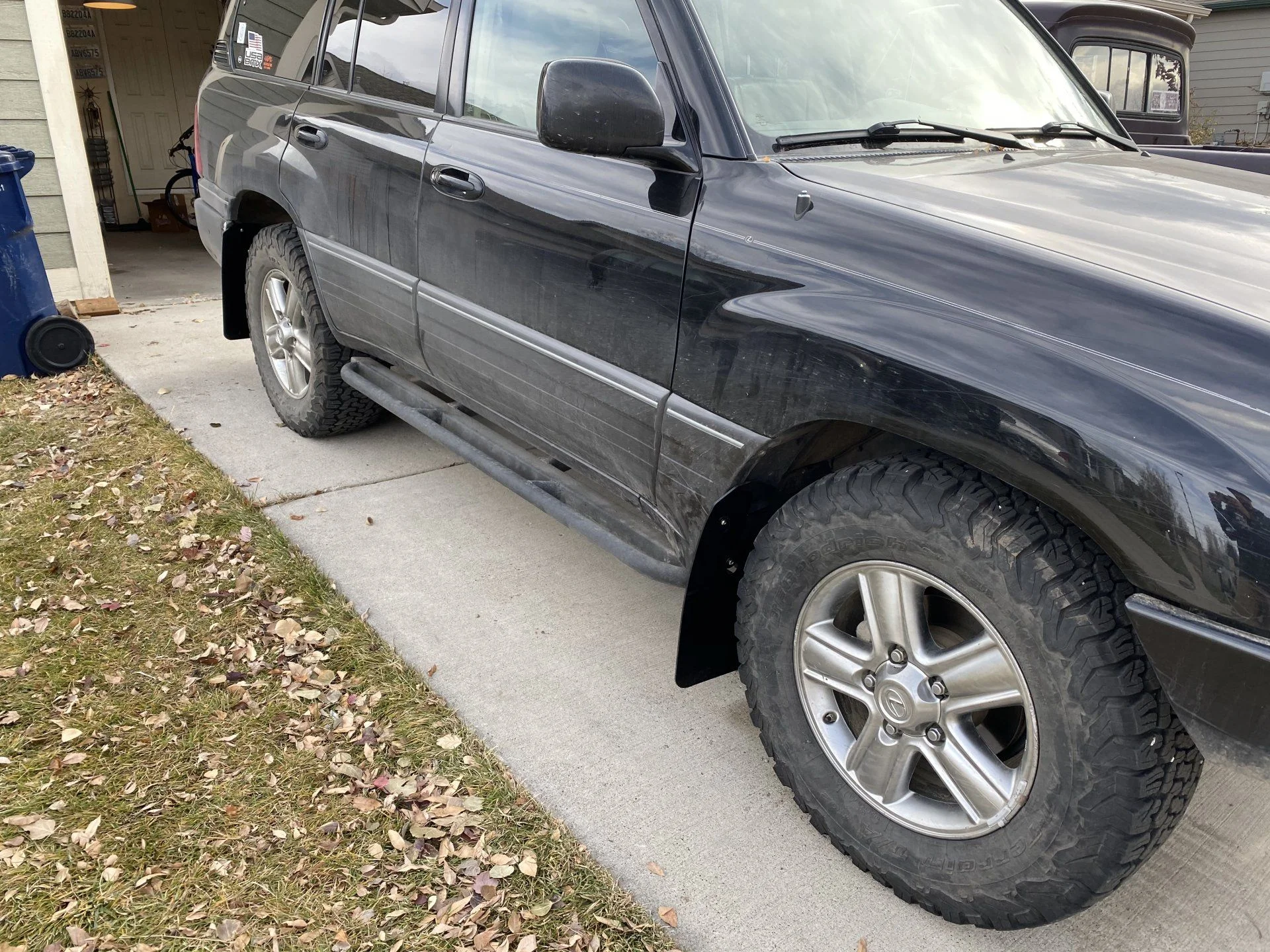

Got mine installed.
Always amazing to see how much junk comes out of the front fender/rocker area. I had OE LX mudflaps on the front, so I had already cleaned them out once before.
Got mine installed.

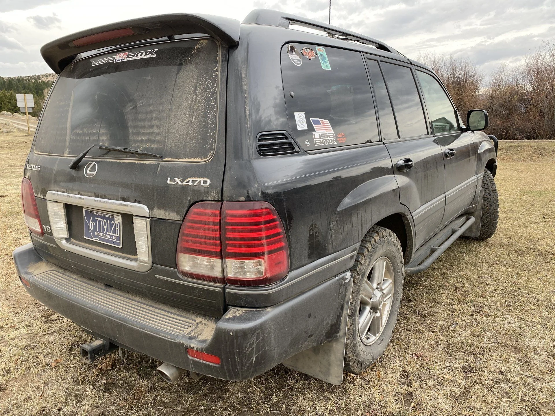

Looking at my pics, I realize I need to adjust that bumper/body gap

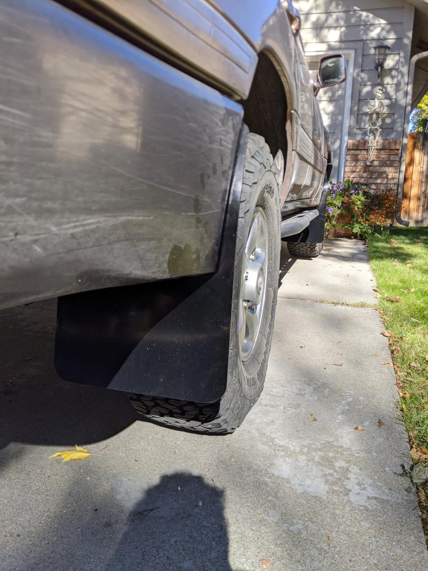

Was sweating the front bracket install. I have oversized tires and didn’t think there was enough room for the flap. But no problemo. The flap fit fine.

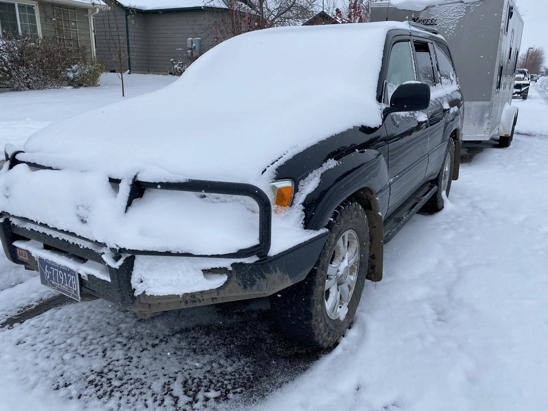

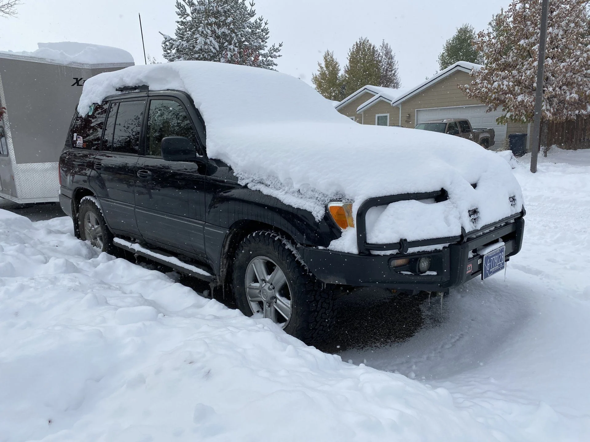

Installed Sat morning. Went for a 100 mile drive about that afternoon. Snowed again Sunday. Looking forward to seeing how they hold up this winter.

I installed mine last week. I’ll post photos tomorrow if I remember to take them. I used two longer bolts (1/4-20 x 1.25ā€ stainless pan heads) for the middle bolt in the back because I tried forever and couldn’t get the 1ā€ to engage. I did have some rust repaired there in past so that might have been why (thicker material to go through). Also, in the front (LX) I didn’t touch my sliders. I unclipped the fender liner and just pulled the cladding out enough to swap clips much easier imo. I had done this previously to hammer my snap weld and so knew it would work.
