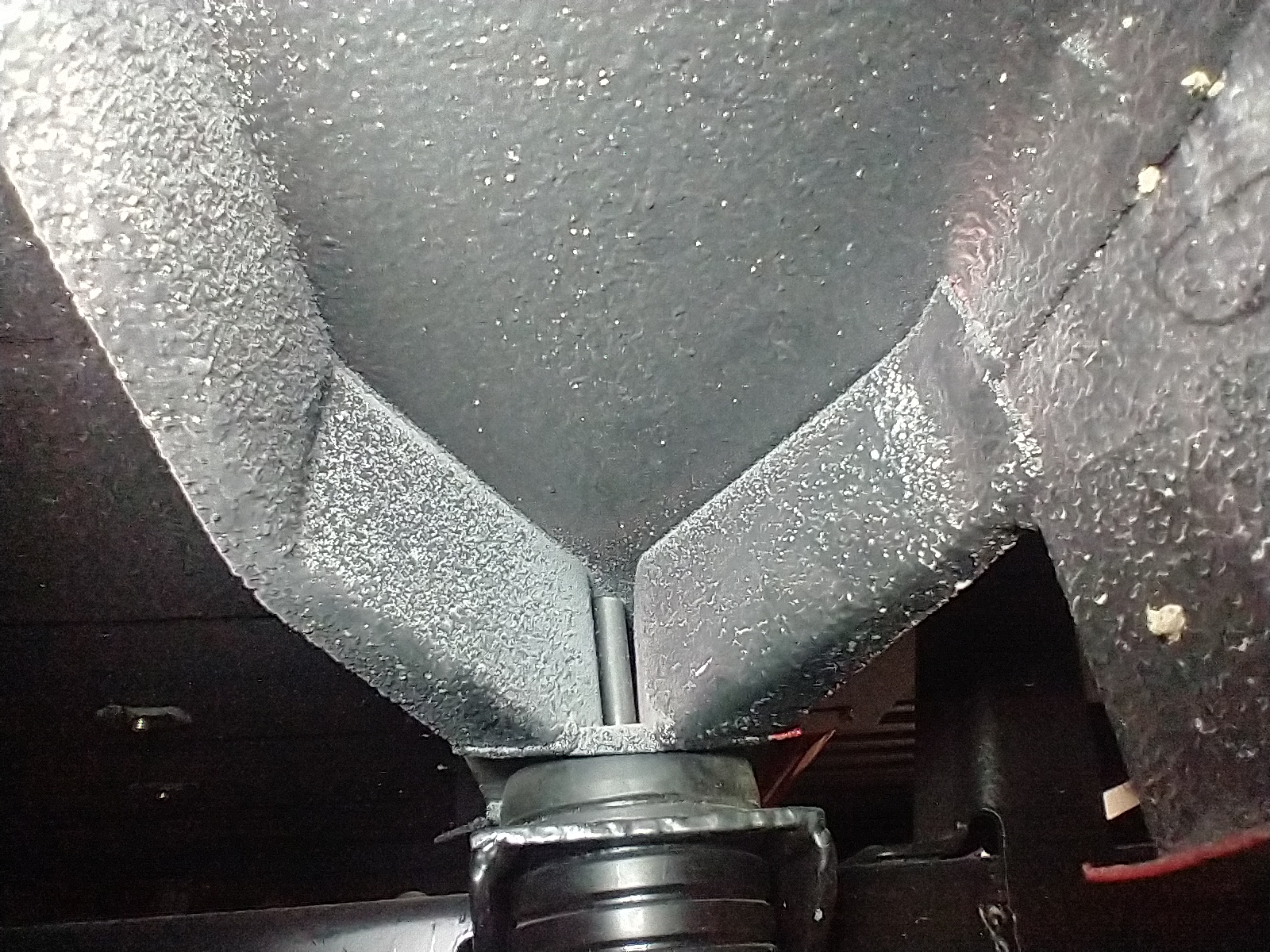

Some cab mount pics. More to follow
The poly mounts are Energy suspension. I'm sure I had a picture of the part number but haven't found it so far. When I was looking the Toyota replacement was NLA and the Energy suspension kit worked well.
thank you SO much for the pictures. I am finding it is actually not easy to find good reference pics of that area on 45's.
Did you make those completely from scratch? Want to make another set :D
