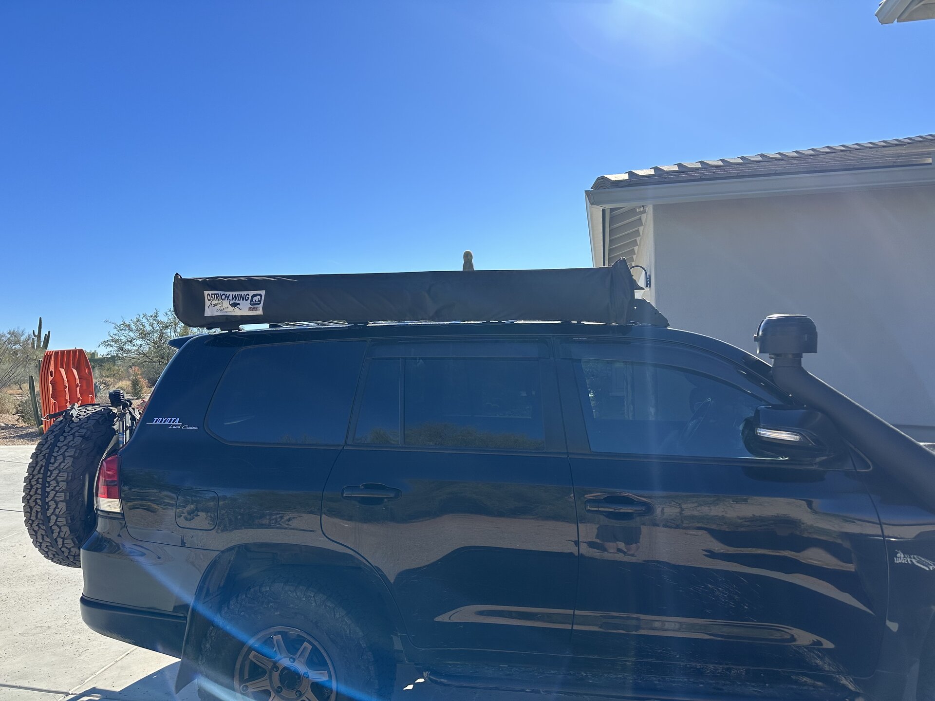

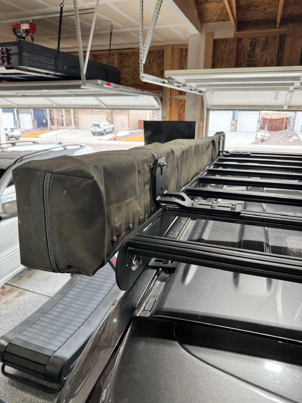

I have been running Ostrich Wing 270 on my Prinsu for a couple of years now. I am using three mounts and there is minimal to no flex. I use two Kaon mounts and one prinsu mount. I used a combination of mounts due to space requirements for the cargo boxes I ran on top. I don't think I have any pictures, but will take some this weekend.
Thank you in advance for the pictures if your able... I have seen those and they are nice...
3 mounts (or 4 even) would probably be required for any of these bug awnings on any rack.

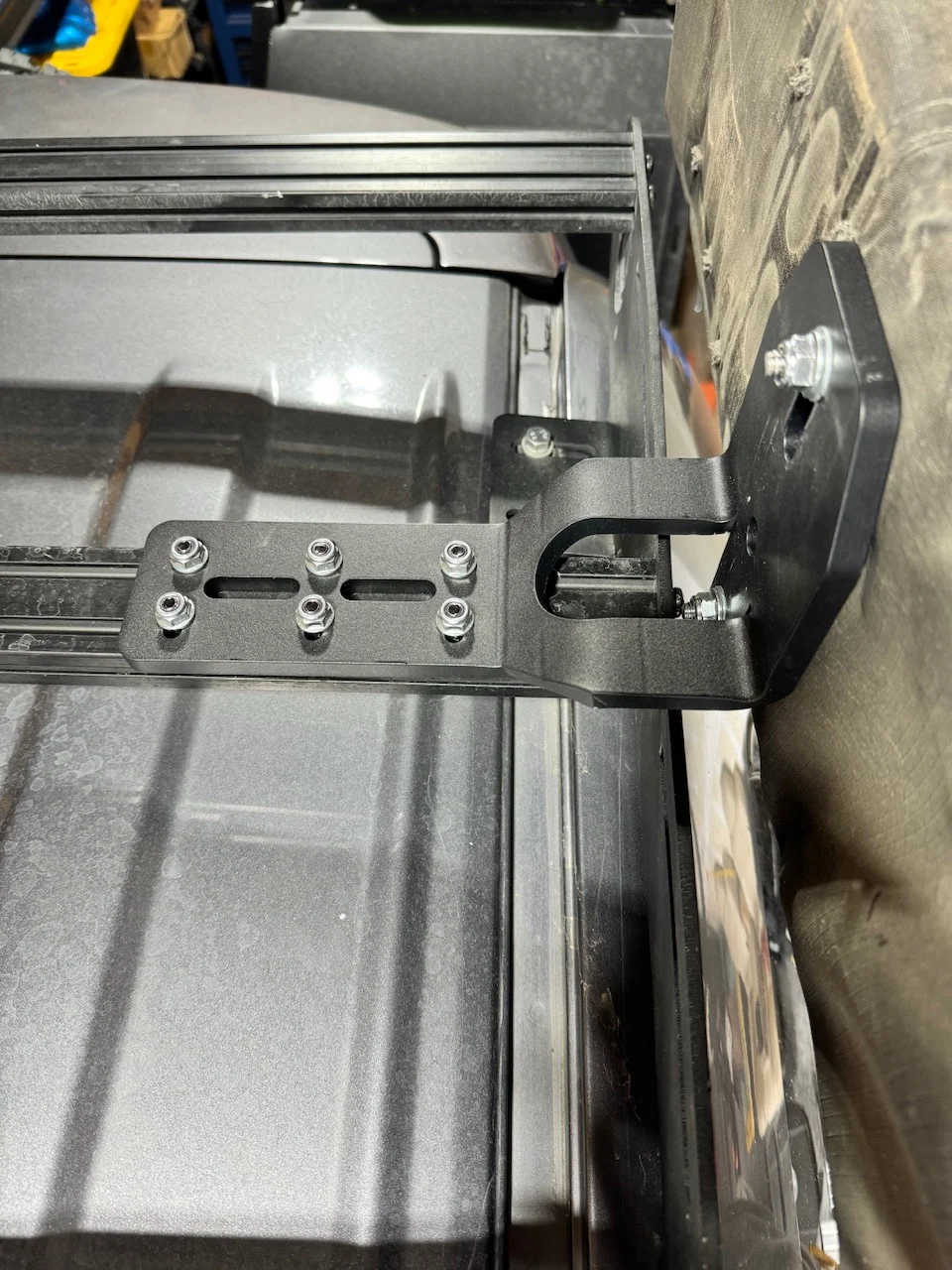

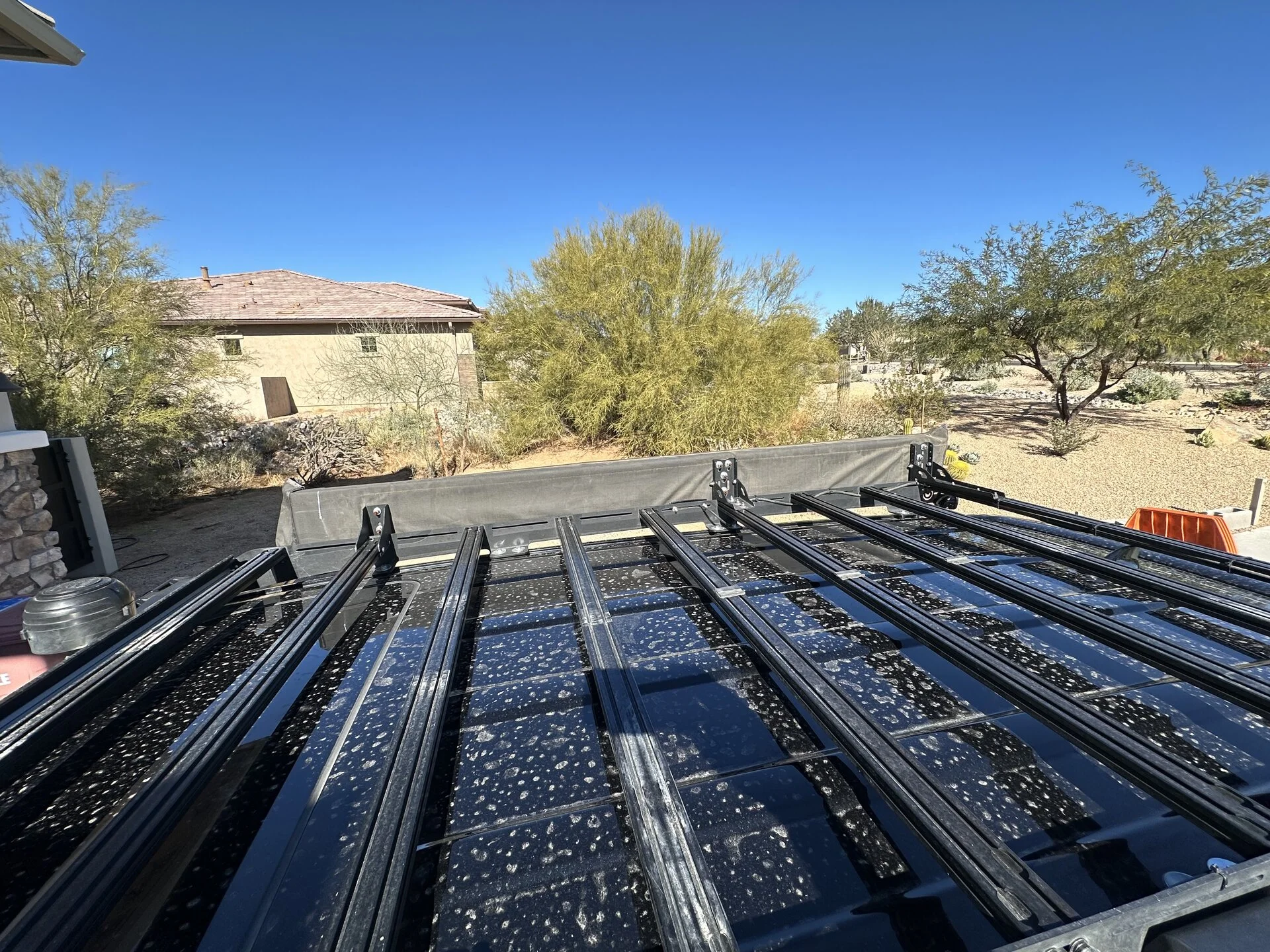

Took my bush co tent off a couple months ago and had to figure out how to mount my bush co 270 to my prinsu. Bought a couple different brackets and ended up using these:
They seem solid. I can still deploy the awning and hang my 170lbs on the awning arms without the rack flexing too much. VERY scientific test!
