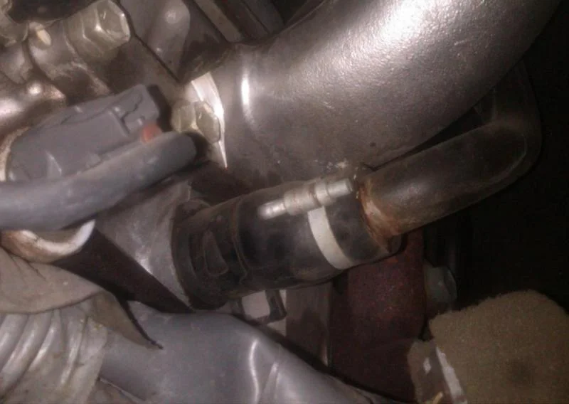

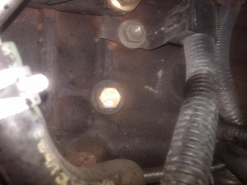

here's a shot of the PHH as is right now (not bad, little bulging, but not bad i'd say) and of the block drain that Jack told me about.

1. Drain radiator at petcock, drain block with the brass bolt.

If the radiator hoses feels soft and pliable, no reason to change them. If the inside of the radiator looks clean (through the fill hole) then I wouldn't be in a hurry to change it unless you've ordered it already.
I know that the silicone hose seems to be very popular but I'm not all that crazy about it. If a simple coolant hose can last 150xxx miles, why wouldn't one simply replace it with another one? People are going nutty about constant tension clamps and a fancy hose when simple clamps and an old fashioned hose seem just as effective. Well at least that's what I did on both of my 80s anyway; I used Gates rubber hoses. The Silicone tends to ooze around the clamps and don't seal as well and in some cases required a re-visit of the clamps. YMMV as they say.
Just my .02 cents.
Just my .02 cents.
I agree, nothing fancy here, just regular heater hose and regular hose clamps for the PHH. Just keep telling yourself, what would they do in a third world country??? Not much is the answer. Just replace it with some hose/clamps and call it good.
Jack
Just my .02 cents.
The fluid in the radiator right now is very dark, and looks like it hasnt been changed in ages. I already bought a new radiator (cause of how crappy the fluid looks, just would rather replace it now) and I ordered the new hoses with the other stuff. If the old hoses look good inside and out, i'll just keep them as spares.
i'll see if Napa or anyone else in towns sells the Gates rubber hose.
As far as the water enema goes, just pull one of the heater hoses and attach a hose to the end of it? I'm not to sure how to go about it and which hose to use ( i need to buy a manual for this thing cause i'm not to sure where everything is yet.) WHen I do flush it with the hose, pull the brass bolt on the block, and all the hoses to let it drain out in as many spots as possible?
