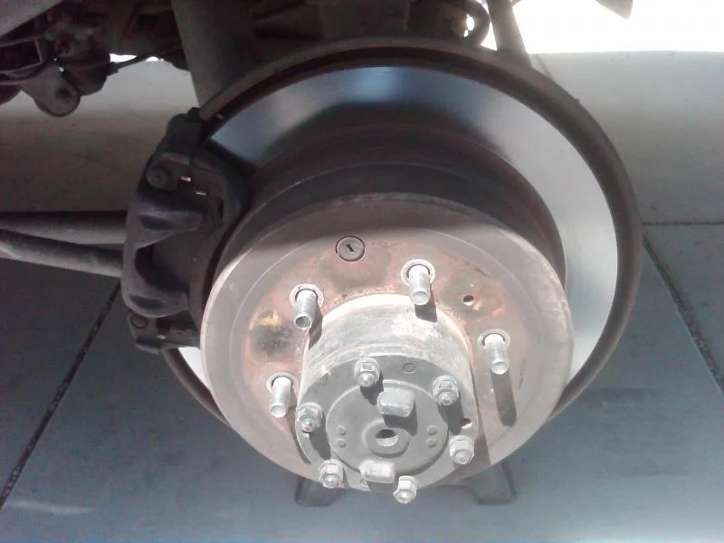

Took the tires off to mount the BFG AT's today. The brakes look great and have plenty of life left in them!

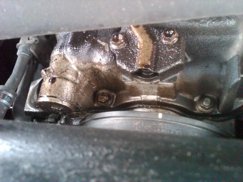

Here's a small pic of the oil leak up front. It doesn't look like a front main since the residue starts below the crank. Could be coming from the sensor? I'm going to pressure wash the bottom of the engine today so I can see where its coming from.
The front leak could be coming from the arch pan seal area. I'd suggest boning up on the FAQ section in the 80 series as it talks about how to go about fixing it.
Thanks Ali. Hopefully its not that... seems like a big job to tackle from your thread on the FAQ page. I washed it all off, so we'll see where its coming from in the next day or so.
