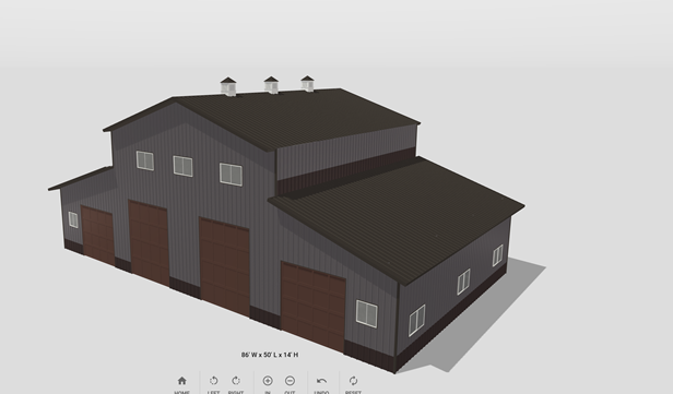

Here is the basic design we are going for. Other design goals are radiant floor heat in 6" slab, 300A panel, R30 insulation in ceiling and walls with finished interior walls (metal), sectional fold up doors, 40x20 mezzanine in the rear, 2T single beam gantry crane, and a lean to across the back 80'.

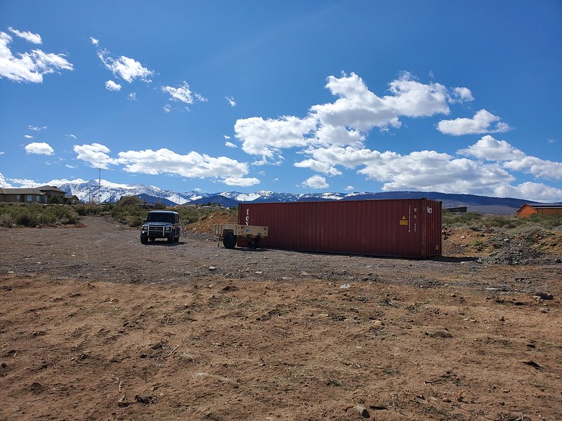

Here is a shot of the property. It's 5 acres about 20 min from downtown Reno, 20 min from skiing, and 25 min from Tahoe. We lucked out on purchasing this a few years ago before it hit the market. I'll keep everyone posted on how things turn out. Hope to break ground on the shop late fall, with the house late next spring/early summer.

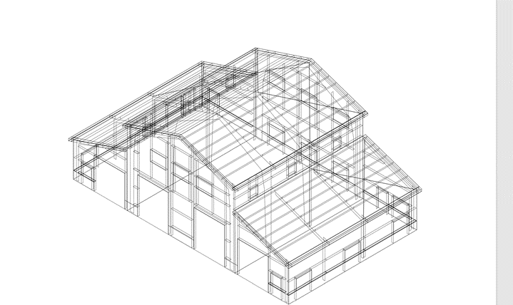

Well it looks like @snobdds was pretty close. I'm starting to get some bids in and it looks like this is easily going to be $550-600k. Here are some more renderings of the monitor style design:
I've had two bids for the building kit, the first from Great Western, and the second from a contractor that uses Varco Pruden for their kits, and both are more or less at $300k, for the kit, including shipping and tax. A lot more expensive than I thought, but with metal prices where they are at, not entirely surprising. I do have a lot going on with the design and that $300k figure includes a 40x20 metal mezzanine, insulation, liner panels, and a 82x12' rear porch.
Another surprise was concrete. It is going to be $15/ft for a 6" slab. Just the install for the PEX tube will be close to $5/ft, plus $2/ft for 2" foam board. Grading and excavation are easily another $6-7/ft since the building site is on a 3-4% grade, so around $125k for all of the above.
I also underestimated the construction/erection cost of the building. This is going to be more like $70k. The other estimates are still accurate, at least for now, though I have a feeling that the door/window package is going to end up over budget too.
