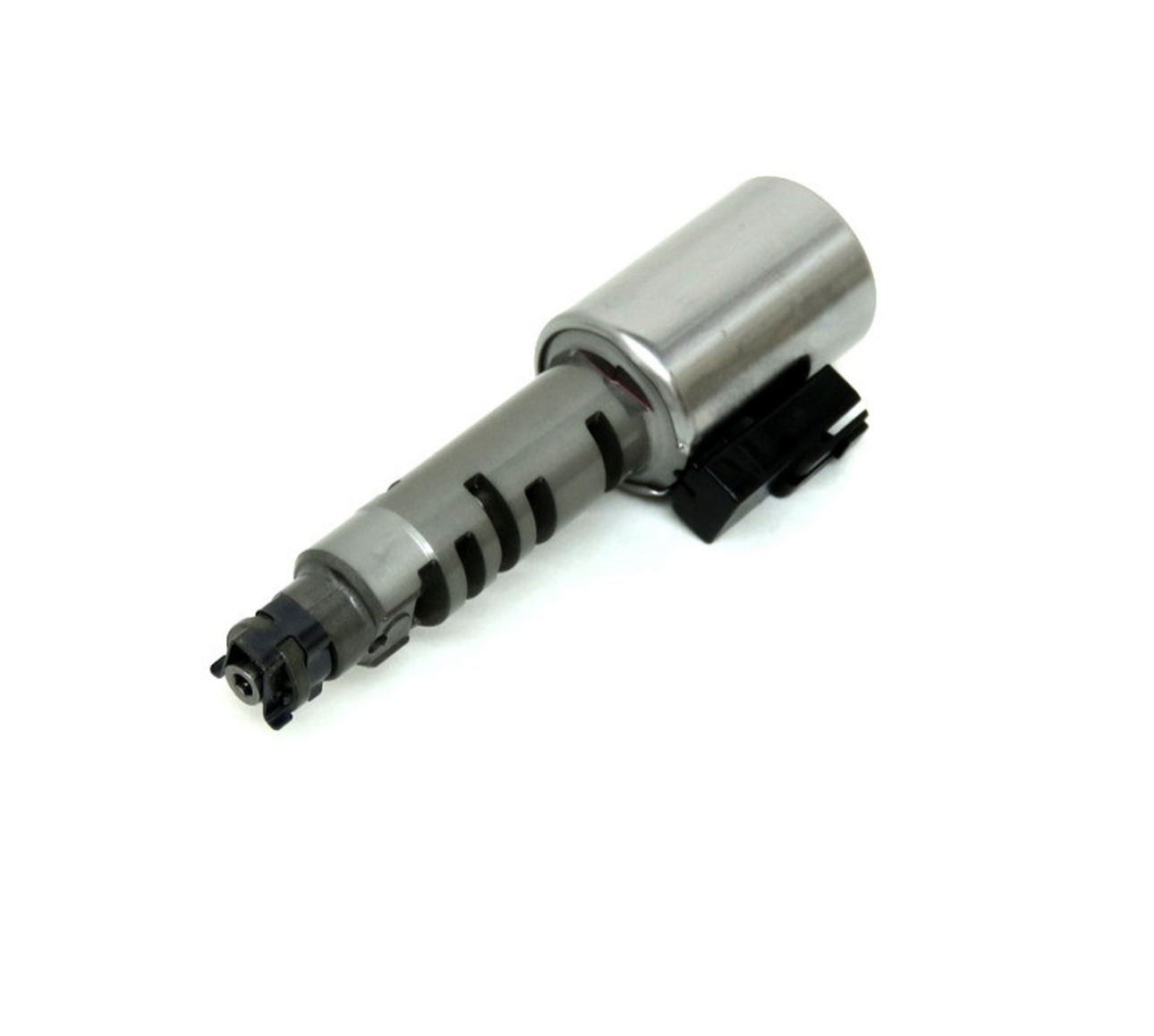

I am going to do the solenoids on my 94 as I’m starting to experience some poor shift behavior.
I know there are the 4 shift solenoids but no one seems to mention the pressure control solenoid. Is I needed as well or only the shift solenoids? Can it be replaced just as easily?
Yes, you need all of them working to have a working transmission.
I'd replace all the solenoids while I had the unit open. It's not that much money and you won't have to go back in and do it later; they don't last forever.
