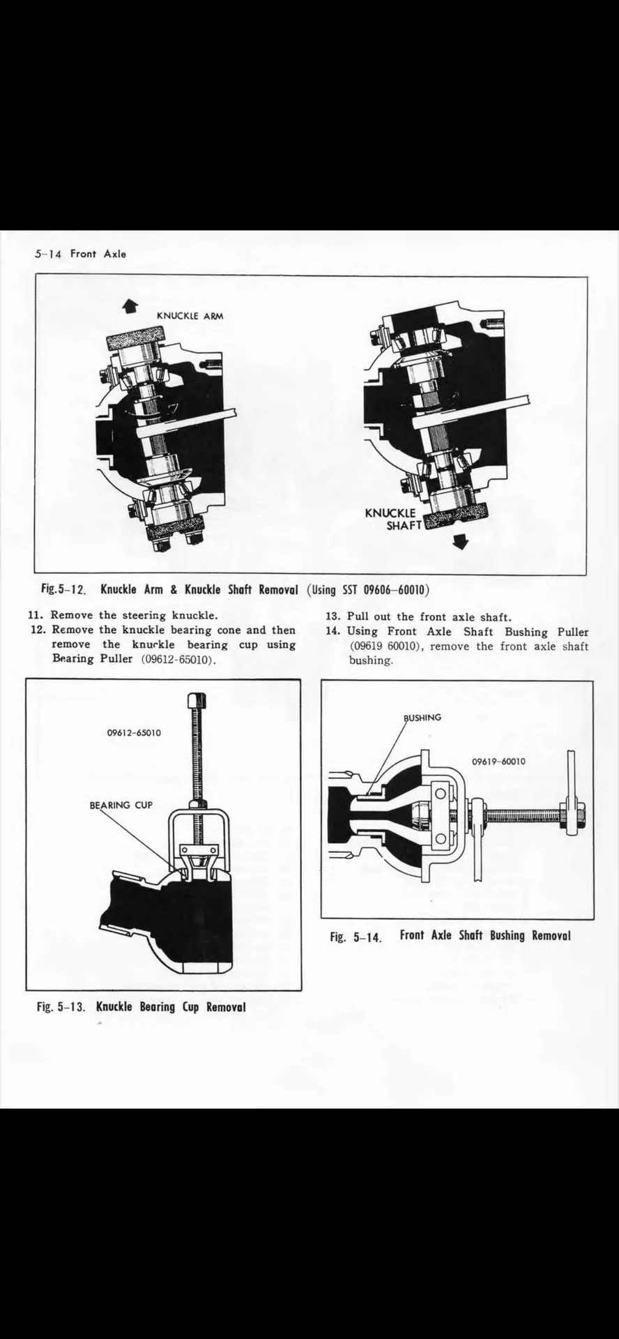

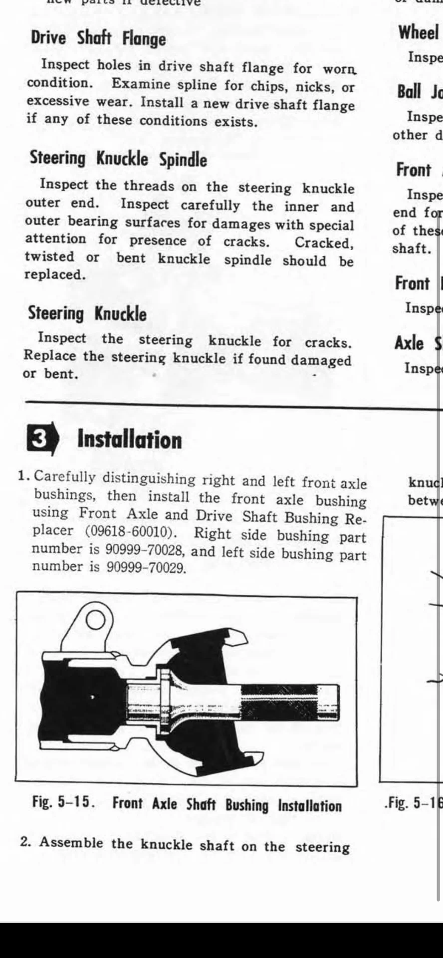

This from the Factory manual for early rigs.
You would think a slide hammer with a 3 jaw puller would work.
Thanks for info. I got it out with a slide hammer. My next issue is the replacement bushing has a raised collar that prevents it from fully seating. Unfortunately I don’t have a lathe or a local machine shop. I’m going to go full shade tree with a dremmel and sand paper.
Do you have a drill press? Drill press and file would work... if you're not able to run it as is.
Are these the replacement bushings from SOR? If so, I recall a friend with a 67 having to have them machined prior to install. Probably worth a trip to find a machine shop and do it right. You will need a cylinder hone and knuckle centering SST to install the axle and knuckle correctly too.
I was under the impression that you didn’t need the knuckle centering tool if nothing more than bearings, seals etc were being replaced. Just keep track of where the shims came from and install them in the same place. Is that true or fake news?
Yes, these are the SOR bushings. I have the hone and just had to barely tickle them to get the to slide onto the axle.
