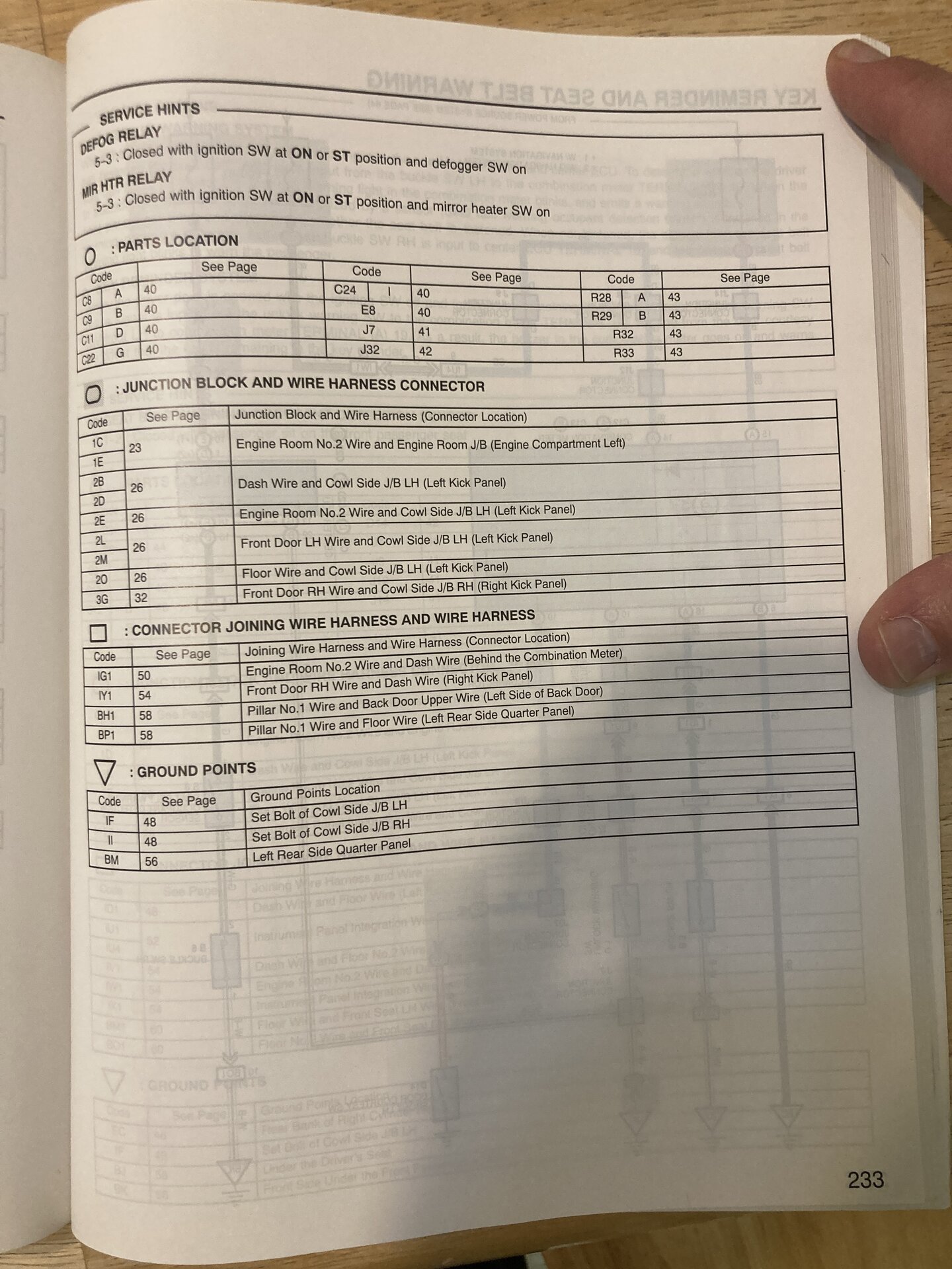

Hey guys, has anyone else had issues regarding heated mirror/rear defrost?
It snowed here in Colorado recently and I figured out both of those defrosts don't work at all even though last year before I did the nav delete they both worked fine.
Where should I start checking to diagnose the problem? I already tried using a separate land cruiser dash I had laying around and still the same issue. Buttons do light up on both like they should be working but neither heat up at all.

Take a look at this photo from the FSM, it shows the pin out and the circuit. Have you checked the fuse? Looks like the output is A1 where I5 was connected, shows to be a red wire. Good luck!
View attachment 3481906View attachment 3481907
This fixed my problem. I didn't have a wire coming off A1 so I had to find a spare pin from one of the other connectors and after hooking that up to the red I5 wire everything works good.
Thank you!
That is great. How did it work last year without it being hooked up?
It worked fine when I had the Nav wiring the car came with but the pigtails I got to do the conversion just never had a A1 pin i guess. I did the work this last summer so I never had a chance to find out they didn't work until now.

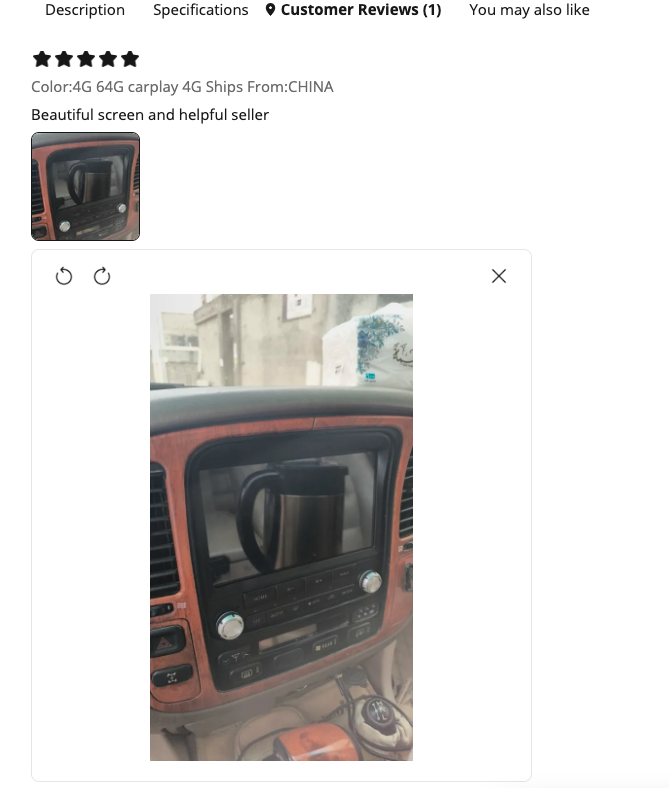

This headunit fit only for navigation bezel, just plug and play without manipulating wire harness. It has Apple CarPlay & Android Auto
CarPlay 9" QLED Auto Android - LX470 1998-2002
This will not work for American specs, only for Middle Eastern specs. American specs has touch screen for AC controls while MidEast has manual knobs for AC. The American specs will first need to be converted to Manual AC Knobs like MidEast, which is the point of this whole thread 😅
On the 2002's the climate controls are not on the touch screen like the later 100's. However, they do have climate controls on the top of the screen & dash pod. It looks they have included the climate controls within this unit and moved them to the bottom. Would love to know if this unit actually works.
Do you have this unit?
Unfortunately, I don't have this unit because I have what you guys want to do which is non-nav bezel. I wish I had nav bezel to buy it.
BTW, I asked the seller if it's compatible with me if I buy nav bezel.
Not true, I am in Middle East and I see many LX's from 2000 till 2002 have nav bezel like what you have in American spec and there is someone from KSA buy it and give feedback about it.
