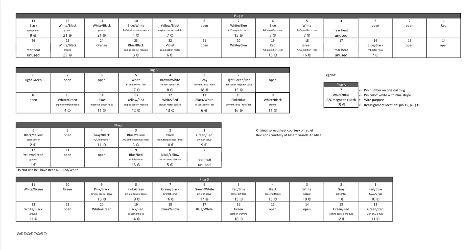

That’s what I’ve been trying to do. I’m familiar with terminating and pinning connectors. I just want to get an idea of what I’m looking at.
Thank you for the sheet
Please don’t forget that there are multiple grounds that can all terminate together to slightly simplify the process. If you miss a ground, something will not work.

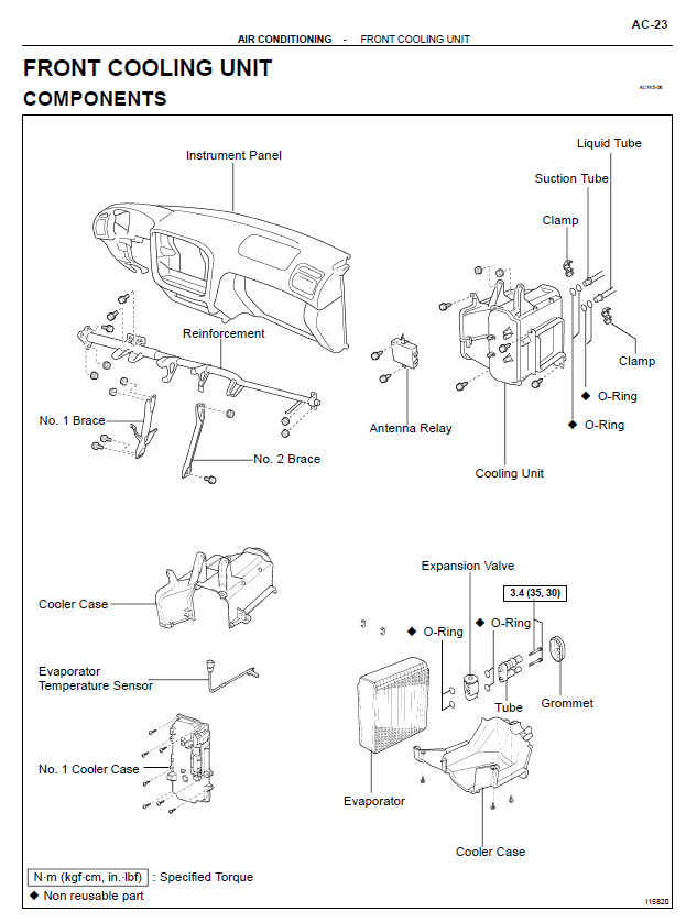

All, I would appreciate any ideas the mud community would have for the issue I'm having:
I'm currently at Yokota Air Base in Japan. My buddy and I both have 98 JDM Land Cruisers, mine is a LC and his is an LC Cygnus (LX 470). A few months ago I did the nav swap to manual controls on his truck and I thought all was well. Now that summer is here it turns out the AC is not getting cold.
1. Buddy said the AC worked before
2. The ac button illuminates and you can hear the compressor kick on/off when you toggle the button
3. Blower speed and mode changes are all working, all other buttons on the HVAC panel work. Clock and outside temp display work.
4. Rear AC is cold, the system seems to be properly charged with coolant
5. Switched his HVAC controls into my LC and it works fine in my car, mine has the same result in his car. Panel and controls seem to be good.
6. Temp control on hot is noticeably hotter on heat mode and gets cooler (but not cold) on cool setting, it appears to be somewhat working...
7. I've checked the connections over and over and it appears to be wired correctly
8. The "C12" connector is not a ground as others on this thread have mentioned. When I disconnect that PIN the AC button stops working completely.
Any ideas what would keep the AC from getting cold? Thanks!

If the rear AC blows cold, but the front AC does not…
Front evaporator issue?… Front TX valve ( expansion valve) could be plugged up, or the front evap core could be plugged… no air flow over the front evap core?
Just my first thoughts…

That is a good question…
In most every common place automotive AC application, refrigerant flow through the evaporator coil is purely mechanical…
The AC pump runs and pumps refrigerant through the system… the high side liquid pumps through the TX valve and evaporates causing the cooling of the evap core.
The only electronic countermeasures involved is pressure differential… too much high side pressure would open the AC pump drive clutch if the evaporator were to freeze over.
I do not know of any electronically controlled differentiating valves incorporated into the 100 series Land Cruiser refrigeration system.
If the high side hard pipe is frosted all the way up to the front to rear diverter WYE fitting… it tells me that there is no flow of refrigerant into the front evaporator core.
Some obstruction is preventing the refrigerant from getting into the front evaporator core. I do not believe that there is a solenoid valve ahead of the expansion valve.
And I do not have an FSM to reference… But rather, just a lot of practical knowledge through trial and error, and working on these things.
I think the front evap core TX valve is plugged up…

Correction…
The WYE pipe fitting is on the low side… that is refrigerant coming out of the evap core going back to the compressor.
I just popped the hood to look at mine… on the passenger side firewall, there are 2 pipes going into the evap core… 1 larger and 1 smaller.
The small pipe is the high side, refrigerant into the core. The larger is the low side, refrigerant coming out of the core.
I did not see any solenoid valves on either of these on my 2002 LX
Did you check the spyglass to see if there are bubbles in the refrigerant? Could be low on charge as well.
The spyglass is in front of the radiator on the driver side, just below the bumper level.
Also, make sure the auxiliary AC electric fan comes on when AC is engaged.
I think the front TX valve is plugged… not providing full flow.

Thank you Unruly! Appreciate you sharing your knowledge and I agree with your diagnosis. Based on your response I dug more into the service manual and found this youtube video and it confirms everything you said.
No bubbles in the spy glass. AC fan didn't run but I checked the plug and its not getting current and the resistance check of the motor showed a few ohms so I think its OK.
This issue looks to be unrelated to the nav delete, I'll start a new thread to document the fix once its resolved, I won't post here anymore about this issue.

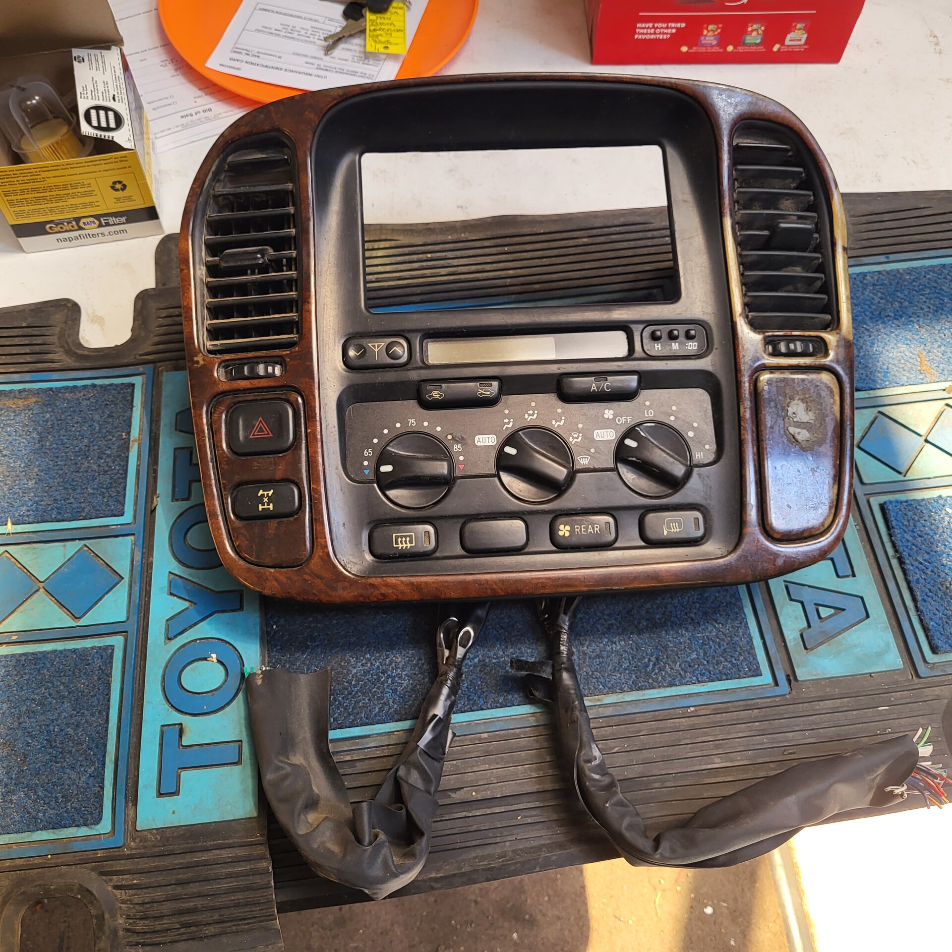

Hey guys, I'm in the middle of doing my nav delete and have a few questions.
My stock mark levinson amplifier is toast, How do I go about hooking everything up to an aftermarket amplifier and getting audio to work?
Also anyone in the Denver,CO area have a non-nav faceplate that I can use to test out all of my connections? The one I bought is toast and half the buttons don't work on it. Just wanna double check my work before I spend another 550 for a used ebay one.
Thanks!

You can bypass the amp using the aftermarket headunit, but that will require you to install new speakers as well. This is what I ended up doing after trying (and failing) to get my ML amp working with the aftermarket head unit. There are some solid threads on how to do this.
Half of my buttons on the non-nav bezel were toast as well, but if I pressed them enough times (or hard enough) I was able to get them to work intermittently which told me the wiring was correct but the button contacts were toast. I mailed my bezel to a guy on ebay and he replaced all the contacts and now everything works perfectly. Took about 10 days round trip to get it back. Search "98-02 LX470 Climate Button Replacement Service" on ebay and it should come up.

The previous owner installed new speakers and has some adaptor/splitter things near where the amp wiring was. Ill probably pull a door panel off tomorrow to see what kind of speakers it has.
I soldered new buttons and had my climate buttons working for a few minutes then everything went out completely, I probably should have just sent it in because I think I fried it trying to do it myself.
