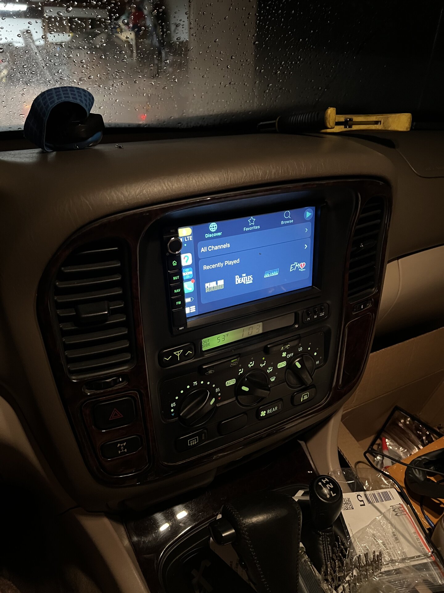

My son (21 yo) completed removing the pins from the old connectors and installing in new connectors from Mouser (thanks @ruifrsilva ) on our 2001 LC. He struggled at first with the pin extraction because I don't think I provided the proper tool, but once he figured out a method with the tool he had it went smoothly. The crimper that was suggested for attaching the new pins gave him a fit. Couldn't get a good grab on both the exposed wire and the sheathing. Had to manipulate with needle nose to get the pins to seat all the way in the connector.
I completed a new excel file for those doing the repin versus getting a bezel with pigtails that I'd like to post once I figure out how.
Clock buttons on new bezel aren't working and the mirror buttons aren't working. He is going to check the wiring on the mirrors.

Can't thank you guys enough that got this started and have kept it going with guidance and input @primeral @TXSunDevil

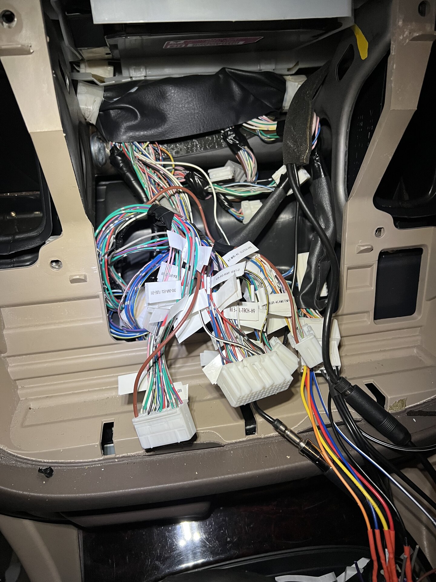

Just did this modification to my 2002 LC a few days ago without cutting and using pigtails. I ended up finding a LC panel without the pigtails and used new connectors. I pulled the wires/terminals from the old connectors and put them into the correct locations in the new connectors.
Most of the terminals were the same on the old connectors vs the new connectors but around half a dozen or so needed to be re-terminated with the correct terminal.
The connectors are TE Connectivity parts and I bought connectors A, B and D through Mouser using the manufacture part numbers. I couldn't find connector C in stock as a TE part so I ordered connector C through my dealership using Toyota PN.

I also ordered extra pins. The new connectors use two types of terminals. TE Connectivity 0.070 and 0.040 Multilock series terminals. I ordered 50 of each but only used a few of each.
0.040 Multilock Terminals - TE Connectivity Part # 175265-1
0.070 Multilock Terminals - TE Connectivity Part # 175269-1
Everything went well with the swap. Thanks to everyone which put in the hard work to identify each pin change and put together the pdf to make this pretty straightforward. If you go the same route as I did, I do recommend a proper crimper for the few terminals needed to be swapped. I used something like this with the correct jaw for open barrel type terminals.
