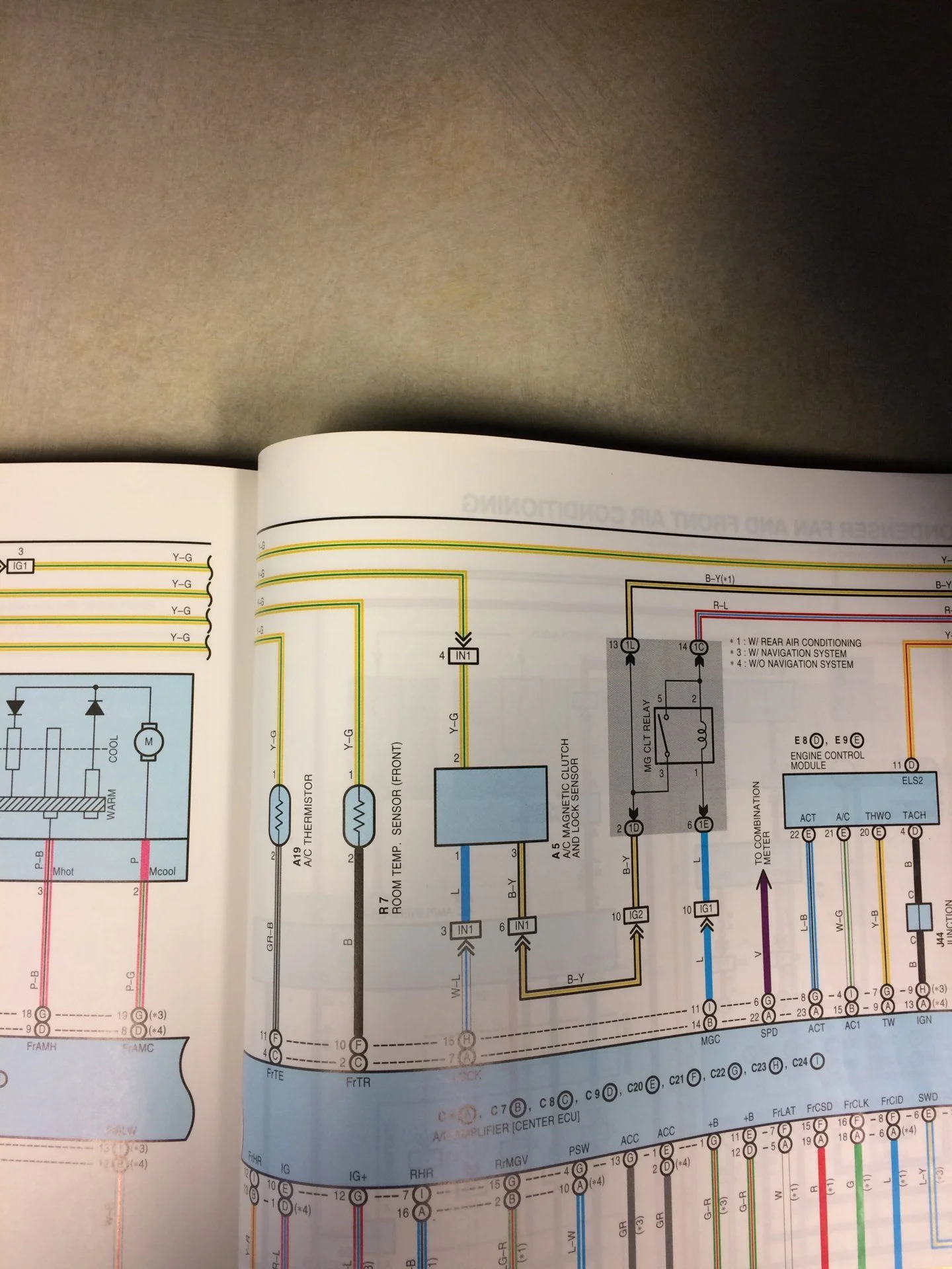

Can you manually check the AC switch to see if it is opening and closing? If you are 100% sure the wiring is good I would start looking at that controller.

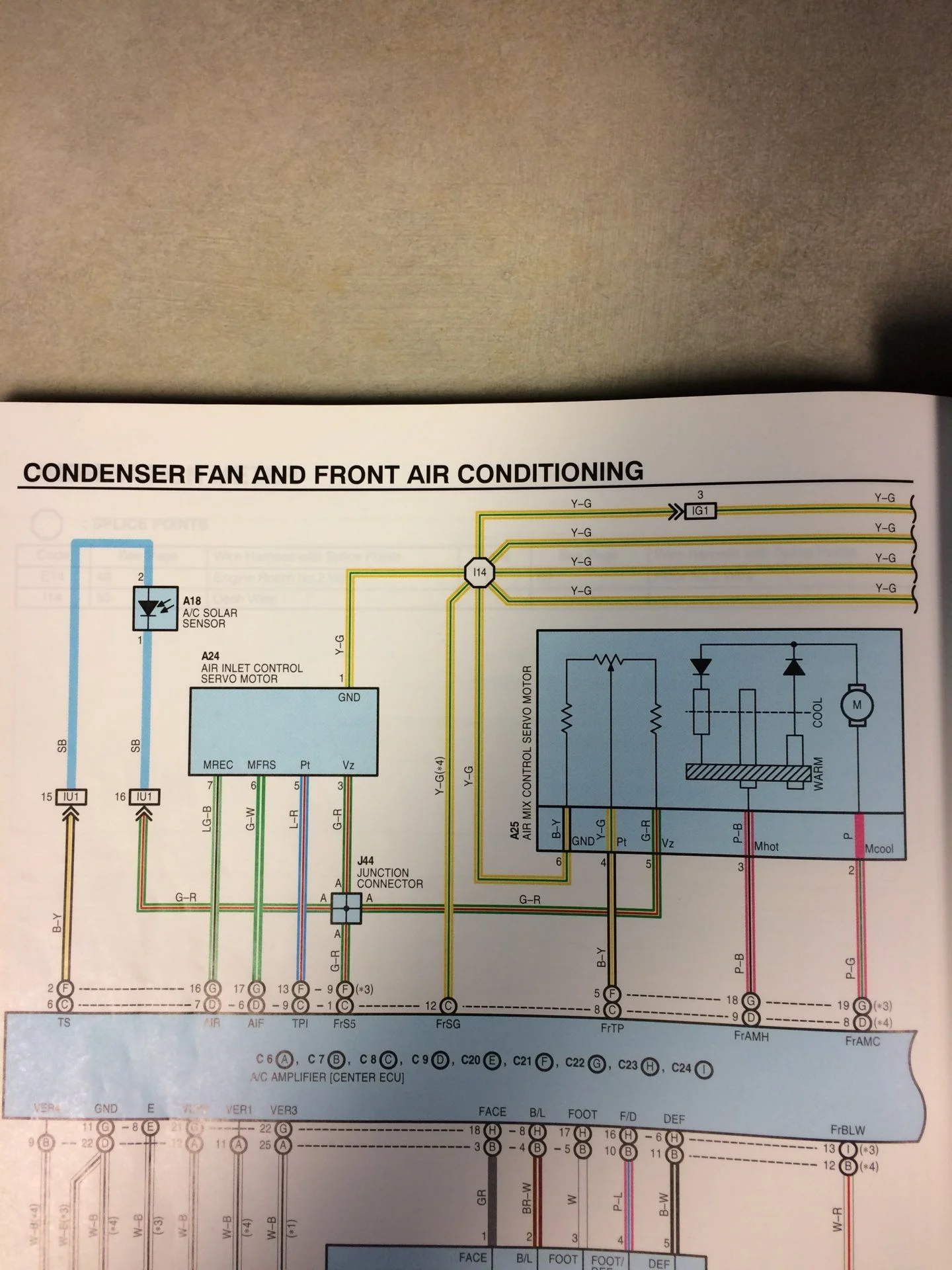

Here is the photo of the Mag Clutch relay which energizes the compressor and the AIR INLET CONTROL SERVO MOTOR. These are the two areas you say do not work. Check this wiring real well once again.
Oke i will check the wiring again and the switches. Report back asap. Thanks for your help.

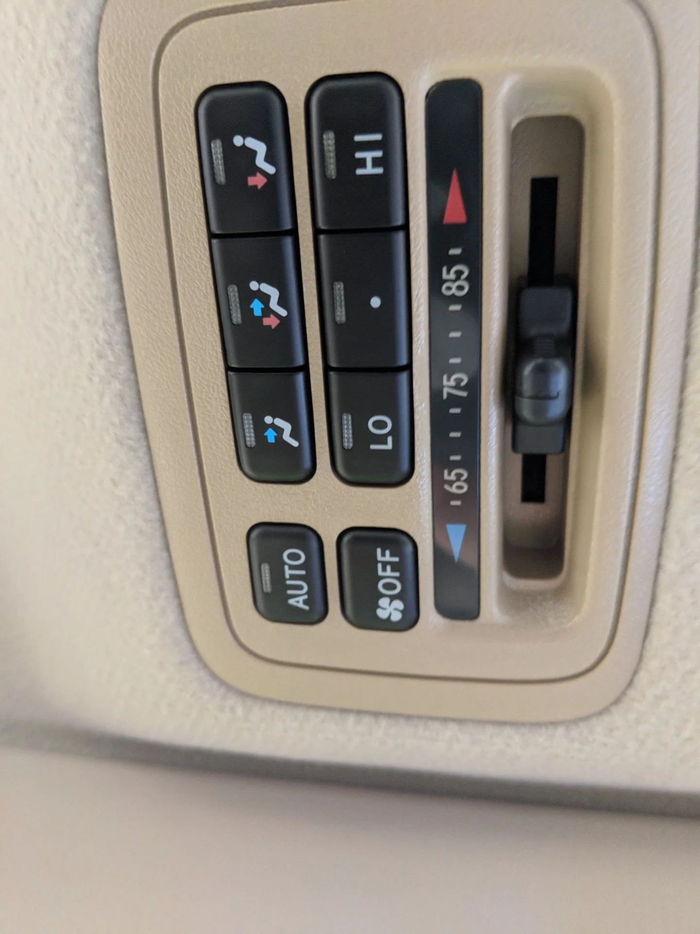

Moving the rear ac controller to cold will blow cold air out the top vents in the third row. Moving it to heat will blow hot air out the bottom vents in the middle row. Here's a photo of my rear AC controls.
Just wanted to check back and let you all know that I confirmed AC and Heat in the rear of my 02 LC.
Yep, you've got rear heat and AC.
I have that same controller but my vehicle does not have the rear heat option. I do have middle seat vents that are near the floor that will put out heat. I believe the rear heat option was that is on the 3 knob controller is for the supplemental rear heat that is under the drivers seat. In this thread go back to Post #136 and read about @m3kachu issues with using a 3 knob that had a rear heat button. It appears to matter what setup you have.
Post #180 has a pic of the Rear heat button.
I did read that. His issue was his 3 knob only had a button to turn on rear heat. So the normal three know with the Rear fan button should allow me to continue to use my rear heat/AC controls, correct?
Yes, you are correct.

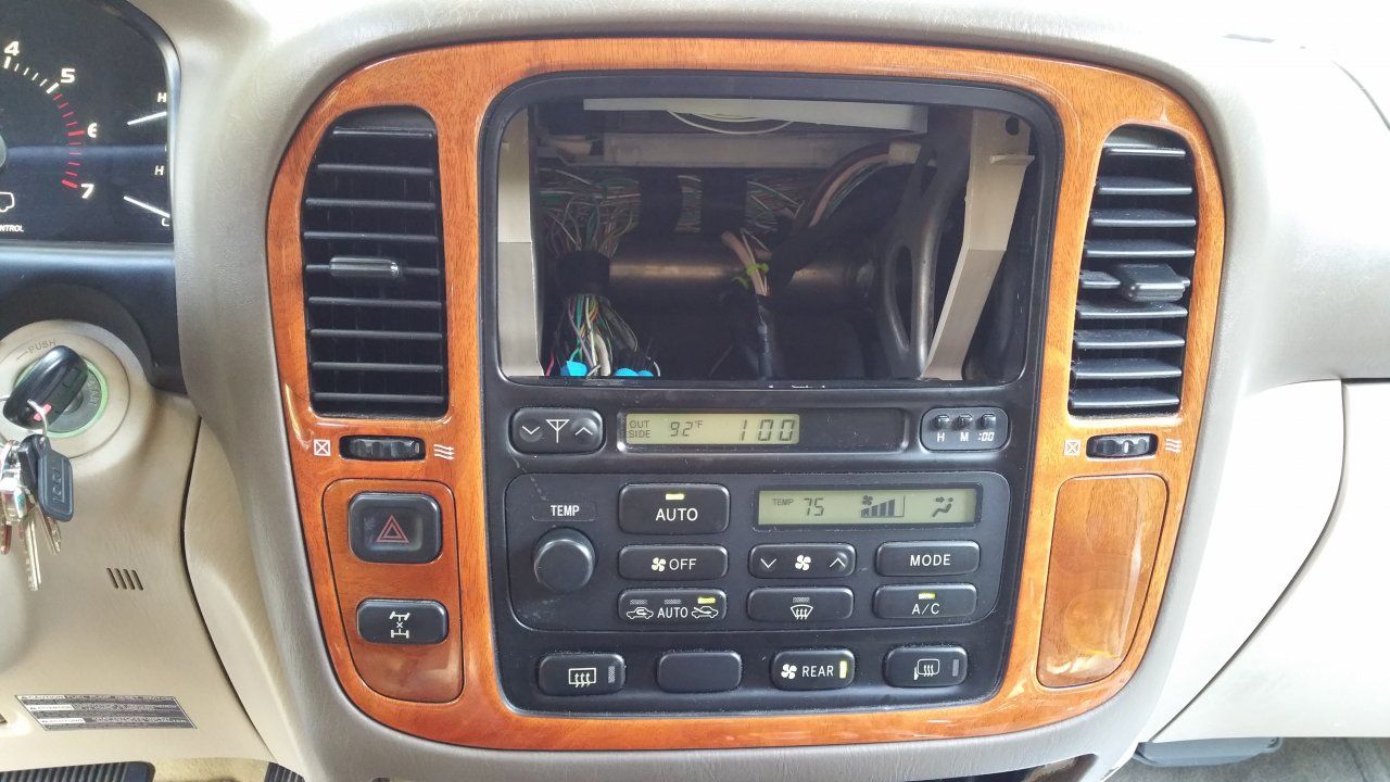

There it is. Fully functional air conditioning. I also tested the diff lock switch, hazard button, anti-theft blinker, seatbelt warning, clock, rear aircon. I have yet to test the rear defrost.

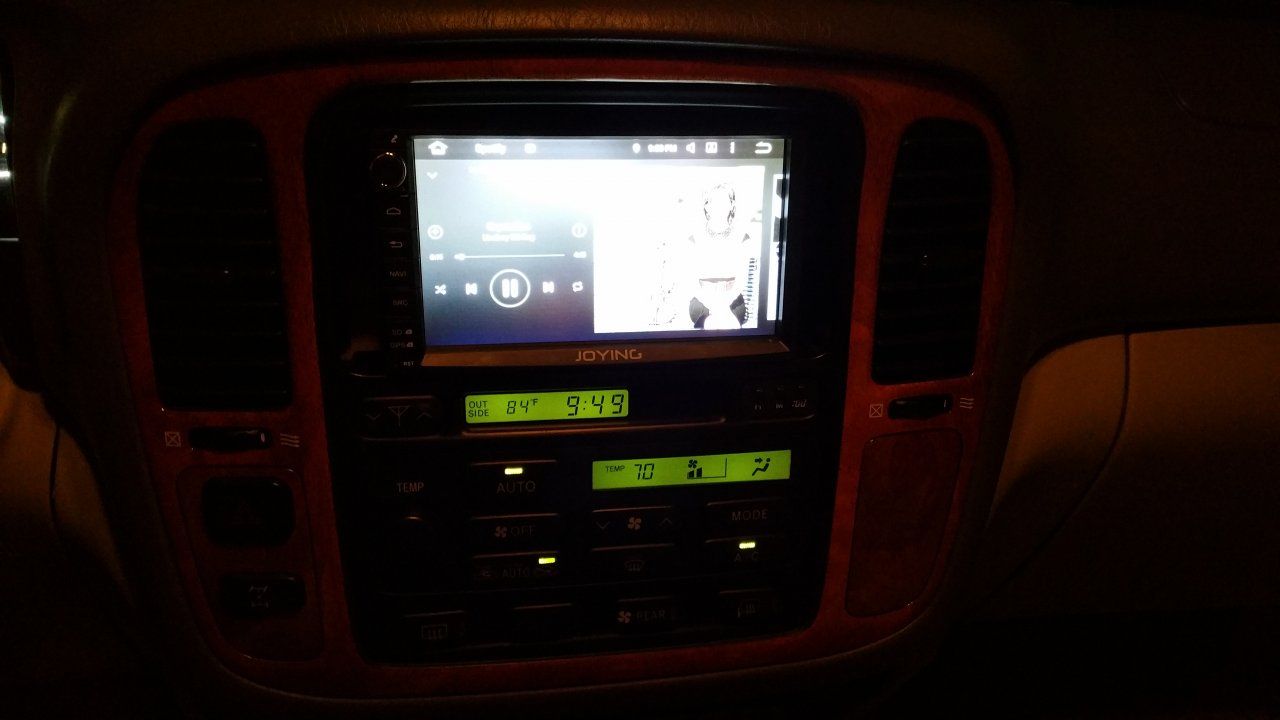

I'll take a better picture next time. Here's proof that the 70-8113 harness works (at least for my chassis). I got a quad-core Android 5.1 touchscreen headunit (~$250-260) from overseas, a mount kit with curved fascia trim piece and install brackets (~$50) on eBay. Tethered to my T-Mobile smartphone I was able to install apps via the Google Play store and I installed Spotify, Pandora, Waze, Torque Pro, and a couple of parking meter apps. Monday I'll tackle the actual sound with updated speakers and a tiny Class-D Kenwood amp, but I want to deep clean the carpet before anything else.
Ok, can I pick your brain (or anybody’s here) to clarify something?
I’ve read this entire thread and others. I was under the impression that for either an LC or LX 2001-2002, I would have to source the whole bezel and three-knob assembly, paying attention to the presence or absence of rear heat. For the LX I would be best off to order the LC non-nav double-DIN brackets rather than trim the existing ones.
But it seems that for only the LX you in fact do NOT need to swap to the three-knob bezel setup? In your photos you seem to have configured the LX with the splicing/Metra harness yet retained a functional digital hvac control setup. I just wanted to confirm that this is actually possible and if you needed a new non-nav bezel anyway or other parts to fit the screen of the double-DIN? Or did the double-DIN fit behind the existing nav bezel with/without modification?
I am not afraid to take the project on, but it would be good to know exactly what I am in for. I am looking at purchasing a 2001-2002 LC or LX.
