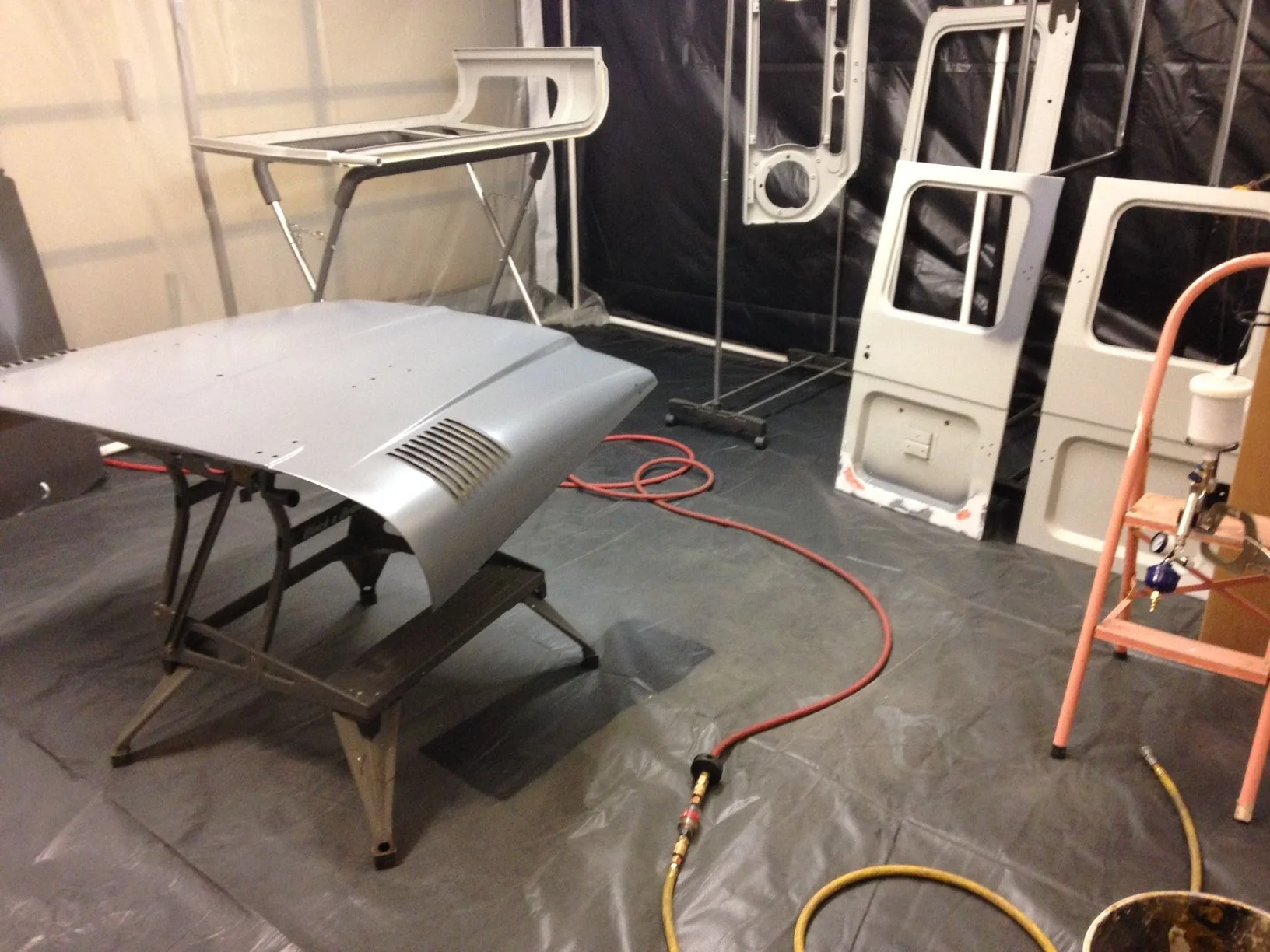

I have painted lots of stuff before, so it should turn out good, but there are tons of variables to deal with in a home brew booth...I just figured out how to build it and now am tweaking as I go...needed more air flow, so added a second 20" box fan, extra intake filters and outflow filters to keep the overspray contained. So far, so good, primer is coming along should be done in a few days...then more blocking and hopefully final color next week/weekend. :bounce:
