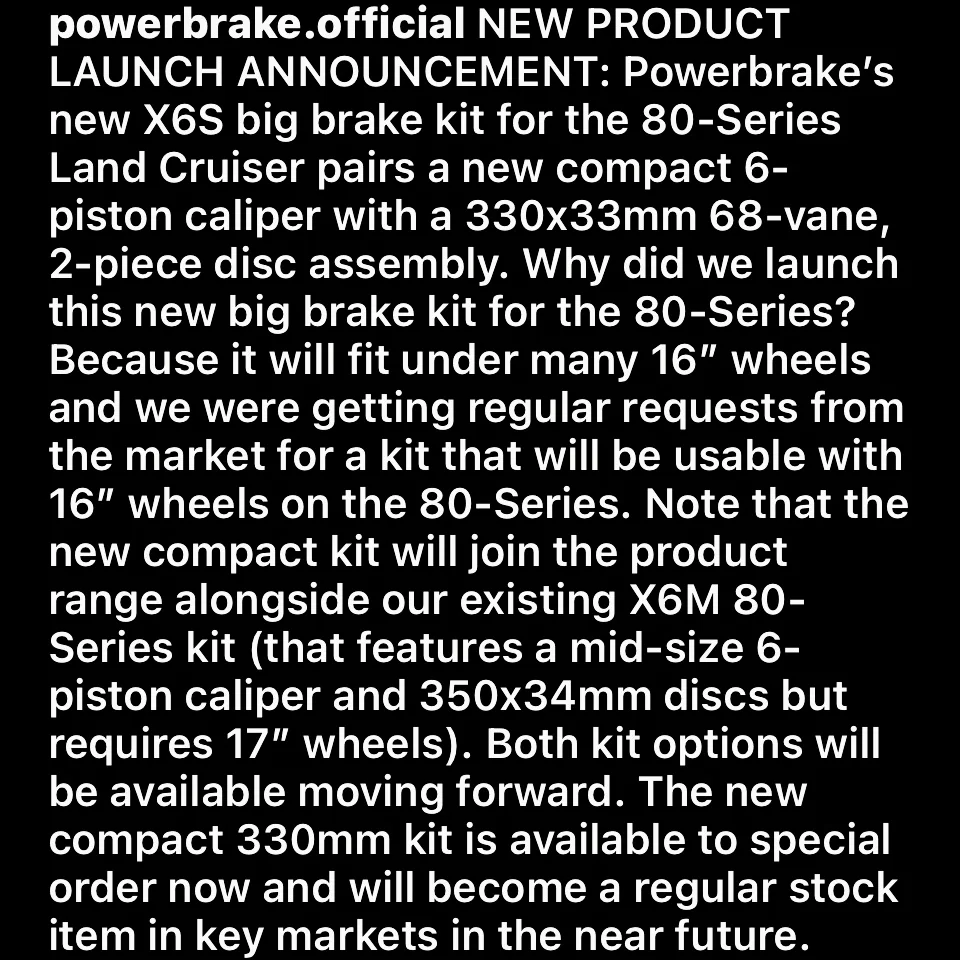

I got in touch with powerbrakes and they provided me a profile template you print out at 100% and check brake fitment/clearances for a particular wheel. They also make a slightly smaller kit for 16" (listed as 330x33mm) wheel and then the standard one for 17" (350x34mm) and up. I'm planning on one of the kits but sorting out wheels right now (and cost). Their 16" kit can fit oem wheels but requires and 5mm spacer and Powerbrakes said the spacer would be included. The templates might be on the website but the contact their simply emailed them to me. Delon was very helpful answering all my questions.
