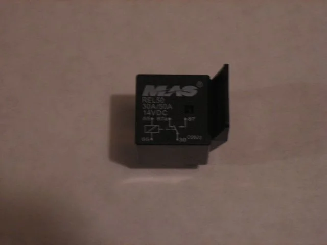

Single pole double throw (SPDT) relay: This is the type of relay we are using for this mod. It has a 30 Amp rating. I purchased all my relays from here (you will need two for the door locks and six for the windows):
[COLOR=#green]http://www.autotoys.com/x/product.php?productid=319http://www.autotoys.com/x/product.php?productid=319[/COLOR]
It
It came with a socket and wiring harness and looks like this:

It has five connections. Two are for the coil. The connections for the coil are labeled 85 and 86 and are the Brown and Blue wires respectively. The coil connections are not polarity sensitive. In other words, it doesn’t matter how you hook it up to the power supply. There is a common connection labeled 30 and is the Yellow wire. A Normally Closed (NC) contact labeled as 87a and is the Black wire, and a Normally Open (NO) contact labeled 87 which is the Red wire. If you are using a different relay, or if you are using a different harness, you will need to map your wire colors to mine. When voltage is applied to the coil, the relay changes state. This means the NC contact opens and the NO contact closes.
Here is the schematic for the relay:

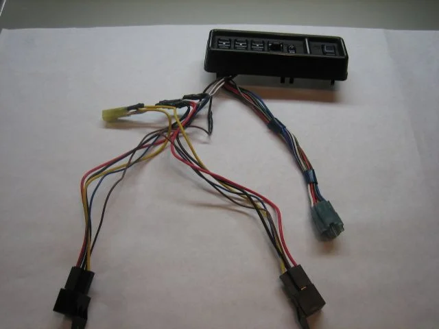

Here is what the finished product looks like, and a close up of the part where all the action is going to happen. I soldered all my connections, but you will probably want to use crimp on butt connecters and taps.
For those that have never been into this part of their Cruiser before, the small connector--white in my case--is for the power door locks. It has four wires coming out of it. This is the one we will be working with. The big connector--blue for me--is for the power windows. We aren't going to touch any of the power window wires. If you also do the power window mod, all that work will be done on the other three doors, not the drivers door. It already has relays for the window.
Power Door Locks Permanent Fix Part 4
You are going to cut two wires, the Black wire and the Black wire with the Yellow stripe (these wires map to the wiring loom Blue-White (L-W) and the Blue-Red (L-R), but you are going to cut the Black wire and the Black/Yellow wire). You can refer to the schematic for this. You are cutting the two wires where the X’s are right below the schematic switch. Cut these two wires (the Black one and the Black-Yellow stripe one) mid way between the connector and the switch. You will notice that mine is cut off real close to the connector. This is the fault of a Previous Owner (PO) who made their own modification which didn’t work. I threw away a big wiring mess, but I digress.
Now, take your two relay wiring harnesses and label one LOCK and the other UNLOCK. Using the method of your choice (solder or crimp connectors) make the following connections:
  • Connect the LOCK Yellow wire to the Black wire coming from the connector, and the UNLOCK Yellow wire to the Black wire with the Yellow stripe coming from the connector.
  • Connect the LOCK Brown wire to the Black wire coming from the switch, and the UNLOCK Brown wire to the Black-Yellow wire coming from the switch.
  • Both the UNLOCK and the LOCK Red wires tap into the White wire with the Blue stripe. You can remove some of the insulation and solder these wires, or use trailer style crimp on connections which is what I would recommend. I think the Blue ones are the correct size. (I soldered these because it was in the evening and I was too impatient to wait until the stores opened to go get some connectors.)
  • Now the Blue and the Black wires from both the LOCK and UNLOCK relays tap into the White wire with the Black stripe.
That’s it! Plug your relays into the sockets and install the mess back in your Cruiser. At least in my case, the door locks now sound like they are going to jump right out of the door! You will want to push the relays through a convenient hole in the door, and anchor them with tie wraps or something so they don’t rattle and they stay up out of any water that may get in the bottom of the door.
