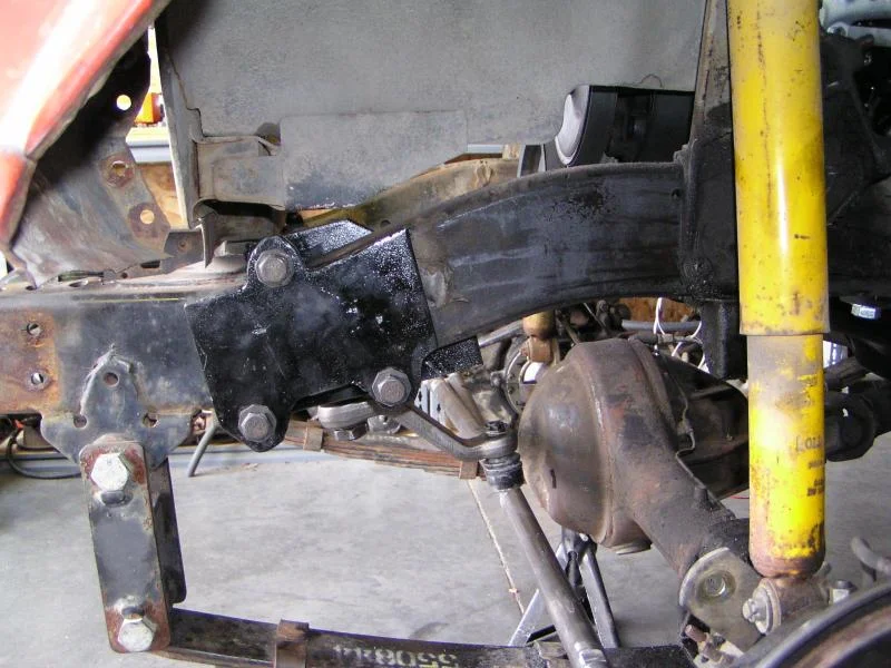

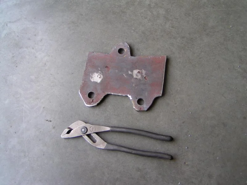

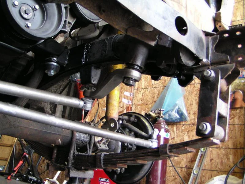

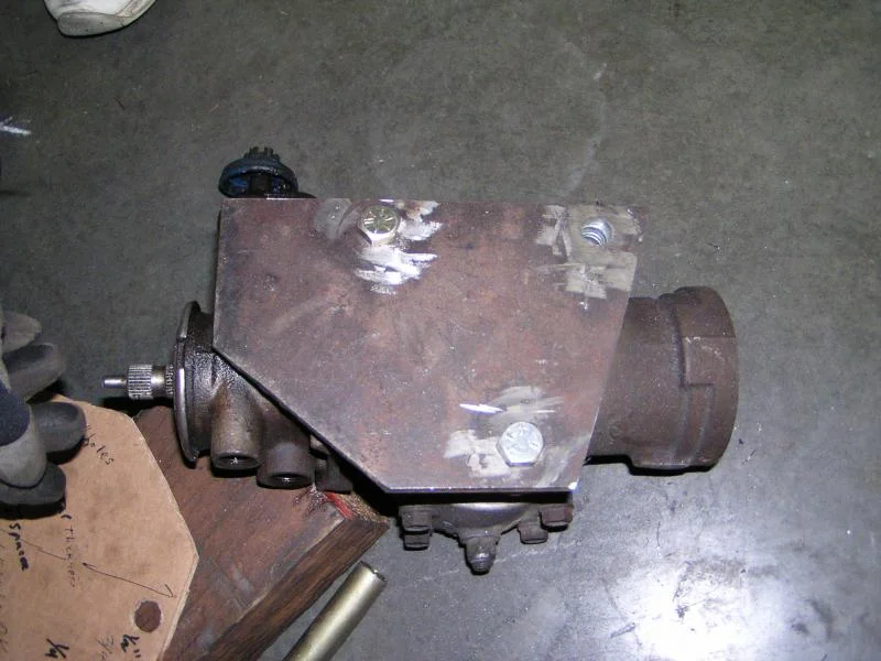

Okay, I will chime in on this one. IMHO, power steering is the single best thing you can do for your cruiser. On mine I installed a 93 350. I pulled the steering box and pump out of a donor 93 half ton. I made a custom bracket set to bolt the box to which sandwiches the frame. Parts used: BTB collapsible steering shaft, relay rod and tie rod. New ball joints. Used the pitman arm on the box I got. You need a couple u-joints which I got from BTB also but others carry them to connect the steering shaft on each end. I have no clearance issues with my ram horn exhaust. Was a fairly simple fabrication and I even have card board patterns of the bracket plates I made. I have done 6 fj40 steering conversions and this was just as easy. I did have to notch the cross member below the radiator to move the box as forward as I could without cutting the cross member much. I have pics at home if you want to see.

Mako's power steering pics
Here are the first 3
