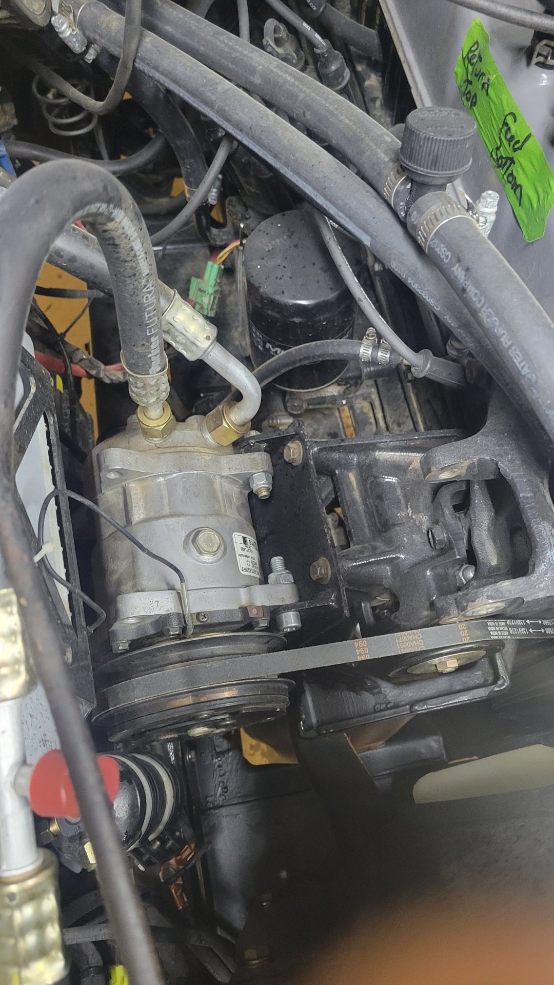

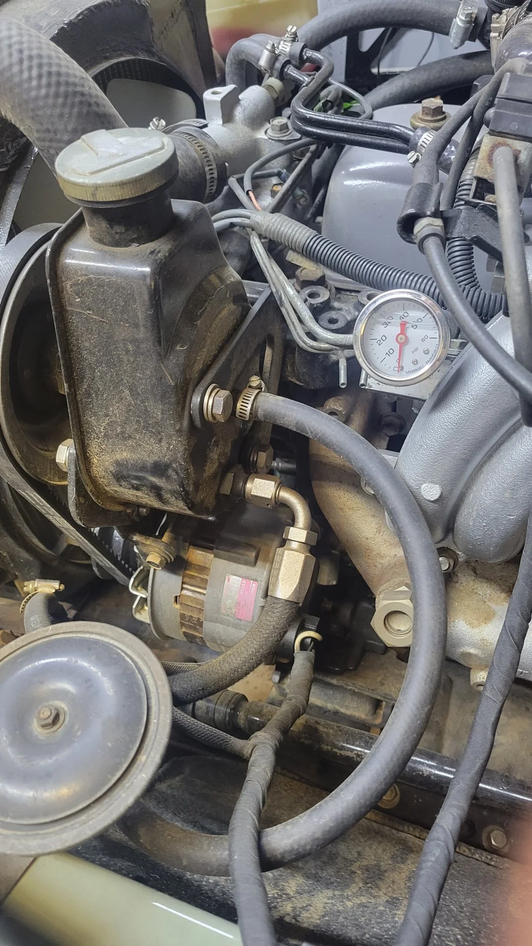

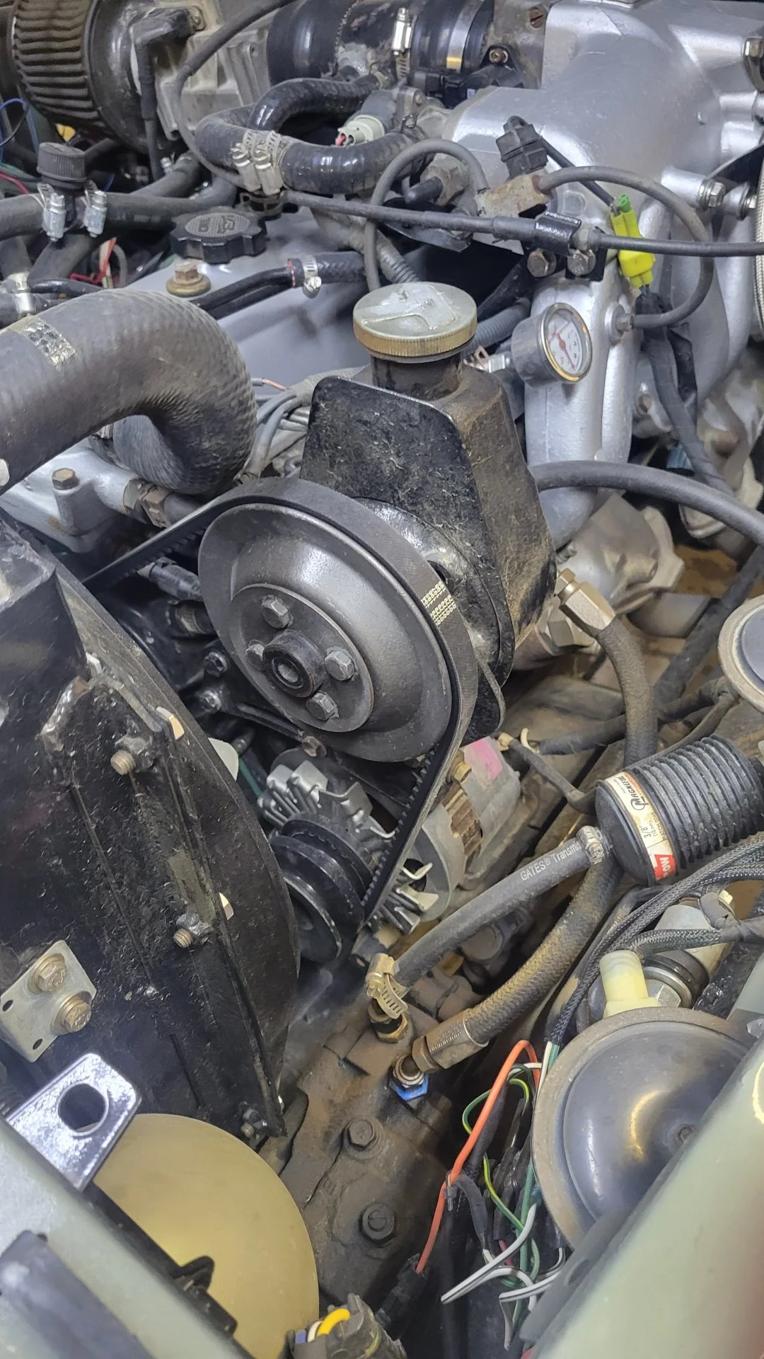

Saginaw pump on a 3fe for reference in case you were wondering if it could be done.
The stock radiator cooler. It’s perfect for a power steering cooler since the box and pump are on opposite sides of the engine, as are the cooler input/output. I also added a magnetic filter into the return line.
I like the way you're thinking. I should see if I still have fittings and hoses leftover to do that on mine. Would be nice to have that extra margin of safety for the pump and gearbox.
@tornadoalleycruiser Where did you get that bracket, or was it a homemade one-off? Looks like it's much more simple than one would assume, as long as the smog pump is removed. Is performance pretty equal to that of the OEM 62 pump?
It was a molested volvo 240 bracket I believe. Steers better than my fj62 did stock. I honestly just wanted the pump on the drivers side and am putting oba where the stock steering pump went. Gm ac compressor where the stock ac compressor went. Took about 10 min to fab. Finding belts was harder. Best sizing is not self explanatory. My truck is a hodge podge of stuff I had left from other builds
Very interesting work. If the Saginaw actually IS an improvement over the stock 62 pump, especially when combined with other upgrades (more solid linkage and 80 gearbox), that could be a solid way to a more "modern truck" degree of responsiveness in the steering.
