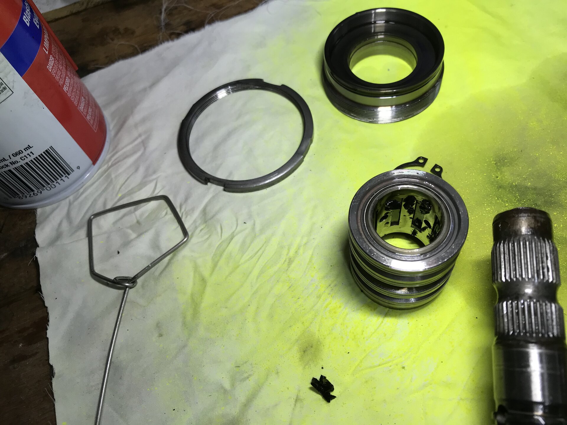

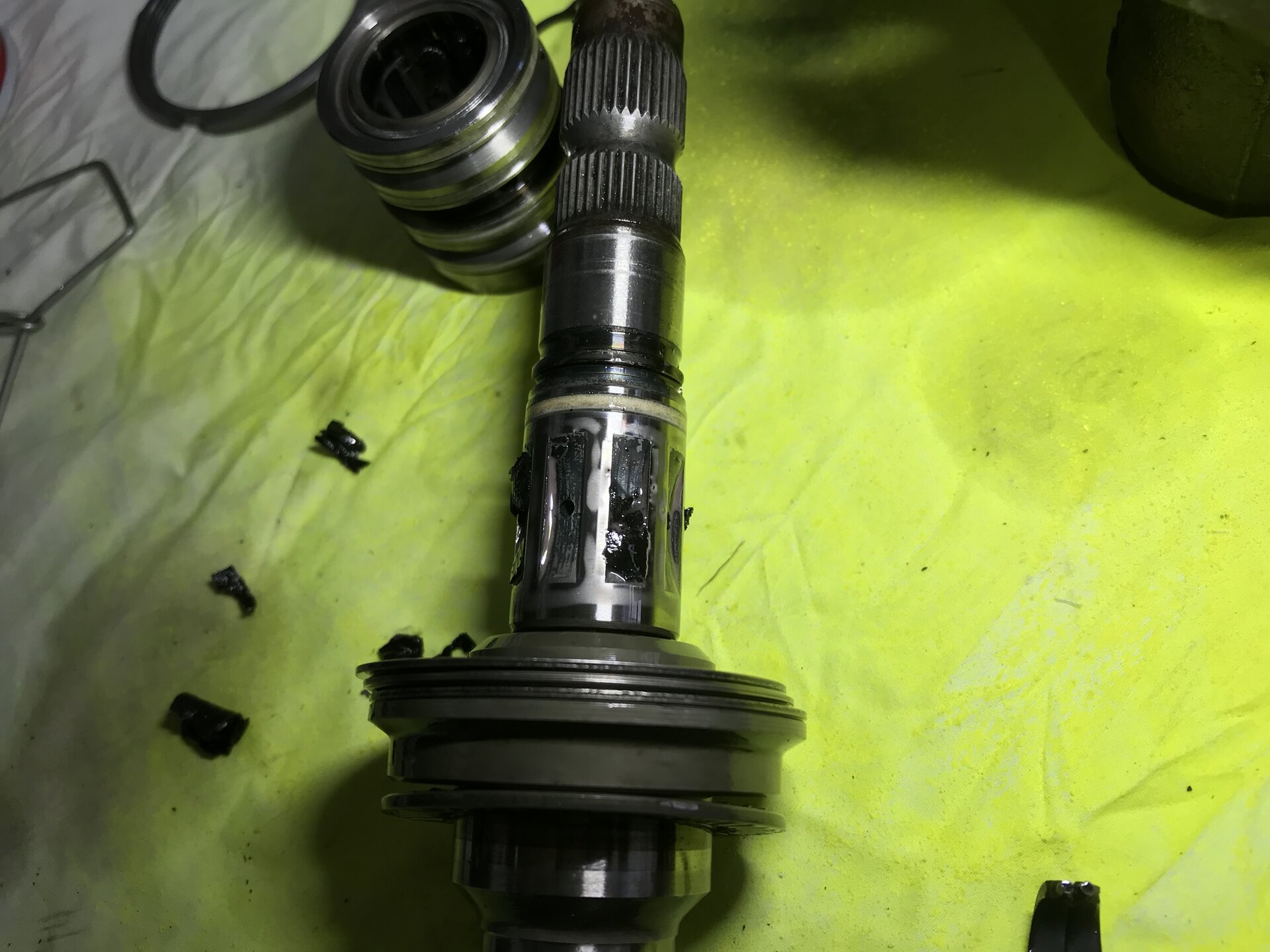

If you changed the high pressure line, maybe there was pieces of rubber in the line resulting from the crimping of the flexible line. These FODs made there way to the gear box and clogged the hydro passages. It happened to me twice! Your pump may be good but your problem is further down the line in your gear box. Here is a picture of what it looked on my truck. That being said, it is not costly if you do the job yourself, it’s 2 days of work and messy!

I’ve got a feeling this is the issue. Is there a walkthrough that you followed for cleaning out the gearbox?

Here is the thread I followed. The step by step and the according pictures are very well explained. This guy did a very good job. Pay extra attention when removing the power piston plunger guide nut. I had to remove it with a chisel and weld a bolt head afterward… naturally I had to file back by hand all the remaining threads. You will have to go one step further and remove the snap ring to check the input shaft. But it is not a big deal as you can see on the picture I sent you. Be sure to run compressed air in all the passages to clean everything. Reassembly is pretty straightforward if you follow the step by step. Finally when reinstalling the high pressure line, I found it easier to install first the end at the box before the end at the pump. Don’t rush the job, take your time to check every détails as you go along and it will be fine.
Feel to ask any question if something needs to be clarified.
Picture below is the salvaged plunger guide nut.
Cheers
