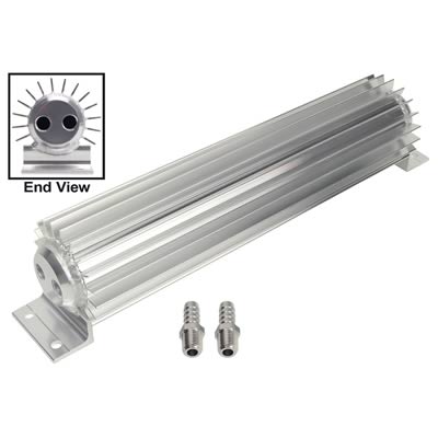

If I have any cooling issues I will likely go with my original plan and use this.

Oh....^^^^ I misunderstood. The cooler I might use only if I have heat soak with my current is the cooler you have. Looks good. Hoping I can just keep the bone yard one.

THELAL, I don't have too many pics. I didn't bother since a few others have already done this mod. I used Delare's PS cooler that I got from JEG's. I used the 15" version because of where I mounted it. It gave me enough room for the lines themselves. I used 3/8" power steering hose from Aeroquip. You can see more of the install here: https://forum.ih8mud.com/threads/wh...-80-this-weekend.586191/page-306#post-9225807
Here is the unit I used:http://derale.com/products/coolers/...opper-aluminum-transmission-cooler-kit-detail
To mount the unit I drilled and tapped for standard Toyota bolts to keep everything metric.
