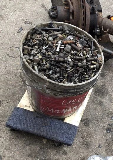

@ceylonfj40nut - time to start sorting the 5-gallon bucket of hardware you picked up from @cruiserjunktion :-).
Still have it. Did some re-arranging of the barn. Sorting will be a handful at a time. E.g. while waiting for a weld to cool down, a coat of paint to dry, while I instruct the elves do some work, have the elves sort a handful each time they are at the Elf Barn. 🤣
Man oh man! I’d give my left thingamagig for that bucket. Full not empty👍
