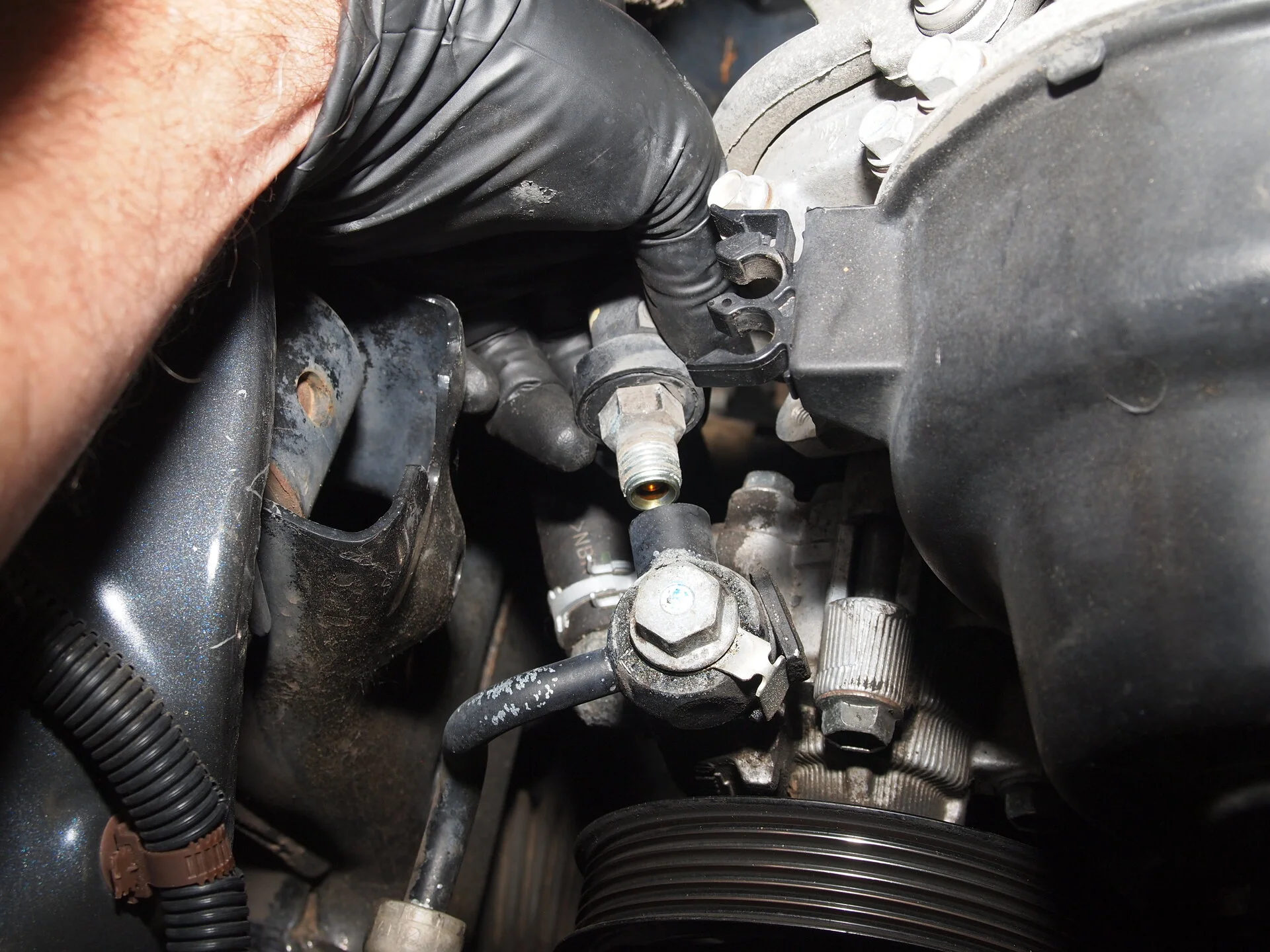

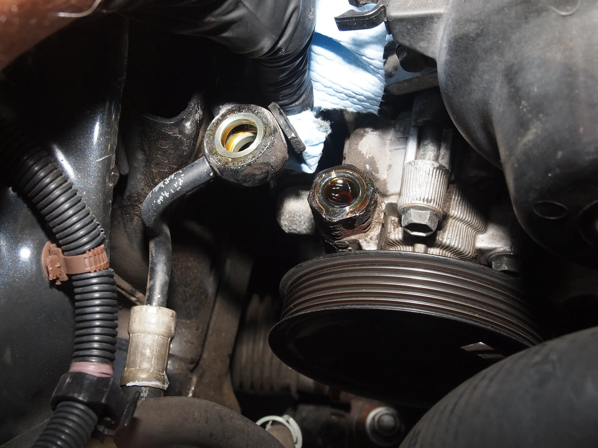

I have a 2001 100 series. I replaced power steering air control valve or switch (that gives air from the upper manifold to the power steering pump for help steering when parked) and it was driving fine. Then I started it up and heard my power steering whining. Looked in the reservoir and it was empty. Filled it up, and it started to smoke pretty quickly from the tail pipe. It isn't condensation as its thick white smoke. Went looking under the hood and PS fluid was empty again with no fluid leak present. Nothing in the engine compartment or on the ground. Car is running fine besides smoke and power steering issues. Temp and oil pressure are good. Not overheating at all. I am assuming it is that valve (read numerous threads of that valve failing and the LC smoking). My coolant was a little discolored and overflowing. Oil looked completely fine. So my questions are 1. Is the engine fine or do I need to flush the fluid or change the oil? Will the power steering fluid just burn off? 2. Can the valve be installed incorrectly or did it just fail? Any suggestions would help! Images of the part are attached

Your high pressure line and other hoses, do not look correct for a 100 series. Perhaps I'm looking at picture wrong.

Yeah I purchased an after market one. The pics I posted where just ones I could find off of the internet and think a couple pics where from a sequoia. Does it have to be installed a certain way? When I took the old one out the 2 outlet valves were parallel to the ground but read that it didn't matter (installed mine vertical)
Doesn’t matter.
No

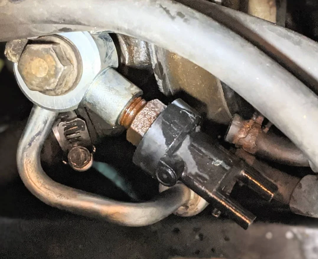

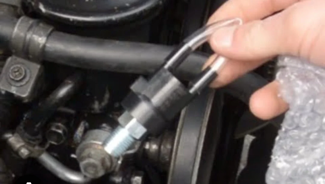

And now the air control valve on the power steering hose, as pictured in the threads photos is leaking oil? What can cause this?

If new OEM idle up control valve (IUCV) leaking at threads. Tighten IUCV a little more and or use some thread sealer, like Toyota FIPG 103 (oil).
If IUCV, leaking into vacuum lines. Replace IUCV with new OEM.
