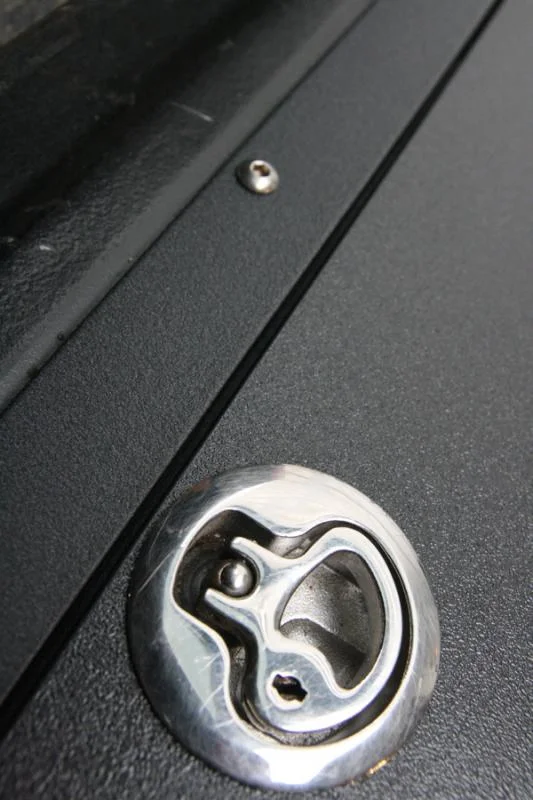

Ok, so some of you know that I've been trying to sort out a way to get all this stuff powder coated.
Thus far I have had a total of zero complaints on the spray coating that is on everything, it seems to be great stuff. But I want to do better.
I've tried a few places for PCing, but nothing has worked out, either they would not work with me on the small quantities of stuff I make, or wanted to charge a lot for each frame to make up for it, or would not run a texture coat...or any combination of those.
But I found a place that seems to be pretty good to work with, we did a test frame, it looks good and they think they will be able to run the frames for about $20ea.
I like it.
The only problem is that the place is a half hour away, but I don't want to have to paint anymore and I would like to offer the best coating I can get.
So some pictures:
So what are your thoughts?
The coating is a nice kind of wrinkle-coat, looks like what you would see on a piece of scientific equipment, they call it their radio case coating.
At $20 is seems like it is quite worth it, and since the spray coatings cost me about $5-7 think I would charge $15 and eat the ride in exchange for not having to paint anymore.
This would mean that all the prices go up $15.

I like it, too.
I love the textured powdercoat. I just might take mine apart to have it done!
Been working on putting together the first set of powder coated frames this weekend, they look nice.
I have to run my finger over the frames to tell the difference between the sprayed or coated frames that I have here. And the coating seems to be very durable, this should help move things along.

I have no complaints on the spray stuff (nor have I heard any) other than the fact that it is a pain in my but. The stuff is supper tough, in a lot of ways I like the feel and the look of it better than the powder coat, but the powder coat should be more consistent, improve the process and be a better product for all of you, so the switch needs to be made.

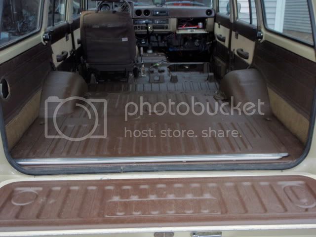

The only thing i keep worrying about on the install is when i had my rig linex'd i had them do the tailgate, exactly where the carpet was. (so pretty much to the outside line of the raised portion, if that makes sense) the linex is about 1/8" thick. Im weary about cutting into the tailgate if its going to effect the fitment of the tailgate holder.

Wow. I need to get to work on my truck, lol. That thing is gorgeous.
Derek, the extra 1/8" shouldn't be a problem.
Here's what you do, bolt in the frame you have and take it back to the coating place and have it coated to match. :cool:
Maybe remove the plastic first though, doubt it would stick to that.
On second thought, don't do that, I definitely won't take it back then. :p
