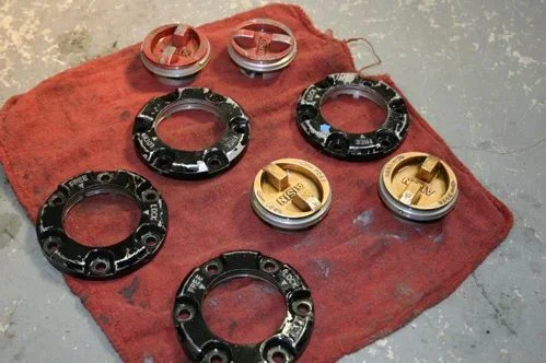

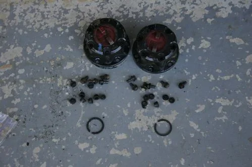

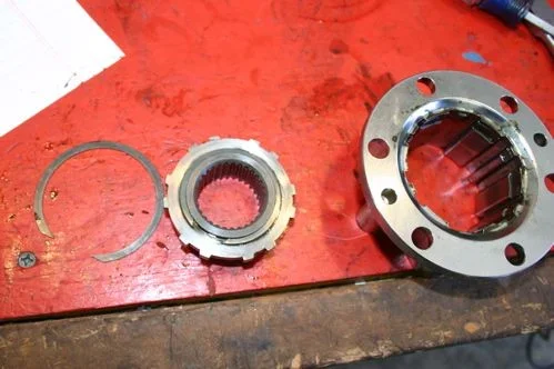

So someone simply bought a set of hubs and had them shipped straight to me. I was just going to do the faces, but nah--I'm too nice of a guy to let them go like that.

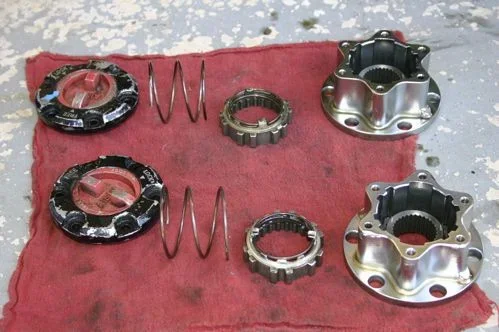

And here's what some light soaking and scrubbing in the solvent tank did...

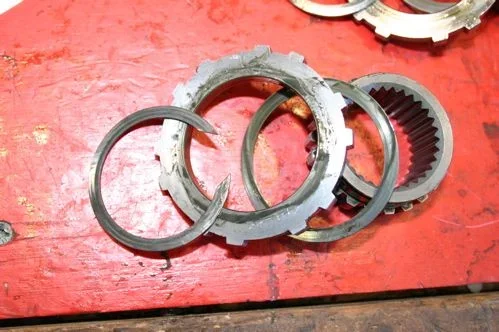

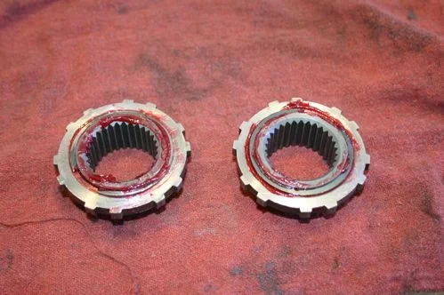

Here's the hub faces coming apart...

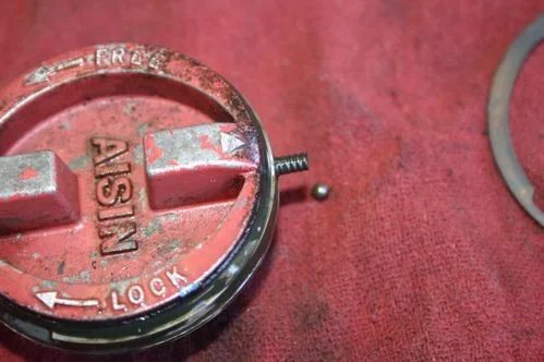

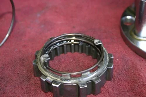

Here's the little ball that you don't want to lose. When you separate the dial from the ring the ball often falls out, flies out due to the spring, or gets caught in the grease and then lost in the solvent tank. But here's where it is...
And here's the follower pawl installed correctly. More pictures of this can never hurt. :)

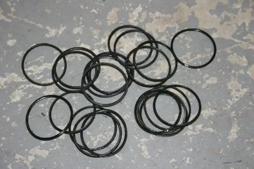

Here's the old O-rings removed from the ones I've done so far (and why I have to keep ordering more O-rings)

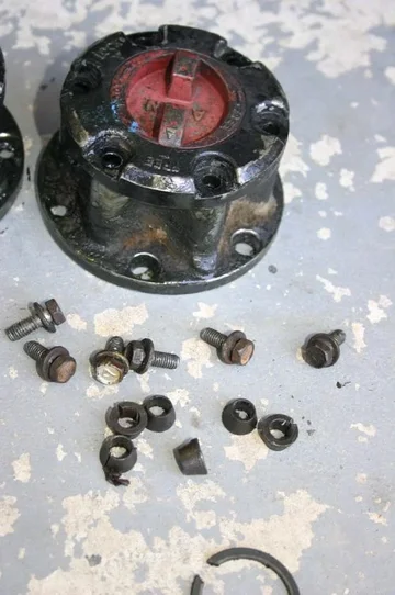

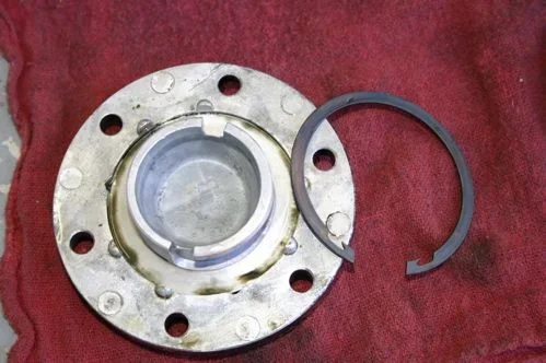

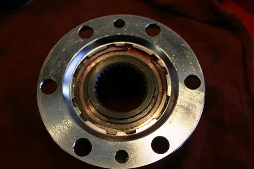

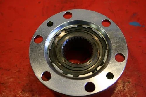

And the back of the hub itself.

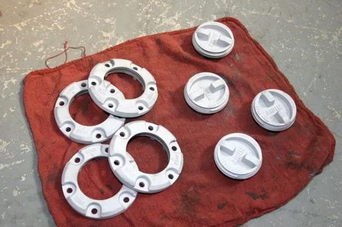

After cleaning all the parts thouroughly, they got greased and reassembled.
At the same time the dials and rings were getting powder coated.

Professional? Not yet, just doing what I can. Once Gene's 35LV is up and running then I'll probably just keep doing these, but making the money to fund my 45 project (and general career backup plan :) ) But hey, I just submitted to the company my request to take the "time off without pay" they are offering us instead of furloughing, so I might just get to have "Land Cruiser Party 2008!!!" in July. :)
FWIW, I just picked up 20 more O-rings, so as soon as I'm done with dinner I'll be back up in the shop. Hopefully get at least two more ready to ship tomorrow.

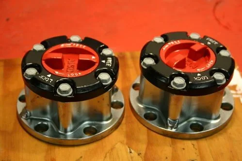

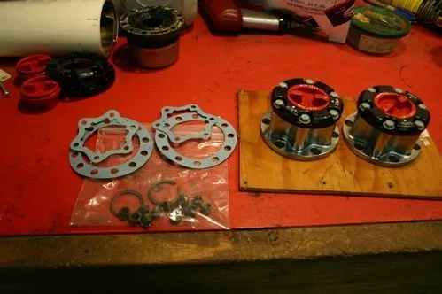

So here's what's in the box you'll be getting...
And here's what they look like close up. I don't have any more plated bolts, so I had to settle with cleaning these up and shooting them with a light coat of Zinc-It. Nothing fancy, basically just a coat of primer on the bolt heads.
