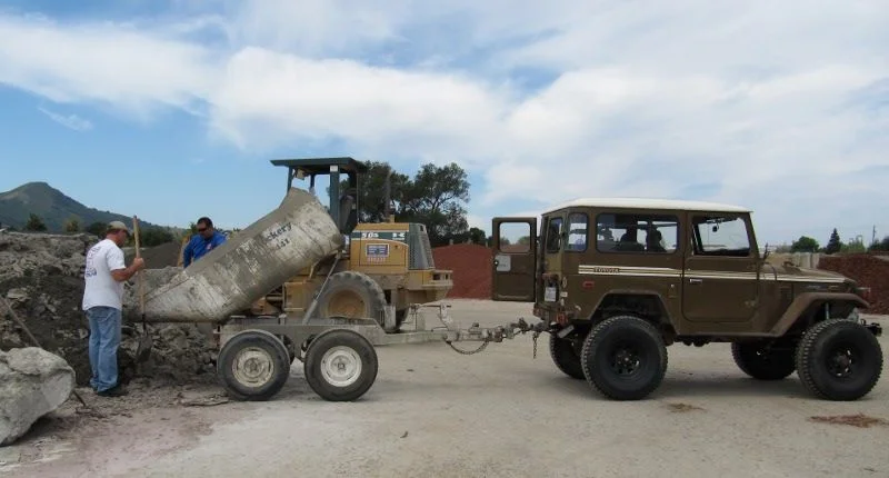

Here's a pic of my rig before the plates:
marvin_3223-jpg.633014
I'm also interested to know that you have some lip left at the top to drill the holes for the fender protection pieces. On my rig there wasn't much there, maybe only 3/4", but it was enough.
