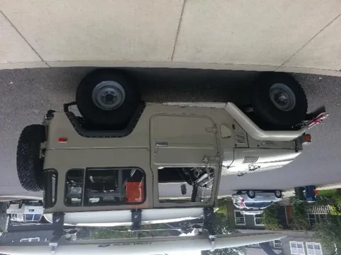

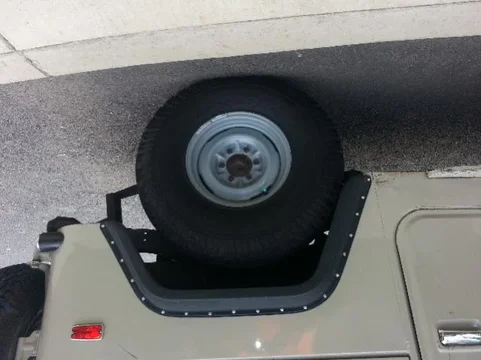

Here are pics' I linked them rather than put them in the thread as they are on the large side.
(yes the diamond plate is going to be removed).
I'm likely going to patch the stock fuel filler, and hopefully use the recess bit to re-construct the rear filler. This along with the installation of a new 21gal rear fuel tank. After the tank is in I may also look at moving the rear axle back a touch as well, don't want to do that until the tank is in though so I can check clearances
My fenders are horribly hogged out, the top and front edge follows the line of the inner fender well. Which brings out the question, where are the holes in "fender fixer" located? Are they inside the tub or outside? Specifically the top three, and the ones forward which will be the main sticking points.
I am also considering trimming the rocker panels some, which could also affect my option with regard to placement.
Any chance I could get you to trace one of the plates on some paper, fold it up and mail it to me? That would be a sure-fire method for checking fitment.
http://i491.photobucket.com/albums/rr271/diskord_/landcruiser/working/IMAG0328_zps68667896.jpg
http://i491.photobucket.com/albums/rr271/diskord_/landcruiser/working/IMAG0327_zps855a55a0.jpg
If you guys don't mind, can you post up at least one picture of where you're going to install them?
Standard fender flares on mine but you can't tell that one side doesn't match the other both in terms of how far forward they are or the overall shape. Plus, I flipped my rear springs so the axle is ~3.5-4 inches back compared to this picture, so I really need the opening to move back a few inches.

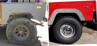

Fender pasted on as designed:
Slightly shortened (note two bolts closer together, would be fixed):
As designed, but moved forward (forward bolt hole would not work exactly in this location because of what's behind the sheet metal where the panels meet):
I like the last one the best, if we can make the mounting holes work. I fear the forward holes above the first one would be inside the tub.

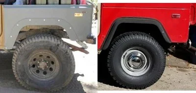

Tried to match up a photo from your original thread, and a pic of mine...original position, and moved to work.
I still think they will work for me, granted not as originally intended, but my only other options would be to replace the quarter panels, or leave it as is.
http://i491.photobucket.com/albums/rr271/diskord_/original_zpsaa318007.jpg
http://i491.photobucket.com/albums/rr271/diskord_/moved_zpsd3a3ad88.jpg
