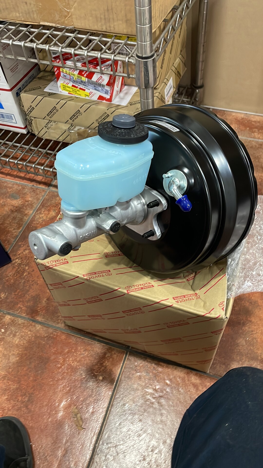

80 series booster is available and a upgrade. They are not cheap though. We’ve sold and installed a few locally recently
The City Racer booster works fine as well. Have installed +15 of them without issue
