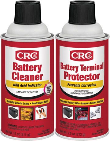

Baking soda and water?
Once clean, all ya need is a quick spray of the "Protector" a few times a year. You'll never see corrosion or deposits again. And then you'll only use the "Cleaner" on your friends and neighbor's who neglect theirs.

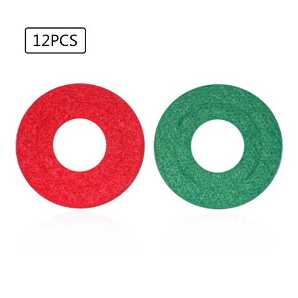

I’d buy a new terminal and apply a thin coating of grease... end of problems for the life of the battery.
Or...
