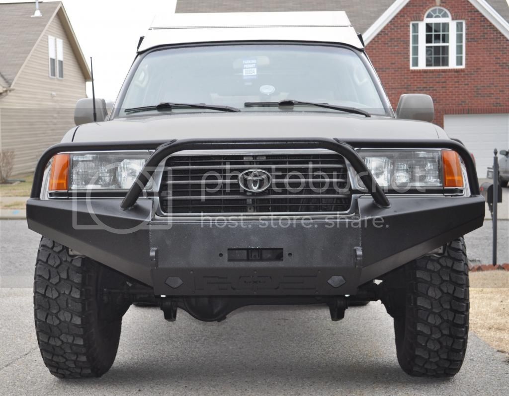

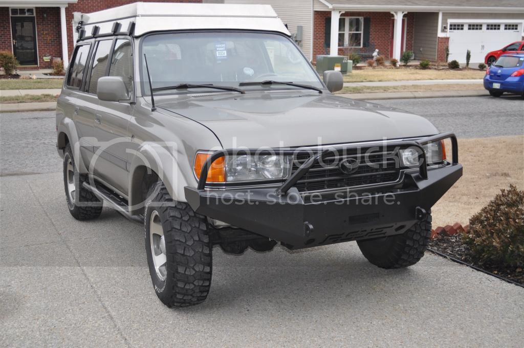

AOE Front Bumper
I've been waiting for a sunny day to take pictures of a couple of updates, but I'm not sure that's going to happen anytime soon so excuse the dark shots.
Just before Christmas I ordered an AOE front bumper. I really love the classic look of the ARB bumpers and had every intention of putting one on this truck, but after reading a few accounts of weak spots I decided to go a different direction. I don't plan to beat this truck up, but I'm a fan of going HD wherever possible.
AOE puts out a very, very fine product. I ordered the bare steel version then added a few coats of primer and rustoleum automotive grade black. I tend to go this route with bumpers and sliders vs. powder coating due to ease of touch up. I need to pull it back off to relocate the turn signals and mount a winch, but I couldn't stand to let it sit in the garage for long. I will say one of the most surprising things about this bumper is that you can't see it from the driver seat. I don't love the logo cut out in the front, but beyond that I'm very pleased with this bumper.

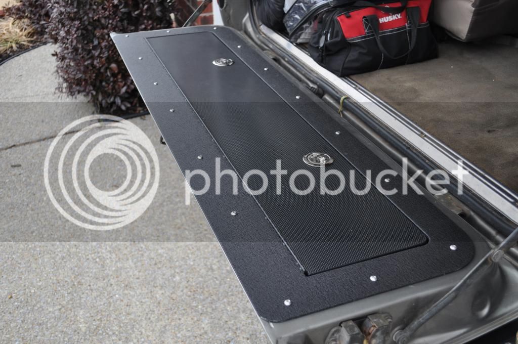

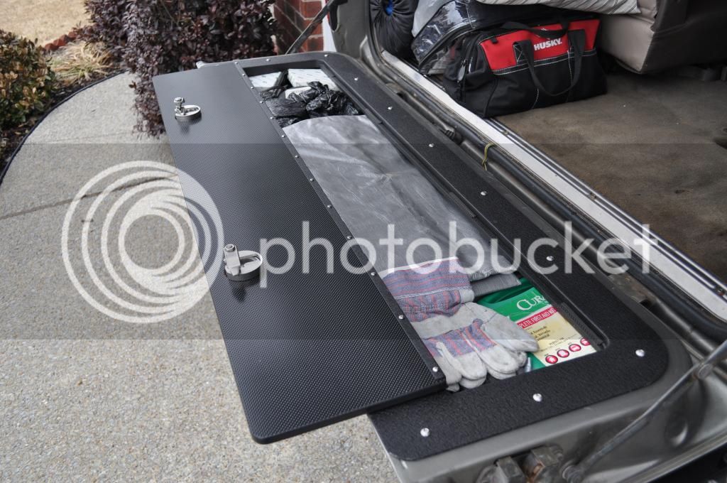

Wagon Gear Tailgate Lid
I also recently installed a Wagon Gear tailgate lid. Talk about a well thought-out, high quality product. I smile every time I look at it.

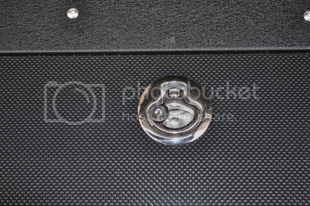

I added stainless latches, locks, and the grippy lid surface. I stand on my tailgate all the time so seemed to be a good choice. I used a grinder/cut off wheel to remove the factory section then laid out 8 s.f. of Dynamat to help with noise and make it easier to see. I have one tote that I use to carry a number of items that I hardly ever use but never go camping without (tarp, wheel chocks, straps, first aid kit, wag bags, etc...). I was able to fit the entire contents into the tailgate - I love finding unused storage space. :D
Pic below is from a quick camping trip over Christmas - you can see one of the storage totes I was able to ditch after installing the Wagon Gear lid.
